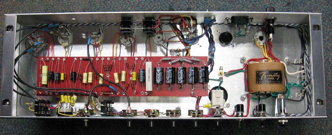

I'm building a Trinity TC15 head - a two channel 15 watt Vox-derived amp.
I've seen multiple variants of a reverb circuit derived from the Fender Princeton floating around the internet. They all bear a family resemblance but differ in the details. There are some old threads on the Trinity forum and a schematic posted by user kurtlives, but the forum seems pretty quiet now and kurtlives apparently doesn't frequent the board any more.
There's another variant posted here in an archive thread by Tubenit http://el34world.com/Forum/index.php?topic=7957.0
They're pretty close, but I like some of the details on Tubenit's version better, especially the variable dwell control.
Some of my musings and questions:
On the TC15 schematic I've indicated where kurtlives took the signal to the reverb and send it back. It's between the top boost channel tone stack and the phase inverter. It's very near where Trinity's designer says you can put an effects loop, except that the reverb version puts the whole reverb circuit in parallel with a 100k resistor. Tubenit's example seems to show the reverb in-out located between the second and third preamp valves. Not sure what the advantages/disadvantages would be of these two options.
I'm foolishly determined to put the reverb and dwell controls on a concentric dual pot. There isn't a lot of extra space on the panel - though I could put the reverb and dwell on complete opposite ends of the panel if I really had to. Nobody makes the 1M/1M concentric pot this would require. My idea was to use a 500k/500k with resistors in series. Check me if I'm wrong - if I put a 500k resistor in series with the 500k reverb pot, I'd still get the "no reverb" side of the spectrum but not the "max reverb" setting? Everyone says that this circuit generates a lot of reverb and I'm probably OK with it not going all the way to max. I'd probably wind up experimenting with resistor values on the dwell side of the pot. It seems like people use values between 500k and 1M when the dwell is fixed so my sense is this should work. Would appreciate correction if my assumptions are wrong here.
I ordered an accutronics tank for this project. To make it work with my head configuration I needed it to mount under the top of the cabinet (open side up) and my only choices were accutronics, or paying a kabillion $ for shipping to get a Tube Amp Doctor tank from Germany.
I'm attaching the schematics below and would appreciate any feedback or suggestions.

If you want the reverb for both channels (12AX7 and EF86) connect  the channels together with 220K resistors before the PI (not in PI)
and add the reverb after that point. Also connect the other grid of the PI with a 100nF capacitor to ground.

IF I were attempting to add reverb to this schematic, I'd probably try something like this knowing it might need to be tweaked.  I'd put a dwell pot on the back of the chassis since I almost never adjust the dwell ……….. or use a 1M dwell resistor.  You can try a 500p or 680p instead of the .001 dwell cap if you prefer.
I'd get rid of the crossline master volume which is the worst sounding master volume I've ever heard, IMO  (buzzy sounding) & instead use a PPIMV with a dual gang 250k pot.
You will have to figure out what B+ node to use for the reverb.  I can't help you with that.
I'd have a passive effects loop after the reverb.    PLEASE keep in mind this "one tube reverb" is subtle & it is no where near "surf music reverb". It adds a measure of fullness to the tone.
As as Leevi said, I'd change the C8 cap from .01 to .1.

This sounds great but I'm having a hard time visualizing it from words.
Any chance you could sketch this?

I like these mods and I understand them on the schematic level.
Now I'm struggling to figure out how to translate that into a layout I can actually build.
There are some extra pieces now that don't have places on the turret board.
My first idea was to put the 220k resistor on the EF86 channel's volume pot then connect a lead from there to the 150k which I'll put on the turret board where the original schematic had the 220k resistor
Then the other 150k resistor on the 12AX7's treble pot, connect a lead from there to the same 150k on the turret board
Scratch all that. I'm going to need to draw it up, then post it here for feedback.

OK, you guys have me already planning my next amp - and not from a kit. Something along the lines of the famous Sluckey vintage AC - Some of the AC30 bells and whistles but I don't need more than 15 watts.
For this TC15, I've already got the turret board from Trinity. I was planning to make a small "accessory" turret board off to the side for the reverb circuit; I think there's a good spot for this.
Since most of the new stuff is either right before or right after the reverb, my idea was to see if I can incorporate the changed stuff into the reverb board.
I've got some time tonight and tomorrow. I'll try to come up with a modified layout and run it by the panel of experts here.

A few slightly less pessimistic observations -
It's a one-tube reverb circuit (two halves of a 12ax7), and in the head configuration, there's an extra spot for a tube socket that isn't used. In your pic, they've got a plug in that hole second from the right - so no problem making room for the extra tube socket and it should fit right in to the heater wire daisy chain.
There's room between the two transformers on the top of the chassis for one more - it's a bit tight, but it does work out being at right angles to the others. People have put reverb transformers and chokes in this spot and gotten away with it over on the Trinity forum.
The extra turret board doesn't have tons of stuff on it, all the components are small, so (maybe?) it will fit at a right angle just to the right of the main turret board in your pic.
There's some room to move the main turret board over 1.5~ish inches if I had to
In your pic there's a big white box that I think is a push-pull on/off to bypass the MV. I'm not using that pot/switch, so there will be a touch more space in that spot.
But overall, yes, I do think this is going to be tricky to make it all work and make it all fit - not to mention concerns about draping signal wires over heater wires or whatever other layout problems I might encounter.
My idea at this point is to try to figure out what the layout would be and see what will fit and what won't.
If it looks like it's going to be a mess, I will eliminate some or all of these mods and save them for my next build.

Re, space and complexity:
It's really tempting to leave the master volume off of this build completely.
1) the power switch will be replaced with trinity's "VRM" - a voltage-based attenuator
2) I am already anticipating running this amp with an external speaker motor type attenuator
3) Removing the MV would open up a perfect spot to put the reverb pot - and it's in the right area of the layout
If I do use a MV it'll be the PPIMV suggested above.
But now I'm tempted to drop it entirely.
Again I'll work on the layout and see what might or might not fit

After seeing the chassis layout,  I personally would NOT add a one tube reverb.
What I would add is the Zero Loss FX loop kit from Metropolous:
https://store.metropoulos.net/products/zero-loss-fx-loop-kit
And then with that active FX loop, I'd use delay and/or reverb pedals.
with respect, Tubenit

Is this based on space considerations?
Or is it a concern about how the components might interfere with each other and make noise?
The metropoulos circuit would fit perfectly to the upper left of the rear panel...
Having ordered the components (!) I am tempted to continue working on the one tube reverb mod and see if the problems clean up or get worse as I go.
Does the idea of eliminating the MV modify your opinion?
PS did you also see my reply above, regarding there is already an empty tube socket hole in the chassis?

1)  I would be concerned about the layout (& space)
2)  Because of the layout, I would be very concerned about noise & "interference" as you mentioned
3)  Yes, I was aware of space for another 9 pin tube
4)  I have a some moderate preference for delay over reverb.  The active FX would work well with both pedals.
5)  The Metro FX loop is reported to be noise free and preserve original tone which you expressed as a concern to me in a private PM
6)  There is space for the Metro FX loop and it would be located in a good position in the layout, IMO
7)  No, the MV elimination is not a factor in my thinking
It is your amp and you should approach it in the way that you want to.  When I first starting posting the "one tube reverb" schematic on some different forums,  …………. I was readily shot down that it absolutely would not work.  (even though it was already working on numerous amps I had done).
So just because I don't think shoehorning the one tube reverb in your chassis is the best idea,  it doesn't mean my guess on this is correct & perhaps you will install it and it will sound stellar.   On the flip side,  I have also had more experienced builders point out a concern that I wanted to ignore and then had to back track.
The key to me with "experiments" like this is IF you are patient, persistent and will stick with it  & work carefully and be willing to consider an experiment that didn't work a success in informing you what does and doesn't work.  I've tried to maintain that mindset in my builds.  To date, I've never cloned any production amp & I've probably tried over 2 dozen amp designs/prototypes. So, I consider a lot of my success in finding the tone I like to be from trial and error.
With respect and good will,  Tubenit

I made an attempt at a combined layout which I've attached.
Thoughts about the layout:
1) I'm new to all this, and modifying circuits adds a level of complexity - seeing how complex this was just to draw up, I'm a bit intimidated to actually try and do this.
2) Unless I'm just missing problems through inexperience, I'm guardedly optimistic about the amount of space available. A lot of the things I need are in the right places or nearby. Some of the connections on my layout are long, but that's mostly because the reverb board is off to the side. With the reverb board where I'd intend to put it, right next to the output transformer, all the things I need would be very close to one another
3) I made a bit of a mess by running all the grounds separately to the power ground star. If I were to do this, I'd be tempted to put a mini ground bus on the mini circuit board, and just send one wire from there to the power ground star.
The only "do it or don't do it" decision I'll have to make soon is whether I put a socket in the empty spot and include it in my heater wiring scheme.
My sense is that it would be harder to add it later than take it out later, so I'm tempted to go ahead and put it in for now.
One other thing that might or might not help: I was planning to make my own "mini" board, and given the small size of the components, I think I could make it pretty small.
« Last Edit: November 02, 2018, 10:10:00 pm by alathIN »

Sorry. It was not my intention to sound pessimistic. Did not realize you were headed to the one tube reverb circuit. That empty tube hole is a very noisy place to put a sensitive reverb tube.
Sometimes the combination of experience and wisdom can produce results that are nearly indistinguishable from pessimism ;-)
I suppose I could move the power tubes over one slot and put the reverb tube on the other side of them (ie, put a different tube in the noisy spot?)
I do have the kind of tube sockets that have a metal shield that goes over the tube - does that help?

I would steal the tube and pot line-up from some known-good reverb amp. i.e. split between preamps and driver, slide driver/outputs over, and put reverb tube and pot in the middle.
This is quite a complicated build. Have you done something on this scale before? After dinking with silly-state for a decade, I build an AA Champ, and was astonished how much work it was. (Compounded by being more experimental than routine.)
This is orders of magnitude more complex than any of my previous projects.
I chose a kit instead of a scracth build to save myself hassle.
Then go hunting for ways to add hassle.
