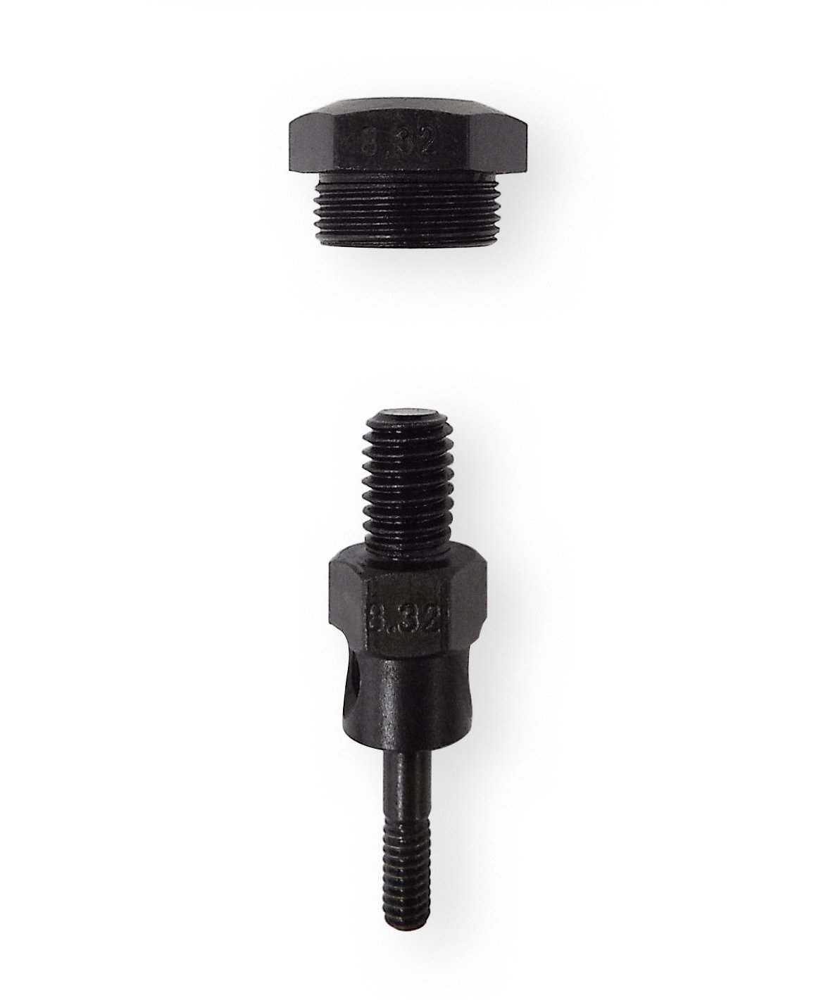

Have any of you guys seen one that will do 8-32, 10-32, and 1/4-20?
I used this search phrase on amazon
Mandrel and Nose Piece
These mandrels say they fit the Astro 1442 model and that model looks the same as mine
Here's a 10/32
https://www.amazon.com/Astro-Pneumatic-Tool-1442-10-32A/dp/B01F9A4PFG/
I found a 8/32 here
https://www.amazon.com/Astro-Pneumatic-Tool-1442-8-32A/dp/B01F9A4PJM/ref=sr_1_5
8/32 comes in handy for lots of small stuff
« Last Edit: March 25, 2019, 10:04:12 am by EL34 »

I just got a reply back on Amazon asking about the Mandrels for the 1442 tool
They are the same as the ones I got with my Ebay tool
I got 9 Mandrels with mine, but I still need a 8/32 mandrel
They are $15, which is almost double some of the other larger Mandrels
Seems weird when you can get a 1/4-20 for $6

« Reply #24 on: March 26, 2019, 06:38:00 am »
Not sure that one will work
I would have to ask the seller if it is M8 threads on the end that screws into the tool
For $4 more, I think I would just get the one that I know is correct
here's the one I know fits mine

Oh yeah, that one is different. I didn't notice that. I would get the other one too.

I wonder if you could take one of those metric mandrels to your machine shop buddy and get some 8-32 threads put on it?
  • Posts: 10672
Re: Rivnut setting tool
« Reply #27 on: March 26, 2019, 10:51:05 am »
I have taps and dies
I probably could re thread one myself
I could buy one of the $6 tools and see how it goes
But they are hardened steel and it may be pretty tough to work with that metal?
  • Posts: 5391
« Reply #28 on: March 26, 2019, 11:05:28 am »
That's why I suggested a machine shop buddy.
  • Posts: 10672
« Reply #29 on: March 26, 2019, 11:12:36 am »
I don't have a machine shop buddy :)
The labor for something like that would be more than the Amazon tool
I bet those tools are made first and then hardened
I could take a regular M8 bolt and turn it down on my lathe
Then do 8/32 threads on the other end
just as an experiment

I just got this 8/32 tool from Amazon
It fits my Ebay rivnut tool
It's listed as fitting this tool
Astro Pneumatic Tool 1442
It's $9.74 right now, which is way cheaper than the $15 ones I found before
https://www.amazon.com/gp/product/B01F9A4PJM/ref=ppx_yo_dt_b_asin_title_o01_s00
