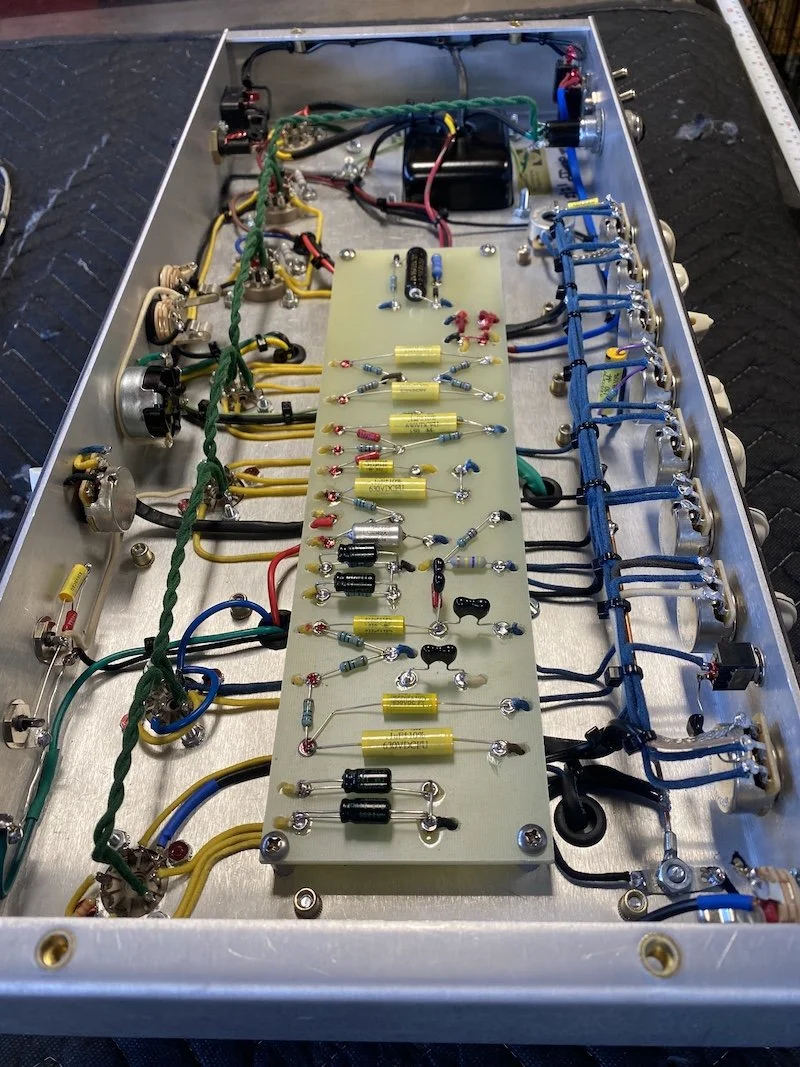

I recently acquired what I believe is a 1962 JMI Vox AC10 Twin.  I am attaching a link to a gallery of images and videos I have taken.... I found a couple of schematics online but there isn't a whole lot out there on this one. Anyone have one? Or have experience with one?  I replaced the e caps as the originals were leaky and suspect and rigged a temp fuse, powered it up on the variac and she does live, there are issues that need to be sorted but at least now I know the trannys seem to be ok... and she breaths...
There was a resistor I couldn't find on the schematic, and I would like to have get confirmation on the OT wiring. I would love to hear from anyone with some insight...  Once I get further down the road I will start the debate on Blue Pups vs Golds ;-) First things First....
https://njdimages.smugmug.com/VOX-AC10/

My first concern is if anyone knows for certain the wiring on the OT.  There is a Brown and a Green coming off, and black... I am thinking the brown is 15ohm and the green is 8ohm... just looking at some AC15s where I could confirm the wiring and speaker impedance.  But a few days on the net and I haven't been able to confirm/ the AC10 Twin, The amp has / had 2 15ohm speakers, but don't know if they were wired series or parallel.. I realize I can apply voltage and measure the transformer, it would be nice if I could avoid that exercise as I have so much else to do. But I want to be very careful w/ the OT, so that may end up being the safest course....  There is a (6.8k)  3W? carbon comp resistor from the 16uf filter cap to pin 9 on V5 EL84, I couldn't spot that on the schematic, did I just miss it or is it a mod and does anyone know its purpose?

You may be able to use an ohmmeter to determine which OT lead is which. Check resistance between chassis and the brown lead then between chassis and the green lead. The higher resistance reading is the 15Ω lead. If the two readings are too close together to tell then you will have to resort to the voltage check.
The voltage check is easier than you might think. Pull the EZ81 tube so no B+ will be present. Then use two gator clip leads to connect the 6.3VAC filament voltage to the plates of the EL84s. Ie, jumper pin 4 to pin 7 of one tube and pin 5 to pin 7 of the other tube. This applies 6.3vac  to the OT primary. Then just measure the voltage between chassis and the two secondary leads. The lead with the higher voltage is the 15Ω lead.
I don't see a 6.8K CC resistor in any of your pics. Does it appear to have been added later? Sounds like someone just wanted to add a shared screen resistor to give the tubes a little protection. If you want the amp to be bone stock, just replace it with a piece of wire.

From the little research I have done, there have been those who said with the right tweaks it is a screamer, I keep seeing people replacing the 220 inputs w/ 68ks...
Tried Sluckey's voltage test and am concerned.... I am reading 7.08v across the heaters...  when hooked to the OT I was seeing .341 and .280 on the 2 output leads to ground... That seems low....
No, that seems very good. Voltage ratio of 7.08 to .341 is 20.76. Now square that to get the turns ratio which is 431 to 1. Connecting a 16Ω speaker to the brown wire will reflect a 6896Ω load back to the primary. Good enough for EL84s.
IOW, brown is your 15Ω tap and green is your 8Ω tap. Easy peasy.

Summarizing some stuff ndross475 & I discussed at another forum:
I have a late '64 or maybe early '65 AC10 Twin.  In my amp there are places on the terminal block for all 3 wires from the OT (and I'd highly recommend obtaining one to install in place of the existing 2-position terminal block).
Resistance (lead resistance zeroed out):
Black to Brown: 0.8Ω
Black to Green: 1.2Ω
So the Brown wire is the 8Ω tap if your OT color code matches mine (and if the higher-voltage wire was the Brown one in your amp, it does not match my amp).  Always check with a meter to verify.
...  But a few days on the net and I haven't been able to confirm/ the AC10 Twin, The amp has / had 2 15ohm speakers, but don't know if they were wired series or parallel...
A pair of 15Ω speakers could only be series for 30Ω or parallel for 7.5Ω (call it 8).  Yes, my AC10 Twin has these speakers in parallel for the 8Ω tap.

Below are the voltages for the power section of the chassis.  Once I went to check the OT winding ratio, I found the wall voltage (and variac output) had crept up to 116.3vac.

Ratio Test
6.83vac applied to OT primary wires.
Black to Green:  293mV    ->  23.31:1  ->  8150.7Ω : 15Ω
Black to Brown:  213.5mV ->  31.99:1  ->  8187.2Ω :  8Ω
Voltage ratio check aligns with my resistance measurements earlier.  When I connected the test a.c. voltage directly to the plate pins (including the 100Ω resistors), I got 290.6mV at the Green wire and 211.8mV at the Brown wire.

Offline zircontweezer
  • Posts: 47
Re: '62 JMI VOX AC10 TWIN-- Any experts out there?
« Reply #49 on: December 07, 2021, 01:55:04 am »
I'm no expert but I had my hands on a Vox AC10 twin about ten years ago. Got a few pictures of it as well. Mine had a reverb unit added to the amp at the factory which was DOA and the two by ten speaker cab had Goodman? speakers. Bit late in the night here but I can post some pics later. Whats with the 13 amp fuse? I'd guess that was 1.3 amps if anything. Great looking amp (mine) but due to whatever it didn't make me go Wow! when I played it. The amp was a grey faceplate but yours looks a bit blue or is that just the camera? I don't think Vox ever did a blue.
