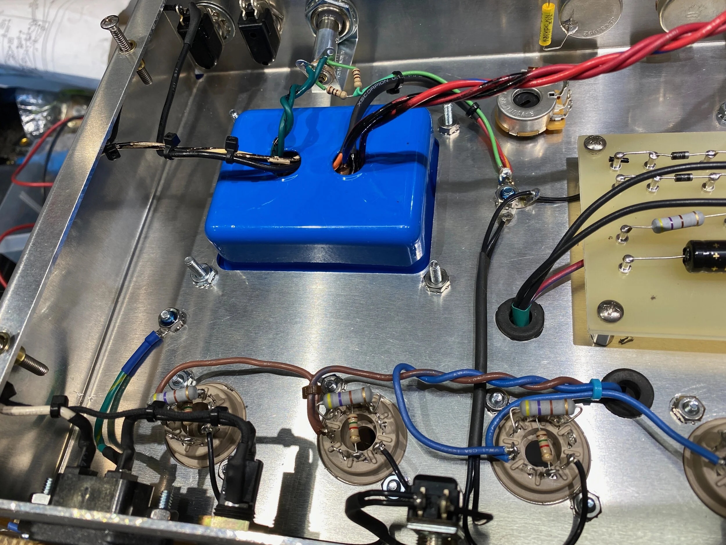

Whilst I wait for a few resistors from the post I thought I'd share a few updated photos from my build.  I'd like to thank all who've given me input.  I've been familiar with Fender amps for a while, but decided to take the plunge into building one after I came across a Quad Reverb with various parts left in it.  The board, OT, a few pots and wiring are all my work.  I read for days trying to figure out specific schematics, layouts, specs on parts for this amp...Then things started to click.  The RobRob site and Hoffman sites are incredible sources of information (I used more sources, but those were the most frequently visited).  The abundance of quality encouraging advice has helped me tremendously to this point, as well.  Even reading posts about how to troubleshoot possible problems  has made me go over and over this amp to see if problems exist.  All I have left to do is install two 1.5K resistors, hook up the OT, NFB, and commence the Rob Rob start up procedure very carefully, of course.  Here are a few pictures....Please offer any comments concerning lead dress or anything else you notice, I'll know if it's good when I turn it on I guess.   I have a floating bus wire under the pot wires grounded at the far input end. Hopefully the magic electronic smoke stays inside.  I'm checking and triple  checking  everything before power up.

A few more pics from earlier in the build...Last week.

All im really seeing as an issue are the white wires flying off the yellow mojo caps. Did you attach the other end of that capacitor to an eyelet and then wire off that or is it a direct connection? We dont want anything that can vibrate loose in the cassis
The caps are directly into the center of the turret, while the wire is nearly circumferential at the base of the turret on all wire connections.    I used solid core 18g and bent it very very carefully.

Be a little careful grounding to transformer bolts as they usually loosen up over time.  I personally stopped doing that a long time ago and now drill a dedicated hole for my star grounds etc.  Just a thought.  Good luck with your amp :)

 :BangHead:  SOOOOOO, I started the procedure for powering up the Twin Clone.   All connections were secure and in the right place before beginning.  I used a current limiter and a variac.   Measured all the AC voltages.   Check.  The limiter never glowed.   I have  very high wattage bulb.
 Given the limiter was attached, the readings were close to expected.   Once I started to power up the amp and got to 45V on the variac, the B+2 cap blew up.    I waited about 10 minutes prior to each incremental increase of 10V.  I had taken appropriate safety precautions.   Could this be result of a bad choke?  Could the cap have been too small? It was a 22uf/500V?   Bad capacitor?    The polarity was correct.
  Thoughts appreciated.    :help: :dontknow:

I just looked at your rectifier board. All six of your diodes are installed backwards and are applying reverse voltage to the filter caps! That's blowing up your caps. Those hot node A caps are probably damaged by now too. They've definitely been stressed.
