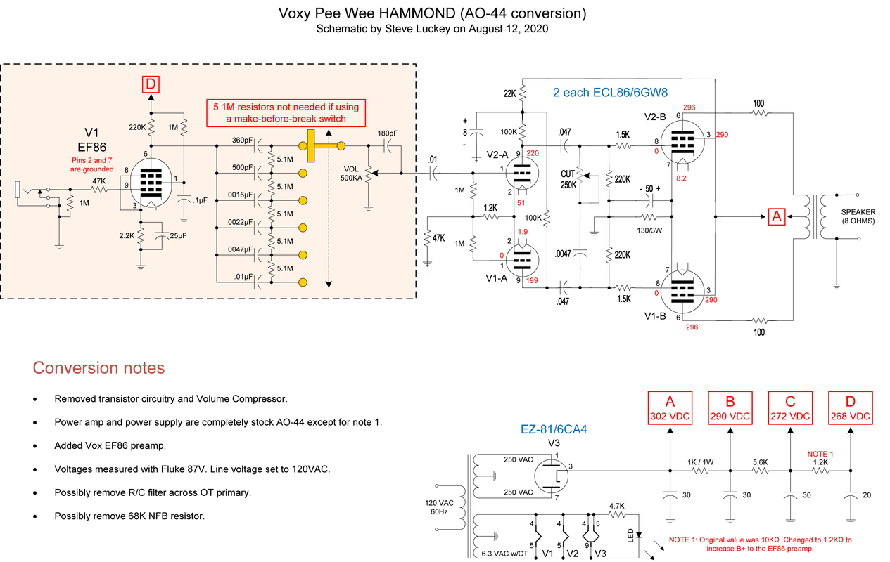

A friend just gave me an AO-44 and an AO-50.  My plan is to use the AO-50 iron to make one of sluckey's AC-15s, but I'm wondering, does the AO-44 iron have enough guts to power an AC-10?
The amp didn't come with tubes, so I'm not locked into ECL86s.  If I understand correctly an ECL86 is basically an EL84 with half a 12AX7 thrown in for good measure.  So that would cover the needs of the AC10 power section.  But will the AO-44 PT handle an additional EF86 and ECF82?
I'll be using a different chassis so I'm not concerned about fitting the circuit inside the AO-44 box.
Thanks everyone!
I would say yes ***IF*** you stay with the 6GW8.  Might be a stretch to use EL84s. Maybe drop the tube rectifier and use SS.

... I'm not locked into ECL86s.  If I understand correctly an ECL86 is basically an EL84 with half a 12AX7 ...
... I would say yes ***IF*** you stay with the 6GW8.  Might be a stretch to use EL84s. ...
ECL86/6GW8 is a 9w tube (scroll to page 2), while EL84 is a 12w tube.  It's kinda like an EL84, but doesn't have the same grunt.  Heater current is also higher in the EL84 (though not by a lot).
I own a 1965 AC10.  The clean channel is useless to me as it's very clean & wimpy, using just the triode half of the ECF82/6U8 (having an Amplification Factor of 40 like a 12AY7) to drive the phase inverter.  The pentode section is used for the tremolo oscillator; I would look to build it with a MOSFET rather than a tube, and retain just the EF86 channel.  Then I'd use the existing triodes in the ECL86s for the long-tail phase inverter.
I suspect the whole thing could still fit in the AO-44 chassis, a la Sluckey's PeeWee.  That might depend on using compact caps for the trem oscillator.

Thanks guys.  So if I stick to a single EF86 and keep the stock power section with the ECL86s I should be OK then.  If that's the case, would my best bet be to start with the AC15 normal channel as the preamp?  I can build a solid state tremolo for it, that's what I did with my current AO-44 amp (with a tweed Harvard pre-amp).

...  So if I stick to a single EF86 and keep the stock power section with the ECL86s I should be OK then.  If that's the case, would my best bet be to start with the AC15 normal channel as the preamp?  ...
You can if that's the circuit you really want.  But the AC10 trem channel has a larger plate load resistor (possibly more gain).  And the real-hot ticket is when you turn the trem off with the footswitch, the Amplitude (Depth) control alters the gain of the EF86.
You can get some grindy tones at very low volume just by messing with that control.  I most-often play my AC10 at pretty low volume, trem off, and the Amplitude control full-up for max EF86-color.

I would just put an EF86 preamp in front of the original power amp inside the original chassis. This is the easy way to see just how voxy it will sound. My gut says it would sound good. I've attached a schematic of my idea.
However, if I had to buy a pair of 6GW8s, I'd just shelf the AO-44 or consider converting to use 6BM8s. A pair of new 6GW8s will cost $120 and a pair of new 6BM8s will cost $44. It's a lot of work to convert to 6BM8s inside that chassis.
The AO-39 is well suited for your AC-10 idea.

Sluckey, thank you so much for the revised PeeWee!  I'll definitely drop the negative feedback and conjunctive filter.  Am I correct that I can drop in a Vox style tone cut control?  While the component values are different in the AO-44 power amp, the topography looks very similar to an AC10.

Pins 2, 3, 7, and 8 have to be shuffled around. Looks simple enough on paper, but when you get inside the P2P chassis it's gonna be a different story. Gonna be a bigger job than you would think. It's doable but definitely not just a 2 beer job!  :icon_biggrin:

Great! You may want to look at my Pee Wee to get some ideas how to place the extra tube in the chassis. The AO-44 uses a cathodyne PI and that cut control acts funny with the cathodyne, but it's easy enough to just stick it in and see if you like it. It would probably be better to rewire the triodes to the AC-10 LTP PI. Then the cut would work fine.

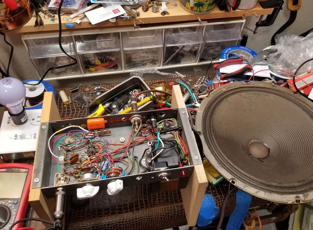

It's alive!!!  All wired up to Sluckey's VoxyPeeWee schematic (with OT R/C filter and NFB removed) and it's raw and raunchy.  Pretty great just running out of a very tired Oxford 12L6-4.
Immediate observation - this makes a lot of treble!  I'm thinking of changing the values of the Brilliant switch, dropping the 360pf at the thin side and adding a .022uF at the low end side.  Or should I go even to .033uF or .047uF?  I suppose I can do that testing.
The other thing I'd like to try is a cut control.  I know I have to switch over to a LTP phase inverter.  I've tried to modify Sluckey's Voxy PeeWee with an AC-10 power section.  I know the pentode section of the ECL86 isn't the same as an EL84, so I assume some of the component values need to change?
I appreciate all the advice here, and thanks for your continued assistance!

OK gang, a few updates:
HBP, I tried your cut circuit, and while it did something, it didn't do much.  I wound up tacking a modified tweed Harvard tone control after the volume pot, which got me the top end control I wanted without taking any of the tonal character away.  Next I added a switchable 1uF cathode bypass capacitor on V1A which gives a nice volume boost.
Finally, I also added a triode/pentode switch on the EF86, based on the circuit in the AC15H1TV.  I get a pretty pronounced popping when switching, which I didn't hear in demos of the Vox amp.  From what I've read, it seems this popping is the nature of the beast.  I tried high value resistors in various configurations around the switch with no difference (between outer legs, between both outer legs and the wiper, between one or the other leg and the wiper)  Anyone have any ideas?
The final schematic is below.  I've updated Sluckey's schematic to note what I changed.
Once again, thank you everyone for your help!
