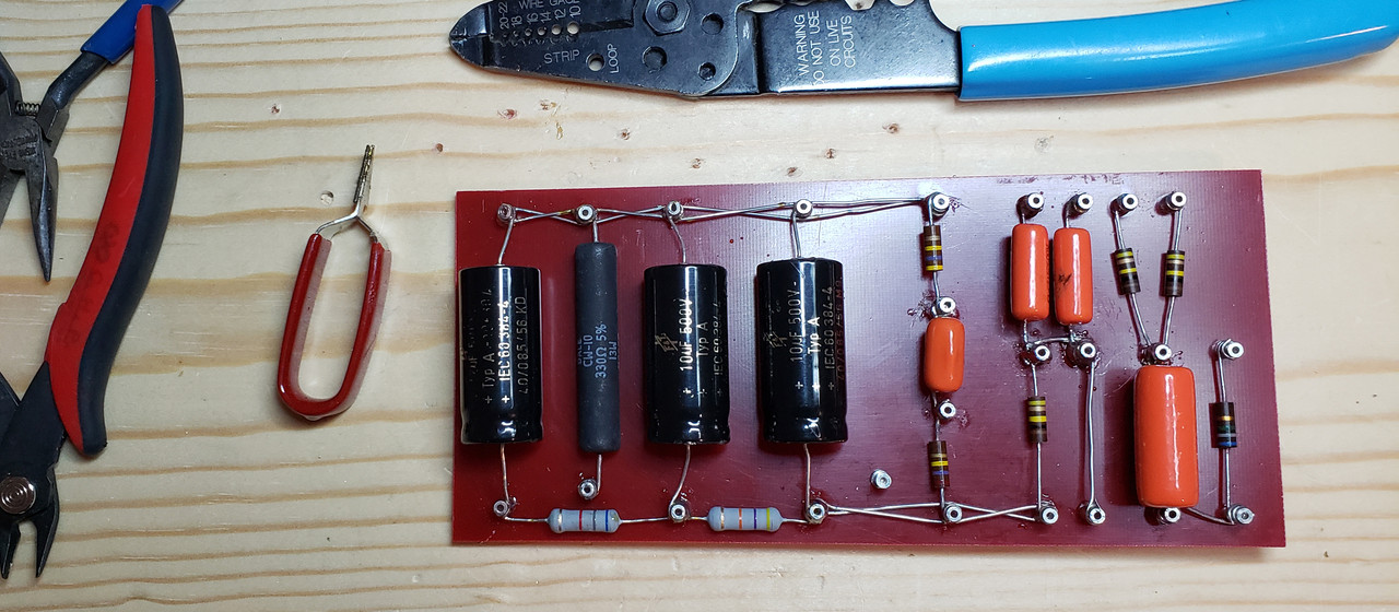

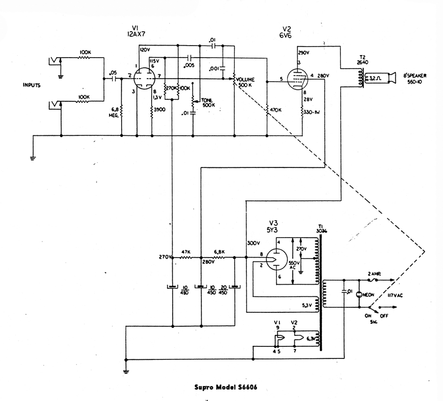

I'm at it again. I decided to do the Supro S6606 because it's different than all the Tweed Princetons out there. Similar but different. I have a nice Weber 8" speaker laying around so I decided to build a combo amp.
I'm running into a problem creating the turret/eyelet board layout. I get going on the drawing and then it quickly gets messy and confusing. It's not the same as the 5F2A but it's close in some areas. I've been looking for another layout that matches the schematic but failed so far.
I haven't found any software to do it as they are all focused on digital projects and PCB production.
Does anyone have a layout or can help me out?

« Reply #2 on: April 30, 2021, 03:58:36 pm »
Holy Heck....Wow...
I'm looking over the layout vs the schematic and I'm learning. I'm starting to understand the way to do this.
I spent 4 hours of crumpling paper, knowing I was not right. It's a learning curve and I sure appreciate the lesson here.
I see where you changed the position of the .01 cap and Tone pot to the other side. Smart.
I have a spare Valve Jr OT and a Weber Champ PT to do this build. Components are here too. I'm waiting on the blackened tuna tolex and grill cloth and the pine box to build the cab.
Thank You

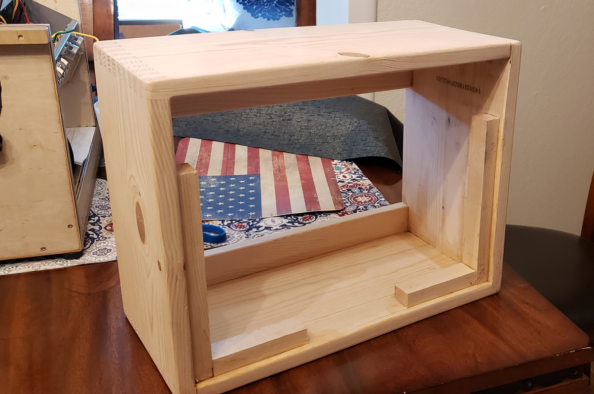

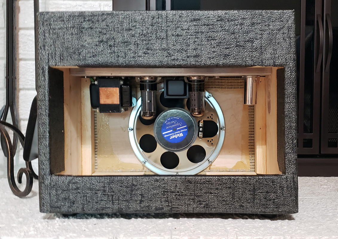

I built a finger jointed pine box and covered it. Took a blank 5E3 chassis and chopped the height down. Drilled it and mounted all the hardware to check the fit. I made the baffle out of 1/4" Baltic Birch plywood and glued on the grill cloth so I didn't destroy the baffle with staples.. cut some vinyl and fitted some bakelite witch hats. All the parts are soldered onto the board.
I can't thank Steve Lucky enough. He has been my inspiration on the last 3 builds.

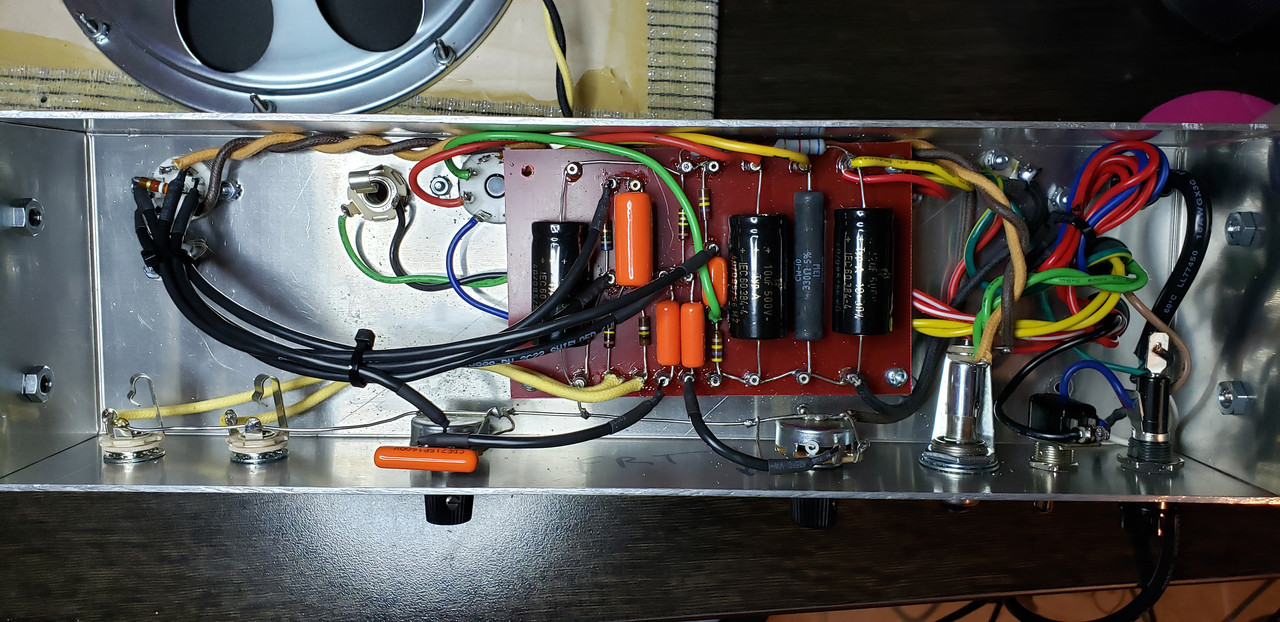

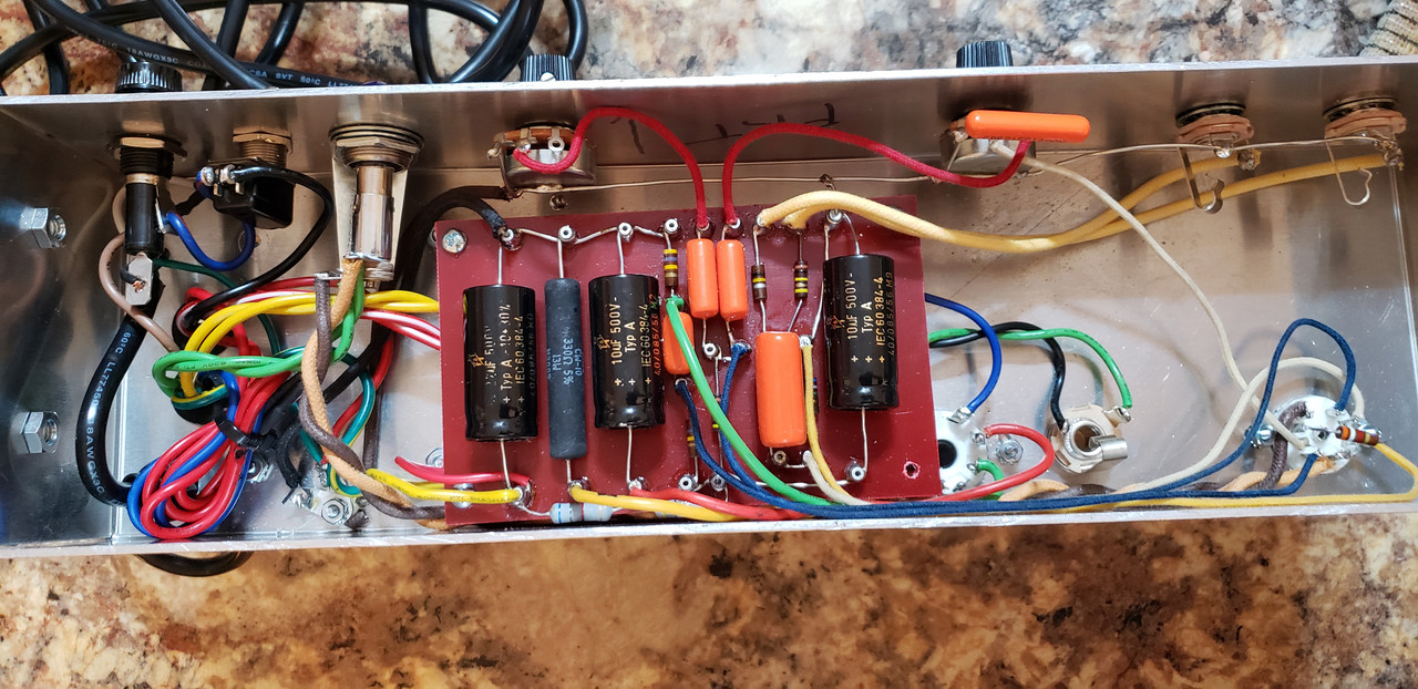

I fired her up tonight. She behaves perfectly from 1 to 10 on the volume. Exactly as I expected.
But.....
If I turn up any tone at all she starts squeeling and then begins to motorboat at about 8 or so.
I checked the wiring and verified it all is correct and soldered properly.
I moved wire around with chopsticks but no change. Something isn't right...
I decided to take a break and look again tomorrow.
Great sounding amp tho..No hiss, hum or noise at all at any volume.
Re: Supro S6606 build
« Reply #7 on: May 10, 2021, 09:21:27 pm »
You have the very small input signal wires real near your large power plate wires. It begs for sneak-back and oscillation.
If you don't have even an approximate Supro layout, plagiarize a Fender. This probably means putting the 12AX7 parts over near the 12AX7, far away from the 6L6/6V6 parts. (Yes, about where that extra 1/4 jack is.
« Last Edit: May 10, 2021, 09:23:37 pm by PRR »

« Reply #8 on: May 11, 2021, 12:54:02 am »
Thank You PRR,
Sometimes it takes someone else to say what you know already.
I did my usual fix. It worked fantastic on a JTM50 Black Flag where I moved some stuff around.
I just did a test and quiet as a mouse.
Thanks.

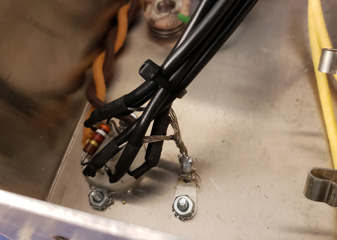

I see you even "shielded" the ground wire to the tube. But shielding is useless if you don't connect the shield braid to anything. Your fix is simply due to rerouting the wires.
Offline AnalogDok
  • Posts: 83
« Reply #10 on: May 11, 2021, 10:40:37 am »
You can't see the ground wire from this angle. I wrapped all the shield cable grounds together and soldered them to a ground lug bolted through the chassis near the 12AX7. The lug is right underneath the plastic tie wrap. The tone and volume grounds are connected to the main ground run across the pots. I't a shield ground so there should be no ground loop issues. All my other grounds are in one star ground spot near the PWR Tranny.

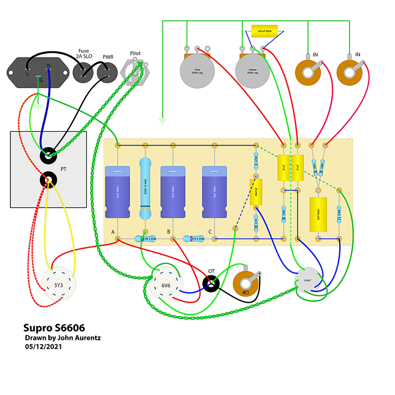

« Reply #11 on: May 11, 2021, 01:20:26 pm »
Here are my measurements. Fluke 77
Line in 124.4 VAC Transformer set to 125 VAC
Heater is at 6.58 VAC under load
V1 (12AX7)
Pin1  134.1 VDC
PIN2  .587 VDC
PIN6  160 VDC
PIN8  1.56 VDC
V2 (6V6)
PIN3  364 VDC
PIN4  345 VDC
PIN5  .015 VDC
PIN8  18.9 VDC
Points as marked on the layout
A = 379 VDC
B = 347 VDC
C = 267 VDC

« Reply #12 on: May 11, 2021, 02:12:03 pm »
Your layout is the problem. I don't think you can stop the squeal with that layout.
« Reply #13 on: May 11, 2021, 04:44:14 pm »
Not just the wires. The caps and resistors on the board are also "antennas".
Fender would put most of that board over near the 12AX7; a longer board so the 6V6 stuff can go on the other end away from the little stuff.

PRR and slucky,
I was thinking of routing the 6V6 wires under the board to separate the wires but a longer board and moving the 12AX7 parts away from the filters and 6V6 sounds reasonable. If at first you don't succeed, try, try again. I have some more board and turrets.
I have a Tweed Princeton layout in front of me and that's how Fender did it.
  • Posts: 5391
« Reply #15 on: May 11, 2021, 07:50:22 pm »
My board layout was designed to be used in a chassis that was laid out like my layout drawing. The board must work together with all the other components. Tubes should have been laid out as in my drawing. Same with front controls and inputs. But as logical as my board layout is, it just won't work well with the way you laid out your chassis. I think you will be time ahead to just ditch my board and start over, maybe even just build true PTP with terminal strips. But in any case... MOVE THAT SPEAKER JACK FAR AWAY FROM THAT PREAMP TUBE. AND SHORTEN THOSE INPUT WIRES.

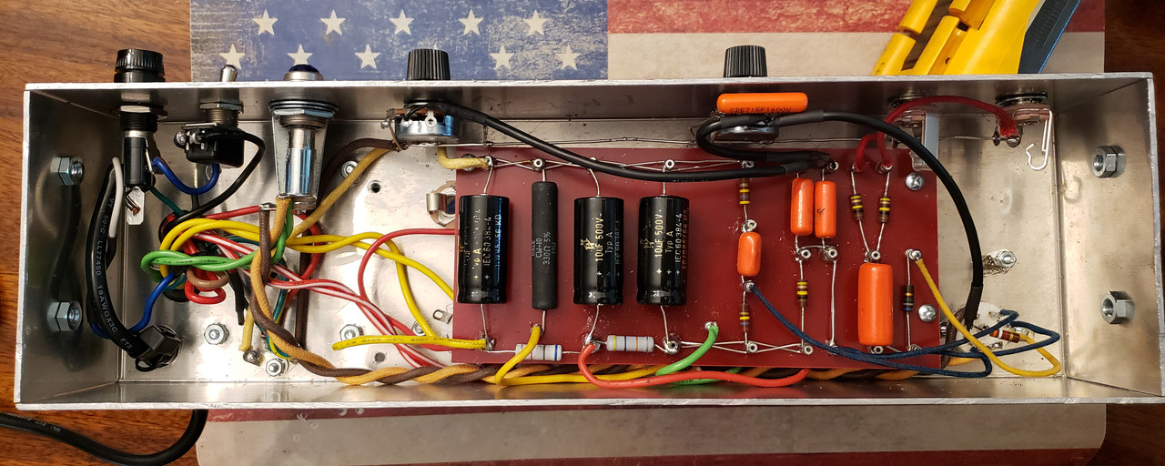

I laid out the parts a bit different.
I think this will work much better. I ran some beryllium copper shielding around the chassis to see where the radiation was coming from and the speaker jack wasn't the issue. Since I moved all the preamp tube signal wires and shielded them it had no effect there either. Laying the parts out with separation both for distance and function should resolve the radiation issue on the board.
« Reply #18 on: May 12, 2021, 05:10:12 pm »
Not the same amp, but a comparable side by side: look OK. Worked for Leo.

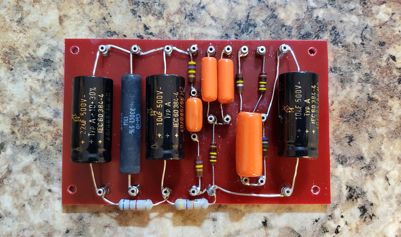

Board Ver 2...
I verified all the parts were within spec and used a heat sink when soldering.
Now to install and test.
Offline AnalogDok
  • Posts: 83
« Reply #24 on: May 13, 2021, 03:58:21 pm »
I'm shocked...it worked...zero squeal no matter where I set the volume and tone.
It does squeal like a banshee if no guitar is plugged in tho and there is a slight buzz.
Next is isolating the the reason for the squeal with empty input jacks and then the very slight buzz.
It's bright, doesn't sound like a Tweed Princeton and the distortion starts after 7 on the volume knob.
It doesn't sound remotely like a Fender in distortion. It sounds really good on 10...

The jacks worked great and the 6n2P has a little more headroom, compression and smoother distortion.
I do hear some artifacts when it is cranked so I'll try some other 6V6 tubes. I'm running a Motorola from the 1960's at present.
I went in with a chopstick and touched everything with the guitar hooked up and everything is solid and moving wires around does absolutely nothing.

I replaced the ancient Motorola 6V6GT with a brand new JJ 6V6S I had laying around and there is no after effect or artifacts at all. It's just perfect now. New jacks installed completely eliminated that squeal when nothing was plugged into the input jack.
I moved the output jack to the only available area which was in between the transformers. The chassis is a 5E3 so it's 14.5" long X 3.5" wide and the 3.12" board barely fits and I only have 3/4" standoffs so there wasn't much choice except to move towards the transformers opposite the preamp tube.
It all works exactly as it should. The Weber 8" speaker is a bit bright but then 8" speakers are limited anyway.
The OD doesn't sound like Fender at all. I like it and it doesn't get mushy. It sounds pretty much like a S1606 like on the Youtube videos.

Here is a shot at the amp's interior.
I like to use 10 Watt Dale wirewound resistors in place of the 5 watt and 3 watt in place of the 1 or 2 watt.
It just adds safety. None of my amps have Chinese made Xircon.

> based on the voltages you posted, the 6V6 is running at approx. 18W of plate dissipation
Which numbers are you looking at?
Reply #11 seems to say 12.05 Watts in plate.

Using the numbers from reply # 11:
Cathode_current (Ik) = Cathode_voltage (Ek) / Rk
Ik = 1,000 x 18.9 V (6V6-pin8) / 330 ohm
Ik = 53.3 mA
Plate_current (Ib) = Cathode_current (Ik) - Screen_current (Is)
Using 6V6 tube manual and calculated Ik, we get:
Ib = 52.1 mA
Plate_dissipation (Wb) = [Plate_voltage (Eb = 6V6-pin3) - Cathode_voltage (Ek)] x Plate_current (Ib)
Wb = (364 - 18.9) x 52.1 / 1,000
Wb = 345.1 x 0.0521
Wb = 18.0 W
« Last Edit: August 27, 2021, 06:41:28 pm by K Teacher »
« Reply #43 on: August 28, 2021, 12:42:17 am »
Ah, are we then using 330Ω for Rk? Then yes, hot.
