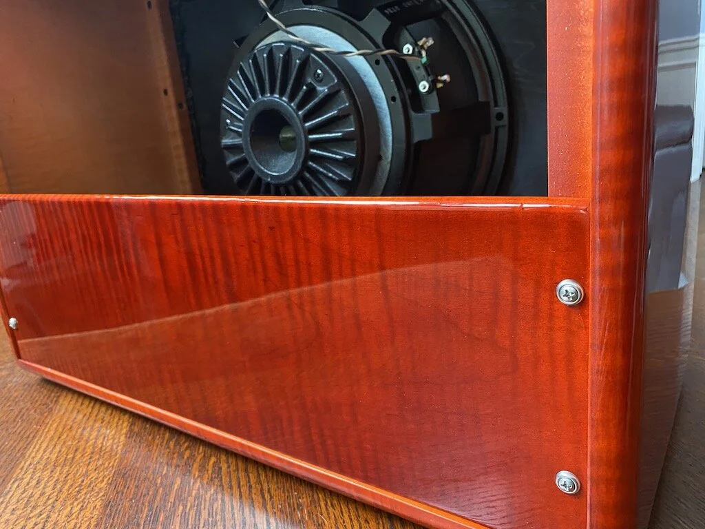

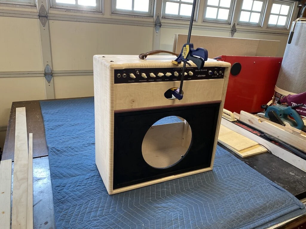

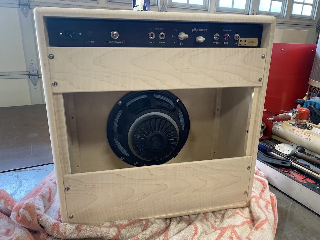

Hey There Builders,
I am curious how many of ya'll build your own cabinets?  I fully admit that I order almost everything from pro cab guys.  Lately I have been dabbling doing a few for myself.  Kinda fun when you know you get to enjoy one for yourself.  I would love to see some pics in this thread.  Here are a few I've done plus another I am working on now in flamed maple.
Cheers

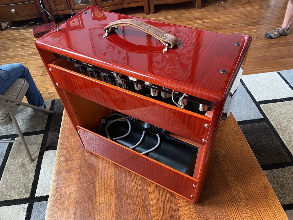

This is my finished product

Have you tried the Electro Voice EVM12L? All the Dumble guys like 'em for powerful/clean sounds. I have one in my TV cart.
Offline p2pAmps
  • Posts: 930
    • p2pAmps
Re: Home Grown Cabinets
« Reply #13 on: July 28, 2021, 09:29:51 pm »
The speaker in this one is an EV Force and so far so good.  It was a NOS I picked up o Reverb.  I also like the Eminence EM12 which is suppose to be like an EVM12L.

Beautiful work. Are you using poly? Im just now trying to learn to make finger joints. Made two simple jigs but the joints came out a little too loose. Probably need to invest in some calipers to get things set up more accurately.
Offline p2pAmps
  • Posts: 930
    • p2pAmps
« Reply #15 on: August 06, 2021, 09:10:39 pm »
Thanks!  The finish is acrylic urethane seal with shellac first.  The joints in the cabinet are actually dovetails in which I use a Leigh jig and a Festool router.  For box (finger joints) I use an incra i-box jig and my table saw setup with a dado blade.  Super accurate and tight joints.  Chck out that incra i-box jig for box joints :)
