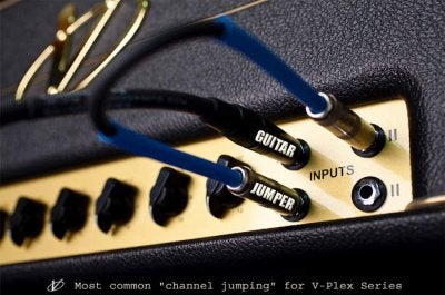

I like classic Traynor amps, and have a few.
Personally, I like the two of them that are bass amps stock, when using them for guitar (with one exception - see below).  You can take that with a grain of salt if you like. I am not generally the type to say "how can I make this non-Marshall amp sound more like a Marshall" or "how can I make this non-Fender amp sound more like a Fender".  I buy amps like Traynors because I want something different from a Marshall or a Fender, but still awesome in ways that I like.  So my preferences not to mod, or mod too much, right away, might be different from yours.  But again, I like Traynor bass amps pretty much stock, for guitar use.
The one I have that is closest to your YBA-4 is a YBA-1 Mark II.  In addition to being a head only, there are a few other differences, but overall they're close.
A few thoughts about this comment:
Both sound very good although the 6 string does have a bit of a boost in the upper mids which is a little bit overbearing and can cause some pain to the auditory nerve.
You may already be aware of this, but maybe not, so I'll mention it.  If you plug into the "bright" channel - that's the side with a 0.001uf cap strapped across the volume pot - you will obviously get a high-end boost.
In my opinion, the bright channel can be a bit much.  I actually think that most of the time - the stock / standard treble bleed cap is generally a bit much for my taste, on most amps (not just my Traynors).
You've got options, before going crazy with mods.
One thing I have found can work well on my YBA-1 is the widely-used jumper-the-channel-inputs approach, as shown on this four-input Marshall pic I just googled-up in case you are not familiar:
https://www.tdpri.com/data/attachments/166/166154-6f551abafe3d61b3327276a4fd6e1a6f.jpg
I like to do this anyway when going for hard-rock guitar tones on my YBA-1, because you get more gain.  But it also lets you blend in more of the non-bright channel (turn it up higher), and less of the bright channel (keep it lower).  So yes, this gets you more drive and gain - but it also lets you mix the two channels together in ways that affect the overall tone.
