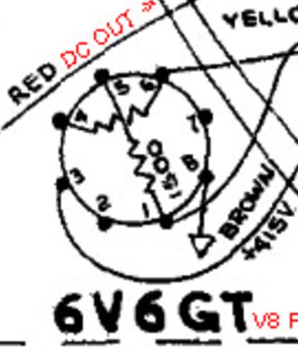

  • Posts: 4458
Re: AB763, Bias voltage issue?
« Reply #12 on: September 21, 2021, 07:48:35 pm »
For 6V6s (or 6L6s):
Pin 1 = no connection
Pin 2 = heater filament
Pin 3 = Plate
Pin 4 = Screen
Pin 5 = Grid
Pin 6 = No connection
Pin 7 = heater filament
Pin 8 = cathode
The pin socket tabs for Pins 1 and 6 (having no internal connection to electrodes inside the tube) are often used to anchor 'other' lead(s) - i.e. for the screen resistor or grid resistor (when these resistors are tied directly to Pins 5 or 4 respectively). But make sure, if using these pin tabs, that the connection for each pin tab is only to one of the resistor leads (and not to the leads on both the screen and grid resistor at the same time to the same pin tab - because that would be bad).
However, sometimes Pin 1 can be tied to Pin 8, and so be tied to the cathode. (when this is done, it is to help 'eat up' AC from the adjoining heater filament pin tabs). If this is done, make sure the Pin 1 tab isn't tied to the cathode as well as to the screen (or grid) pin tab at the same time.
In a PR, which is fixed bias, the Pin 8 tab needs to go to ground (usually either directly, or via a 1R cathode-current measuring resistor in series between the Pin 8 tab and the chassis ground). This connection is needed for the output tube to conduct - even though this pin voltage should be sitting at about 0VDC
Pin 5 needs to be connected directly to the bias voltage source (as well as to the coupling cap(s) from the Phase inverter). If using a grid resistor, this can be in series between the bias supply and the socket pin tab - usually with the other grid resistor lead connected to the Pin 1 tab (as described above). This pin voltage should be sitting at about -20VDC to -27VDC (so that you get about 18 to 24mA of tube current - measured at the cathode current measuring resistor)
Pin 4 needs to go to the screen grid resistor, (usually with the other resistor lead going to the Pin 6 tab - as described above). This connection is needed to turn the tube current 'on' (If the other connections are all connected, but the screen is at 0V, it will suppress tube current to such an extent that the tube won't conduct). The voltage on this should be close to or new the same as, the B+ voltage - or the same as the HT supply voltage for the screen supply node i.e. 410ish VDC.
Pin 3 needs to go to one of the output transformer primary winding ends. (and the Pin 3 tab on the other socket goes to the opposite OT primary end). This connection is also needed for the tube to conduct and supply current to the tube (through the OT primary winding back to the primary centre tap, which is connected to the B+ (incl reservoir cap). The voltage on this should be within a volt or two of the B+ voltage (i.e. 410- 430Vish)
The tabs for Pins 2 and 7 go (one each) to each side of the 6.3VAC heater circuit - which needs to be connected to the heater winding on the Power transformer. These connections are needed to heat up the cathode to the required temperature to ensure easy release of electrons. If the heaters aren't connected, the tube won't go 'on'. you should measure 6.3ish VAC between Pins 2 and 7, if everything is working properly.

Tubeswell: The 6V6GT tubes are wired exactly like the original Fender schematic and the Robinette layout for a Deluxe Reverb.
72Blazer: Even a novice has something to add and I was thinking along the same lines last night. I wired this up as per the color codes as specified but I used a 1960's Hammond A029 OT and the color code may be different. I'll open up my 5E3 or PR to check today as they have the same OT and are working fine.
PRR: I quadruple checked the 6V6 connections after it was discovered I left out the connection from Pin6 to B+.
Since I'm running a PT that was designed for 117VAC. it is running a little high on the voltages at 122.5VAC.
What confuses me is that the 6V6 tube chart shows a maximum of 315V for the plate, the Fender schematic shows 415V.
Sluckey: I see 438V instead of 415V on the plates and screens which is as expected given the higher B+ on the PT.

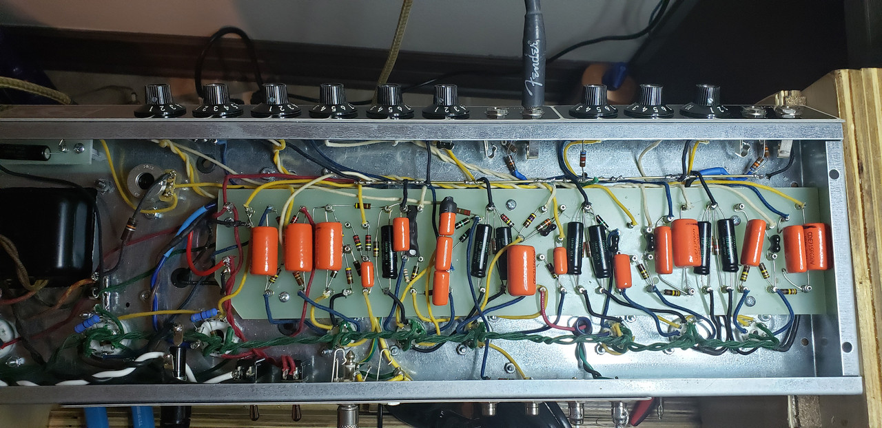

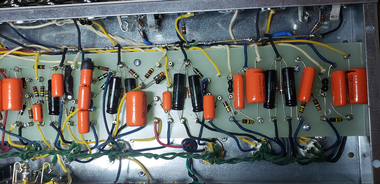

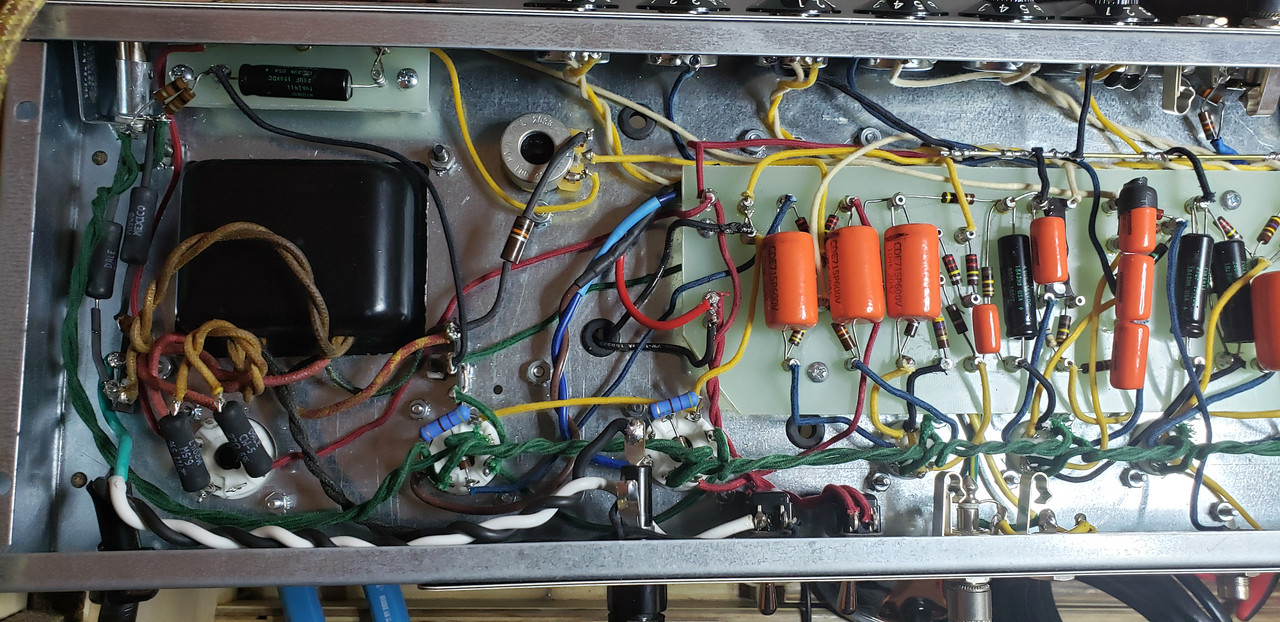

OK, I got curious and looked at the pic Sluckey.
I missed the connection between the roach and that 25uF cap. That's some genius level talent there to figure that out without any info but voltages. Sucker worked right away after I bridged it and it sounds real good. Thanks Sluckey.
Now I have to figure out why the Tremolo doesn't work.
Here are the pics as requested. Sorry for the delay.
« Reply #23 on: September 22, 2021, 09:12:51 pm »
You must have a footswitch plugged in to enable the tremolo on an AB763 amp. Or you could just put a ground jumper on the vibrato F/S jack.
