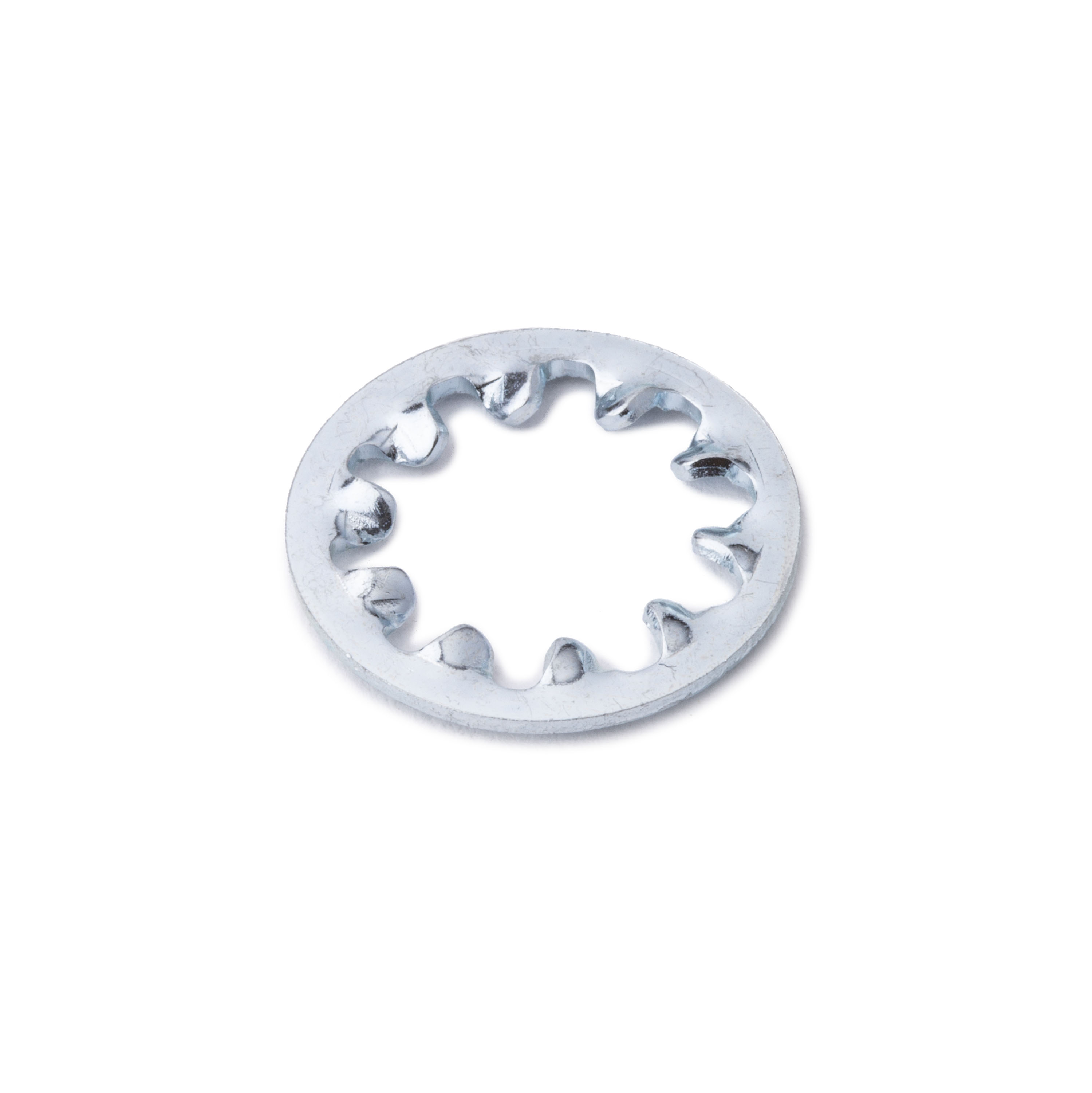

For the purposes of grounding what washers are to be used on the pots?
This.
Or This.

You are showing two types of star washers -- internal and external.  There are other types as well.
The external type does not work with typical pot installations.   The external serrations must be crushed between the part (or a washer) and the chassis.  Normally this can not occur in the amps we build because the pots are mounted offset away from the chassis with an internal lock nut on the stem.
That's not to say that you couldn't use them in some situations . . .

Doug, so you do use the external tooth lock washers?
From inside to out, this is how I mount pots:
pot with threaded stem
lock nut -- this is probably better thought of as an adjustment nut for the stem height
lock washer
chassis
flat washer
nut
The external serrations won't get crushed in this scenario.

thanks folks i am now more confused than ever. Mounting star washer on outside of chassis?  Internal vs external washers?  huh?

Another point about using the star washers is that the teeth are going to bite into the surface
You would not want to be doing that to a faceplate
