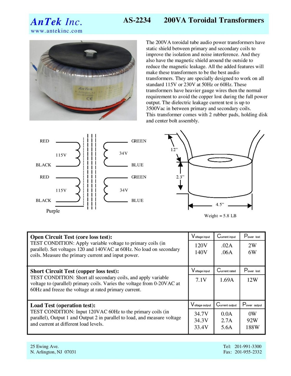

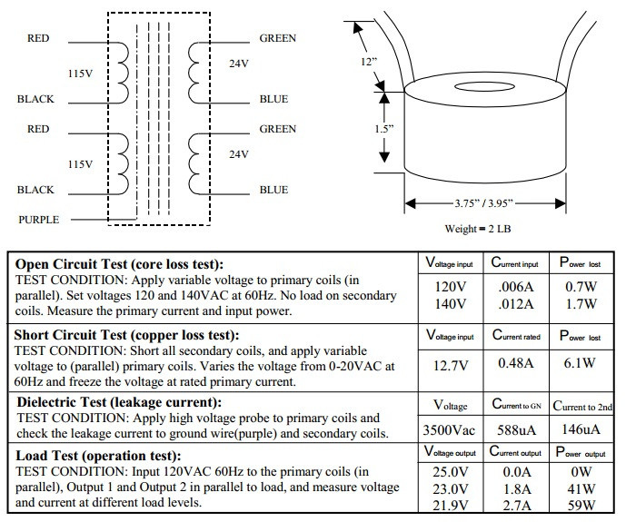

« Reply #13 on: November 12, 2021, 11:14:38 am »
....DMM between outlet hot and xfmr primary, looking for current. It shows 192ma of current thru the primary,
Exciting current.
Antek has no-load specs:
50VA  https://cdn2.bigcommerce.com/server6000/2b6qq/products/178/images/895/AS_0524__36611.1387480532.1280.1280.jpg
200VA: https://cdn2.bigcommerce.com/server6000/2b6qq/products/384/images/1346/AS-2234__64381.1510892638.1280.1280.jpg
These are toroids which may tend to lower exciting current than E-I types.
