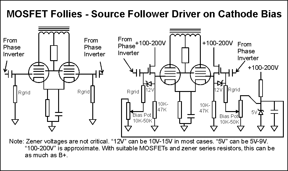

In Tubenit's implementations, he has a 12V Zener coming from the source ("cathode")  to the gate ("grid", also connexted to the EF86 plate).  In reading RG Keen's article, the Zener is not mentioned. What is the purpose of the Zener here, and is the 12V value critical?

The 12v zener between Gate and Source is an insurance mechanism to prevent overvoltage which would otherwise destroy the insulation layer between these. The IRF820 will ‘work’ without it, but may not last long. Best to keep it there. Note that the IRF820 is a 500V rated device, so will work directly in place of a 12AX7 triode without needing any ‘extra’ components (apart from the 12V Zener). The TO220 package is rated for 1W without any heat sink, so it will be able to handle the power that a 12AX7 sees if used in a stage intended for a 12AX7.
Having a zener diode is critical IMO and 12v is right for the IRF820 MOSFET.  It is there to protect the MOSFET's gate.
It is used so often that sometimes folks drawing diagrams think, "Well, everyone knows that it must be there."
Kinda like sketching a preamp circuit & not-drawing the details of the power supply:  "But everyone knows the tubes won't work without a power supply.  So they know they will have to tack on a power supply, even if not-drawn..."
Notice that where R.G. Keen draws a MOSFET source follower drive for output tubes that he includes a 12v zener.

The G-S voltage limit tends to be +/-20V, so rather than just a single zener, a series pair of 12V zeners in reverse polarity to each other seems a good idea, being as however unlikely the occurance of the gate being >-20V below the source, for the cost of another zener, device destruction is something worth avoiding.
So as long as the cathode bands are not going in the same direction, then I'm good, correct?  Cathode tied to cathode, or anode to anode doesn't matter.

...a series pair of 12V zeners in reverse polarity to each other seems a good idea...
A single standard 20V Zener breaks-over at 20V one way, 0.6V the other way. Since we have no NEED to force the Gate negative, this is just what we want.
Agree that form modern MOSFETs in tubey circuits, 12V is way ample, even 7V (BJT BE junction) is usually enough to pass the desired currents.
Correct, but I think PRR found a flaw in my thinking  :think1:
