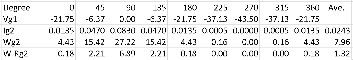

Ok, I think I got it. I've been trying to figure out if I can get away with a smaller g2 stopper so that if I use 6L6's, KT66's, etc., instead of EL34's I won't get as much screen compression. (worth it?) I did a spreadsheet with the values I got from the loadline.
The screen supply voltage is 342v but with a 1k g2 stopper at 13.5ma quiescent I used 328v for Vg2.
I hope that this looks correct enough.

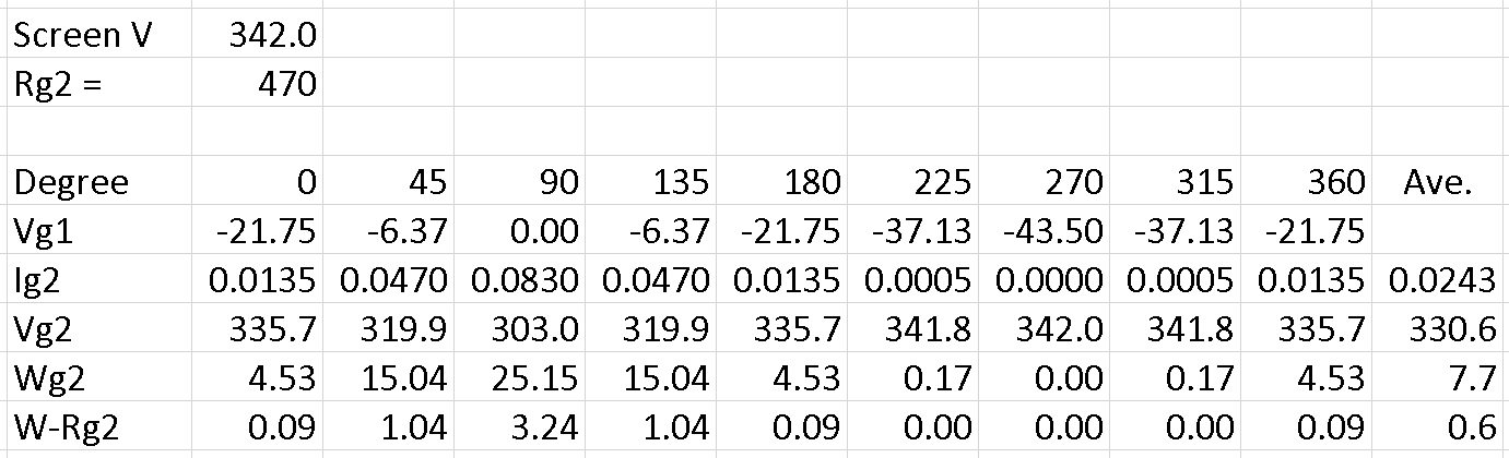

Then I decided to add Rg2 as a variable to see how it affected the Vg2 and Wg2. Ig2 will also change so I am cheating a bit. This is with a 1k g2 resistor.
I changed Rg2 to 470 ohm.
There are variables not accounted for, but am I in the ballpark?

I agree, looks like you nailed it!
... I've been trying to figure out if I can get away with a smaller g2 stopper so that if I use 6L6's, KT66's, etc., instead of EL34's I won't get as much screen compression. ...
6L6 and KT66 naturally have lower screen current, so the bigger resistor is not a problem at all.
EL34 needs the big resistor because it does not have the aligned-grids of the 6L6/KT66, and screen current peaks higher in use.  Hence a greater need to restrain screen dissipation.
... Thinking about the worst case for a guitar amp, full clipping where the output looks like a square wave, with a 1k g2 stopper I would have:
Wg2 = 83ma x 259v / 2 (50% duty cycle) = 10.75 watts
W-Rg2 = (83ma x 1000)2 / 1000 / 2 = 3.45 watts
This is a rough approximation and would not happen very often or maybe not at all, I'm wondering what safety factor should be applied for heavy clipping?
If you assume the supply voltage will not sag/drop, then:
     8w / 0.083A = ~96 volts ---> allowable on the screen
     342v - 96v = 246 volts ----> to be dropped by the screen resistor
     246v / 0.083A = ~3kΩ ----> required screen resistor
But slugging the screen volts down to ~96v will clamp plate current & also screen current.  Therefore screen current will not get that high.  And along the way getting there, grid-drive from the phase inverter will be clamped by the EL34's G1 grid-current, and there will likely be bias-shift/grid-blocking that will tend to slide the tube towards a colder bias.  These things also mean less plate & screen current.
So what now?
     Take the info as "3kΩ is an upper limit, maybe 1kΩ is a lower limit."
     Test an actual amp driven very hard with 2 meters:  1 for screen volts (screen-to-cathode), another for screen current (maybe volts across screen resistor, maybe actual series ammeter).
     Start closer to 3kΩ, drive the amp hard, start backing off in the 1kΩ direction until you get the desired balance of screen dissipation & power output & low-compression/sag.

As examples I've been looking at the Matchless Chieftain, Clubman and BadCat HotCat. It's interesting that they can use 1k g2 stoppers and they run at higher voltages, but use 10watt+ resistors. I am guessing that they are hard on EL34's, and that contributes to their sound?
Looking at the Philips El34 data, Wg2 "Limiting" = 8W. How far can g2 be pushed and get "reasonable" life (2 years?) without catastrophic failure? This amp will have a built in attenuator so the EL34's will get worked.....
Thanks for all your help on this.
Re: Average Screen Current
« Reply #14 on: July 12, 2022, 06:03:33 pm »
The tube would be in cutoff for a portion of the signal so it would need to be averaged (RMS)? Looking at the loadline it is in cutoff for about 25% of the signal.
I did not spend much time working through the example.  When you said "square wave" I assumed the G1 drive for the output tube was square-wave.  That was a mistake, as was not-averaging the screen current.  But unless/until you post a loadline I'm a little limited (Imgur.com is an excellent spot to upload the photo, then link here).
So I'll try again & assume your "75% On, 25% Off" estimate is accurate.
     - Off 25% of the time, so we will break the signal cycle into 4 parts.
     - If plate output is square-wave, then so is screen current (because it's a % of total cathode current).  So screen current is (as a very rough first approximation) 83mA for 75% of the signal cycle.
     - (83mA + 83mA + 83mA + 0mA) / 4 = 62.25mA
     - If the plates are pulling peak current 75% of the time, the B+ voltage will sag in a real amp.  But for worst-case we will assume it doesn't and that the screen voltage node of the power supply likewise stays at 346v.
Calculate the allowable voltage for the average screen current:
     - 8w / 62.25mA = 128.5v
     - 342v - 128.5v = 213.5v (to drop across the series screen resistor)
     - 213.5v / 0.06225A = ~3.4kΩ
Something is gonna give before the output tubes get there.  B+ volts will sag, screen volts will sag due to the series resistor & reduce plate output, G1 drive voltage will clamp, etc.
You can sim all you want, but you will find some factor (or several) overlooked.  Use the math to establish reasonable limits, then go test it on the bench.
« Last Edit: July 12, 2022, 07:46:28 pm by HotBluePlates »

You can sim all you want, but you will find some (or several) factor overlooked.  Use the math to establish reasonable limits, then go test it on the bench.
I am definitely guilty of over thinking things, part of my OCD..... I'll get to building it soon, but I've got some other fish to fry.   :icon_biggrin:  Thanks for your help.
