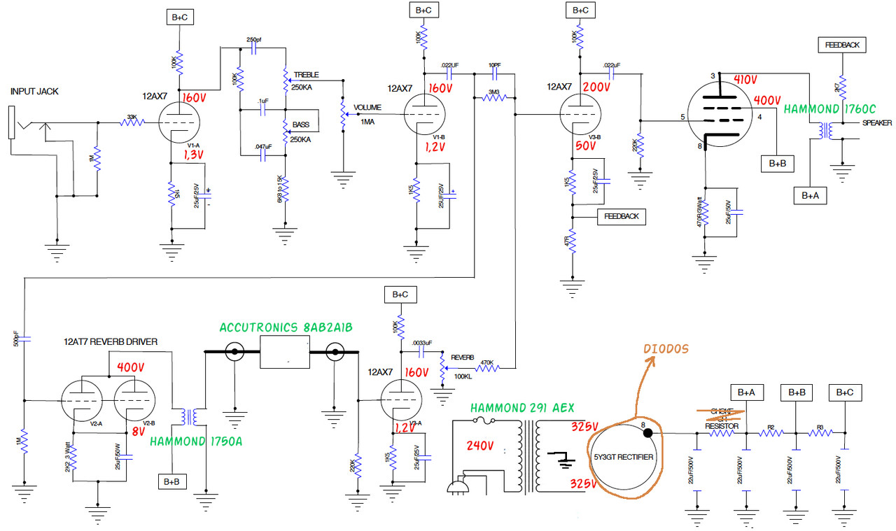

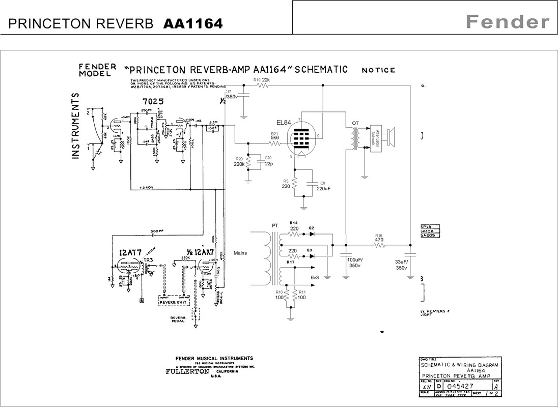

Do you think that such a combination could work? Logically studying changes in resistance values ​​mainly.
It would be the combination of Fender Pricenton preamp and reverb and Vox Ac4 power amp and source
  • Posts: 5234
Re: 5w amp scheme with reverb?
« Reply #6 on: August 23, 2022, 06:48:51 am »
Probably need to include the next gain stage from the PR.

My idea is to use semiconductors in rectification (diodes), EL84 as power and short reverb tank.
What PT do you use in this amp?

PT make and model # noted in schematic. Hammond 272BX

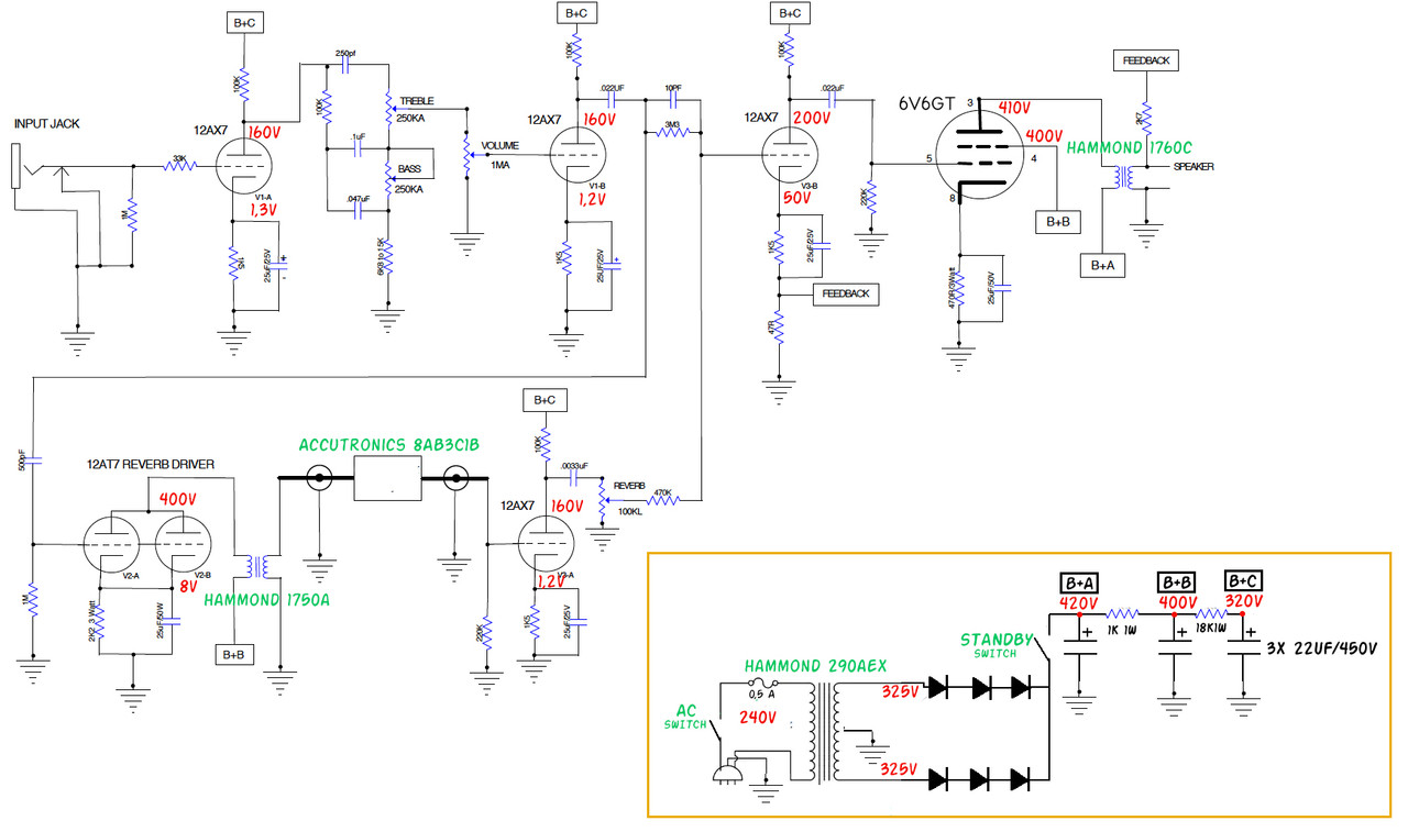

The 290UEX would work but it's overkill for a 5 watt amp. I would rather use the 291AEX.

I think I'll do that build, with those components. Do you think it could work well? Can I replace the choke with a resistor? Can I replace the rectification valve with diodes? Thank you
  • Posts: 5234
« Reply #26 on: August 28, 2022, 12:15:43 pm »
Do you think it could work well?  Yes. May need a little tweaking. I would use an 8AB3C1B tank.
Can I replace the choke with a resistor?  yes
Can I replace the rectification valve with diodes?  yes

Could this scheme be definitive? What diodes do you recommend?
  • Posts: 10313
« Reply #29 on: August 29, 2022, 04:47:22 am »
1N4007 diodes and Hoffman sells them.
325 x 1.4 = 455 volts     I think with solid state rectification you may get more than 420v on node A on the B+ rail?  My guess is that it will be higher than 420v?
420/1.4 =  300 volts   If you only want 420v on node A, you may wish to use a PT that is closer to 300-0-300 instead of 325-0-325?
OR use a GZ34   325 x 1.3 = 423v

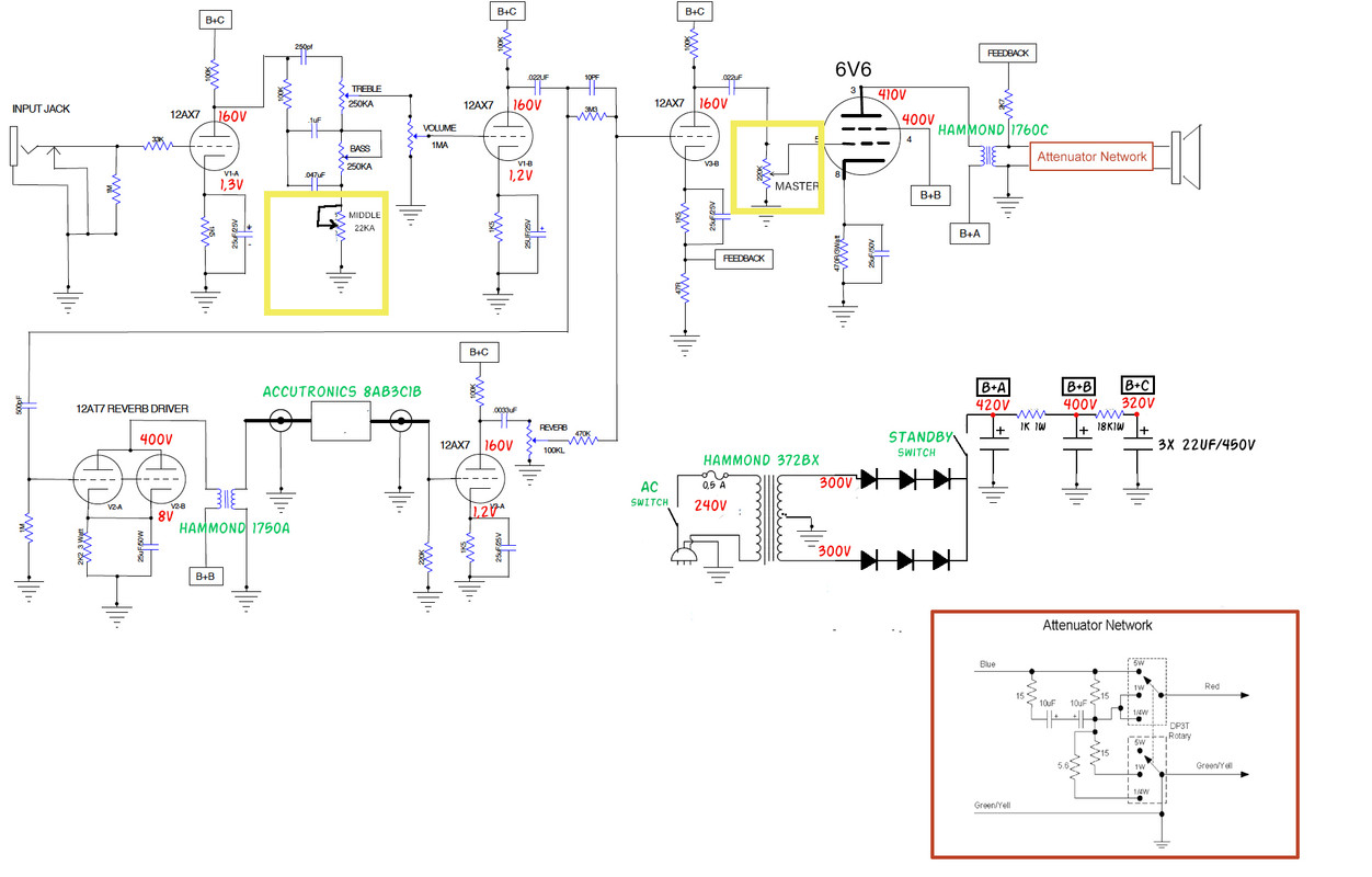

I have tried to use the same transformer as the one from Fender Pricenton. Do you know of a 300+300 (primary 240V) transformer model for a 5w amp with reverb?
I could maybe use a resistor between switch and B+A to drop those 20 volts.
20/100mA: 200 Ohm approximately. Would it work?

Do you think this transformer would be better?
 https://www.tube-town.net/ttstore/hammond-372bx.html

I have added two modifications (middle tone and master volume) do you think they can really be used to optimize this amp?

imho the master volume on a 5W amp is redundant
you have a volume on the guitar, you have a gain knob on the amp, one more pot will not be impressive.
most guitarist that played through my 5W'rs set the gain, then use the guitar to roll up and down the loud

That Vox attnuator circuit should make a MV pot useless.

« Reply #39 on: October 04, 2022, 01:00:55 pm »
I TOTALLY AGREE WITH YOU. My idea is not to reduce power.
What I want is to be able to give very little gain in the Master and a lot in the Gain with the idea of ​​creating a distortion.
40 years ago I did it on some solid state amp designs of mine and it worked.
But in valves it is the second montage that I do and I wanted to experiment.
Can distortion be achieved this way?

The 0.002uFd and 200k pot at the 6V6 grid cuts below 380Hz. 13dB down on your low note. That sounds pretty gut-less, no?
There's three gain stages and two loss networks. As I figure it, there's just-barely enough gain to distort the 3rd stage with small plucks. No gross distortion.
Well, that's the problem. What would be the proposed solution?
  • Posts: 11480
« Reply #42 on: October 04, 2022, 06:04:04 pm »
build the TS into the circuit, but don't wire it in, instead use a coupler cap to the gain pot top and the wiper feeds the next stage.  Your guitar will be the TS for testing.
the magic number I use in a self-biased amp is the Vk (cathode vdc).  I want my drive AC signal >Vk, maybe up to twice.  Then I'll tame it as required.

« Reply #43 on: October 05, 2022, 12:57:03 am »
Thank you!!
I understand that I should lower the Vk below the guitar signal to have distortion?
Would I have to lower the value of the Rk (1k5)?
Do you have a schematic please?
  • Posts: 11480
« Reply #44 on: October 05, 2022, 03:45:51 am »
Vk is your BIAS, set it for proper tube power with NO signal.
It's simply to compare your drive signal to
You raise the AC signal either with more gain or less drain on that signal.  the TS is a drain

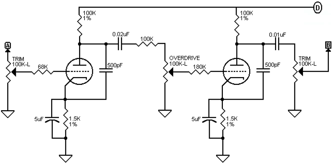

I'm thinking of introducing an optional circuit like this:
