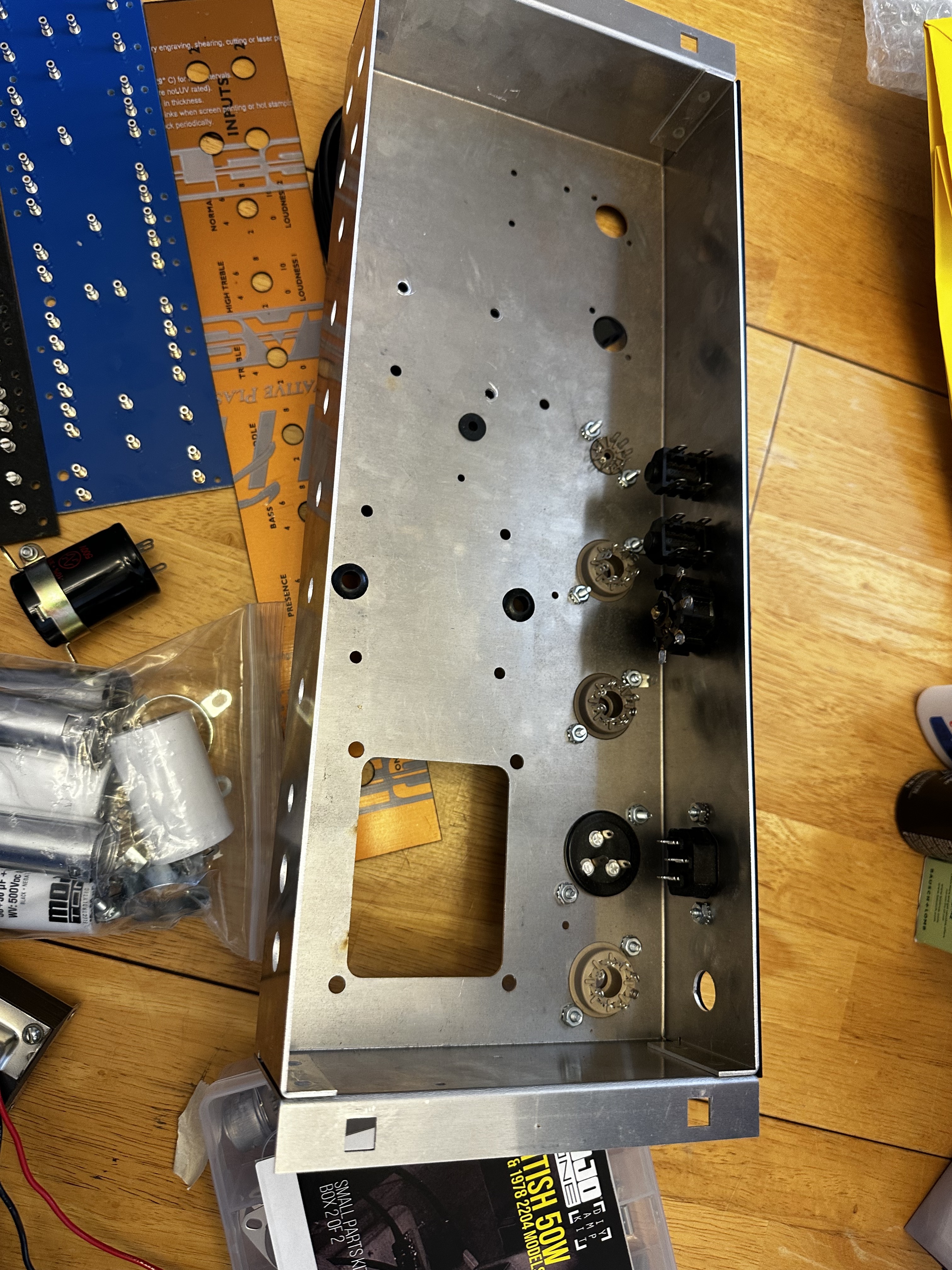

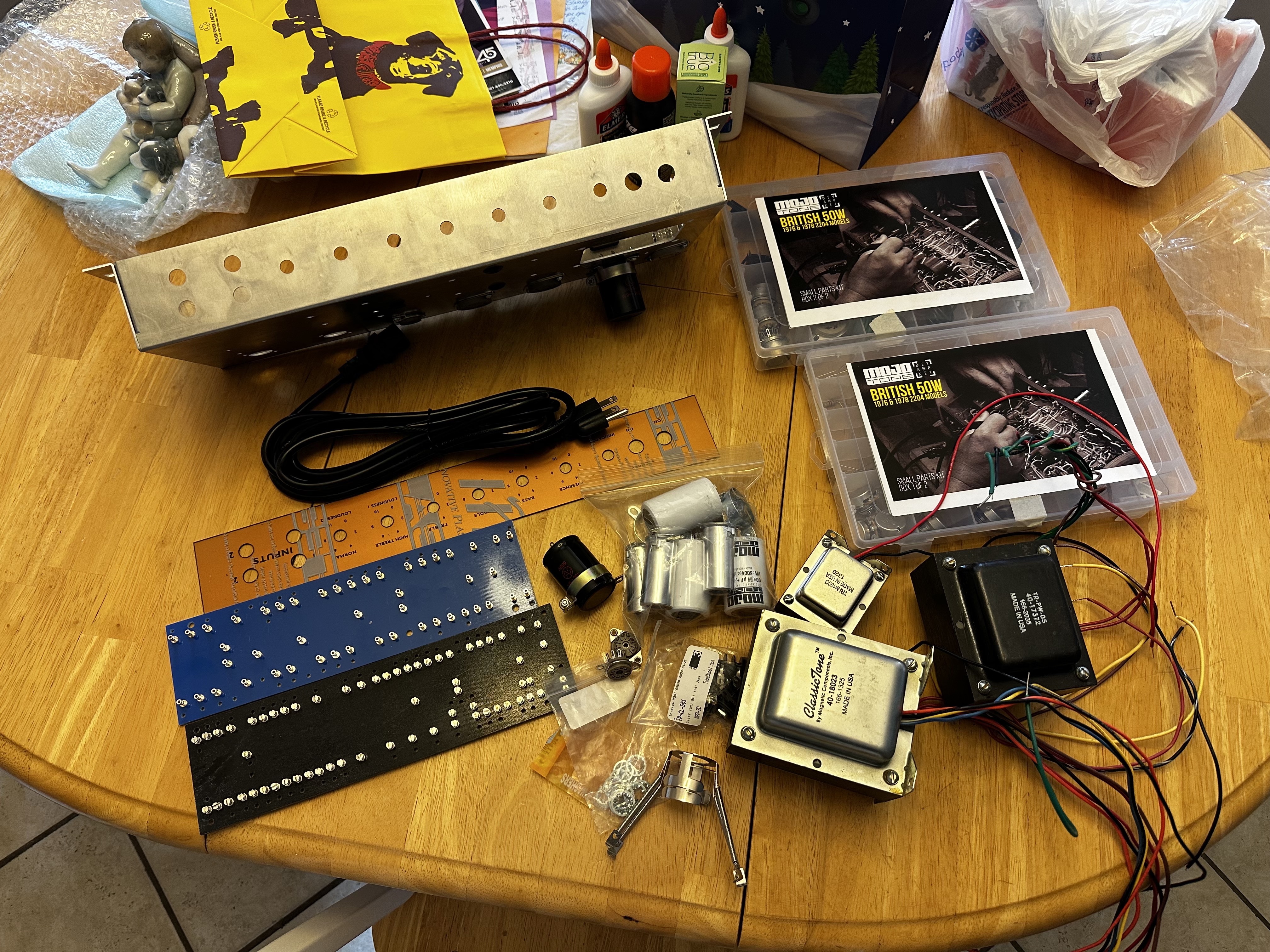

I bought this box of parts assuming that it was a complete mojotone british 50 kit but it looks like a got a lot of miscellaneous parts. I have what appears to be  a mojotone 45 chassis and faceplates along with a mix of classic tone transformers and other misc bits.  At this point i would like to build in to a plexi style amplifier. Ideally 4 input like a JTM45 or 59 style.
I was thinking of buying a hoffman board and kit of parts for a 50 watt and then some compatible tubes but will my transformers, pots, etc. work?

IDK.  Looks legit. Nice turret boards, quality parts, expensive USA made transformers.  A kit means you need to build the board first by soldering in parts.  Match up the parts available to whats needed to finish the
board.  If you are missing stuff or are not entirely comfortable with what you are doing--send it back.  If you search the forum for an amp technician listing ( https://el34world.com/Forum/index.php?board=27.0 ) and order a pre-fabricated board from him--he can help you with selecting an appropriate chassis.  Jim

I'm with Jim. That looks like you have all you need to build a very nice amp.  maybe build it as is first.

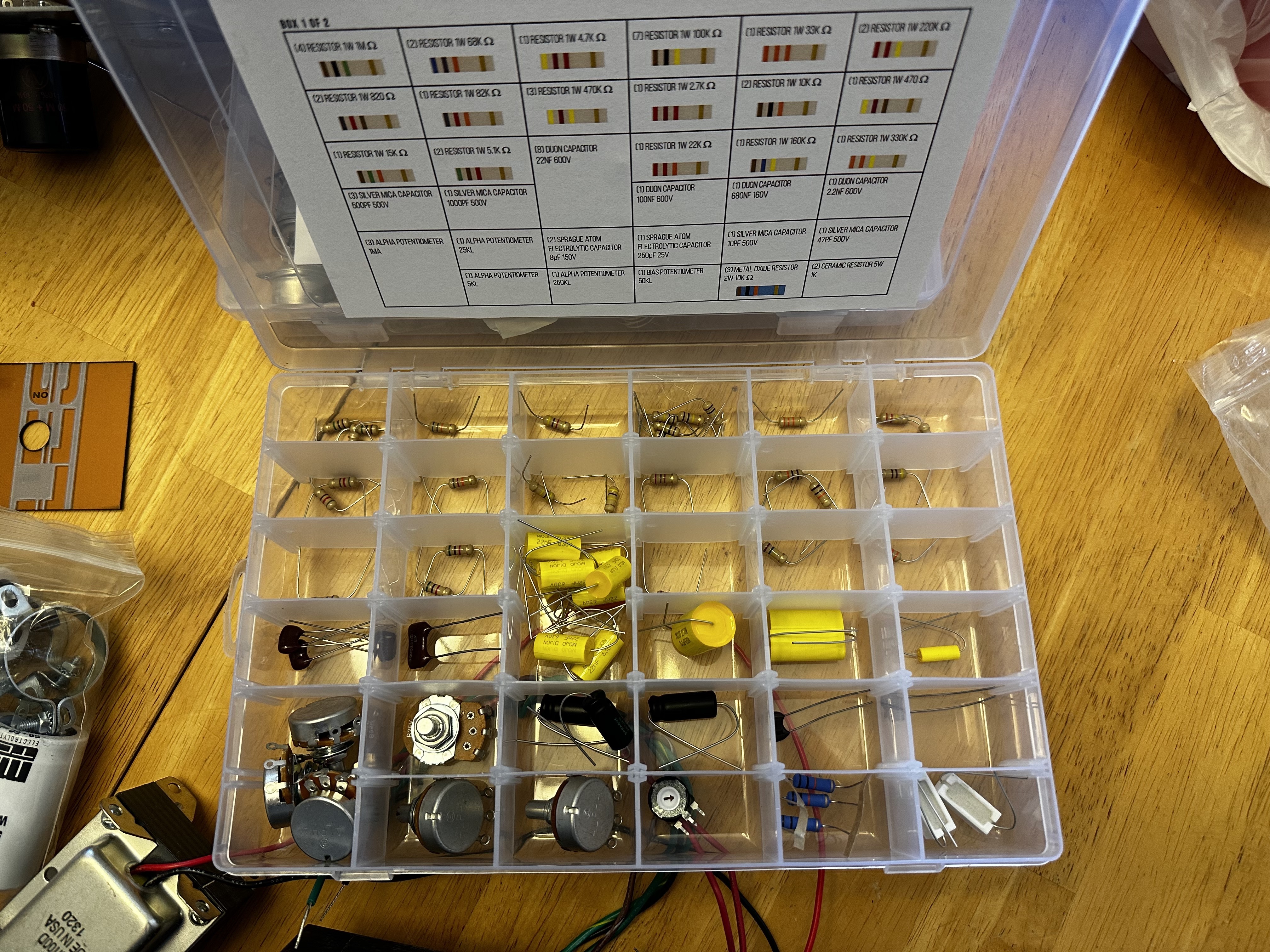

So you did not buy this from Mojo? Do you have a parts list? If not can you make a parts list? The transformers are the key - I think I have a spreadsheet with all the MC Classictone tranny specs.

The transformers are:
Output 40-18023 / 166-1325
Choke TRIM100D / 1320
Power TR-PW-05 / 40-17372 / 166-2035

Looks like you've already got most of what you need to complete the amp guts. Were there tubes in the box?

Let's have data.
Power (NOT output!!):
https://www.digikey.com/en/products/detail/tubedepot/40-18023/10487984
https://cdn.shopify.com/s/files/1/0357/4769/2679/products/IMG_1835_1500x1500.jpg
690VCT, 150mA (so 480V DC)
ANOTHER power transformer!!:
https://www.digikey.com/en/products/detail/tubedepot/40-17372/10487978
https://s3.amazonaws.com/tubedepot-com-production/spree/attached_files/tr-pw-05.pdf
Real similar/same-as above? (Check me.)
Choke (is a choke!)
5 henries at 120mA DC. 115 ohms DC
http://triodeelectronics.com/tri-m100d.html
That's all your iron? Then you need to get an output lump and can trade a power lump.

Attached is the Magnetic Components spreadsheet I mentioned.
You do not need it now, as you now have the data for the iron, but others may find it useful.
If you are game to move forward, I'm sure this Forum can get you there - you have some good parts. The chassis you have is set up for a laydown PT and the one you got hopefully fits. It seems its a JTM-45 spec.
Hoffman's instructions on this site are great. And some kit instructions post downloadable instructions.
A parts list and what you want to build will allow you to fill in parts gaps - including the OT. You will have multiple options.

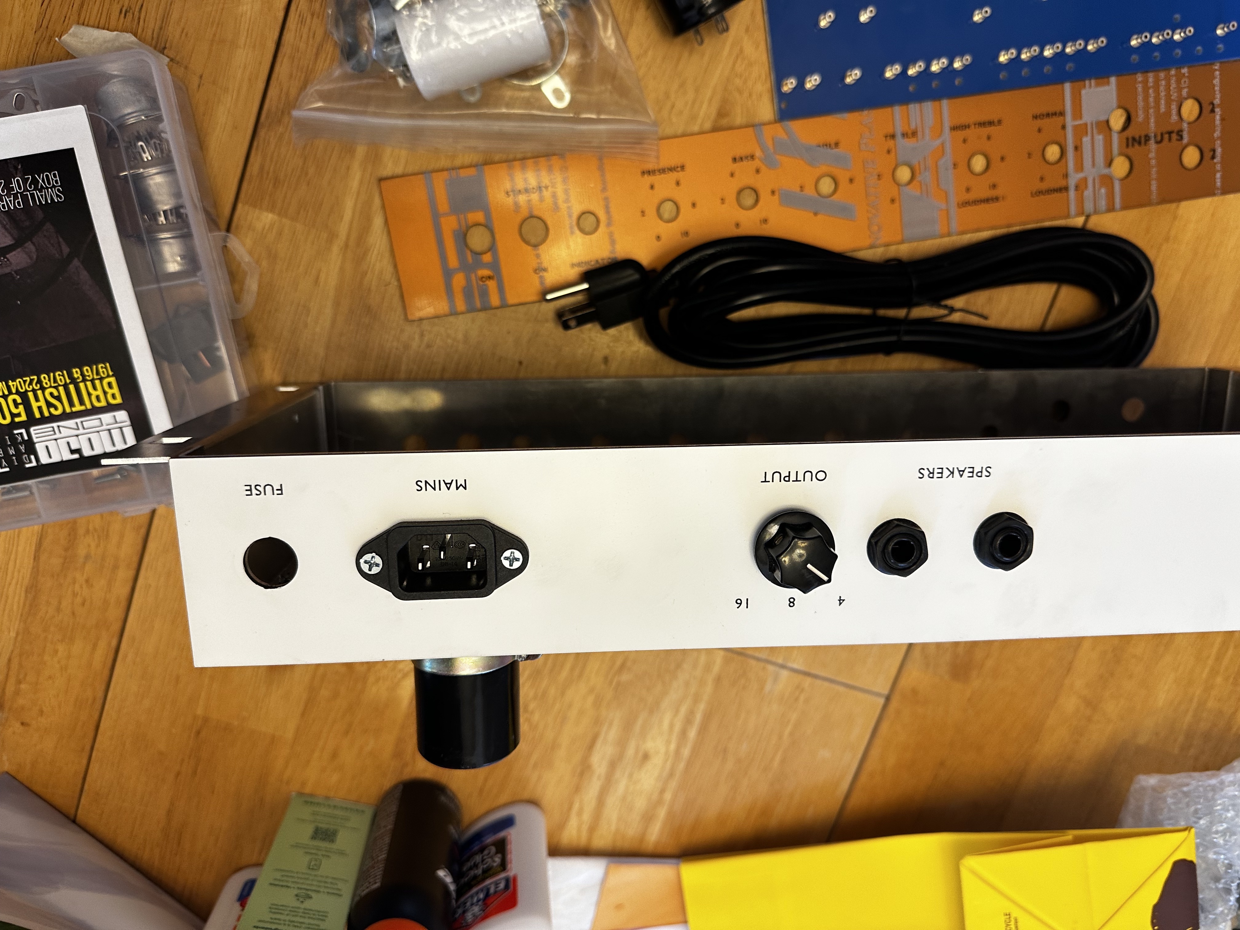

Thanks everyone for the help. This helps me sort out what I have. It looks like either way I got I am going to need to buy some parts.
JTM45 build
JTM45 Style Chasis
TR-PW-05 Power transformer, "laydown" mounting, for Marshall style JTM45/50 amps.
Wiring board (possible JTM45)
Missing output transformer, choke, tubes, all other parts
JMP 2204 Build
Mojotone parts kit for JMP 2204
Classic Tone 40-18023 PLEXI/JCM800 50 WATT PWR TRANS
Choke TRIM100D used in Marshall 50 & 100 Watt Plexi & JCM 800 Amplifiers.
Mojotone Wiring board
Missing chassis, tubes, output transformer

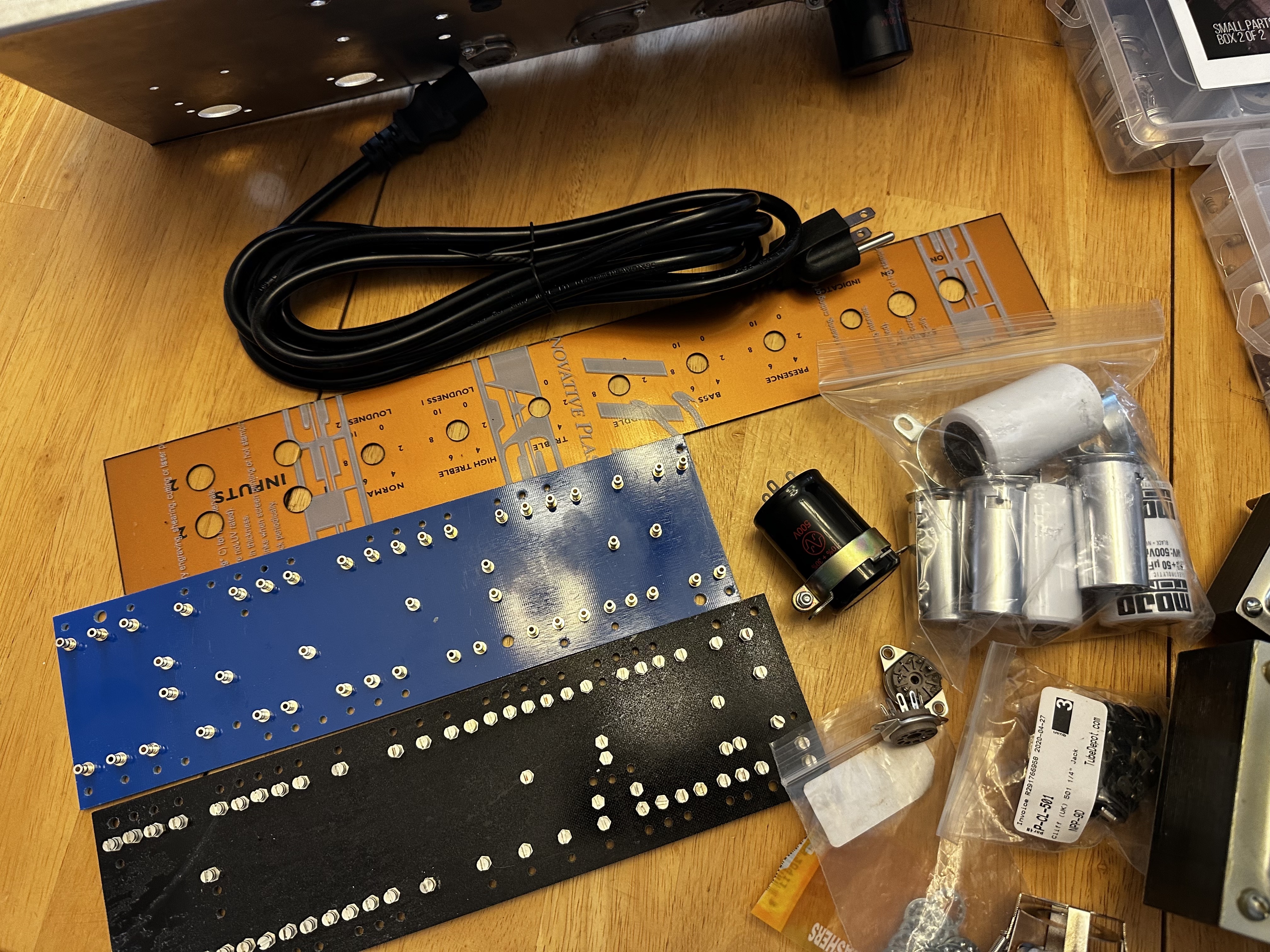

You have two turret boards (wiring boards) If you look up layouts you can match them - different suppliers layout the boards somewhat different, but its easy to figure out. Hoffman, Mojo, Ted Weber, Trinity, Ceriatone, etc. all post layouts of 45/50 Marshalls, I believe.
And - you have a choke, tube sockets, capacitors, faceplate, resistors, jacks. You are not going to need much besides that OT - and some studyin' and patience.

heres a layout for comparison to your boards
http://site.triodestore.com/JCM8002204Stock.pdf
