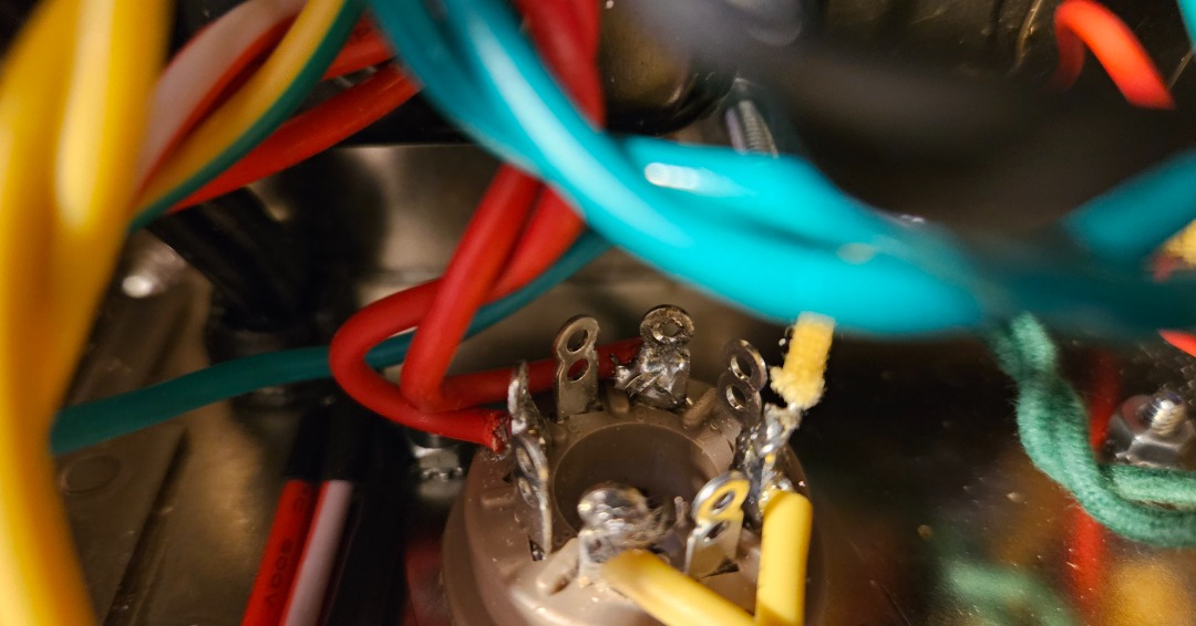

« Reply #3 on: April 04, 2023, 01:46:41 pm »
Here is the fuse connection
Offline mmilo
  • Posts: 3
Re: Amp starts and no sound
« Reply #4 on: April 04, 2023, 01:49:27 pm »
Rectifier
  • Posts: 10676
« Reply #5 on: April 04, 2023, 02:49:58 pm »
Use these instructions and look at everything
https://el34world.com/Hoffman/instructions.htm
