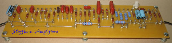

![]() A Hoffman Turret board |
This is the order of events on how I build amps from scratch (1) Install and wire up all the basic infrastructure connections (2) Install the board with no parts on the board (3) Install the pots and input jacks (4) Install the parts on the board (5) Wire up the pots to the board (6) Turn on the amp, bias the power tubes and enjoy The events above are all explained further down this page |

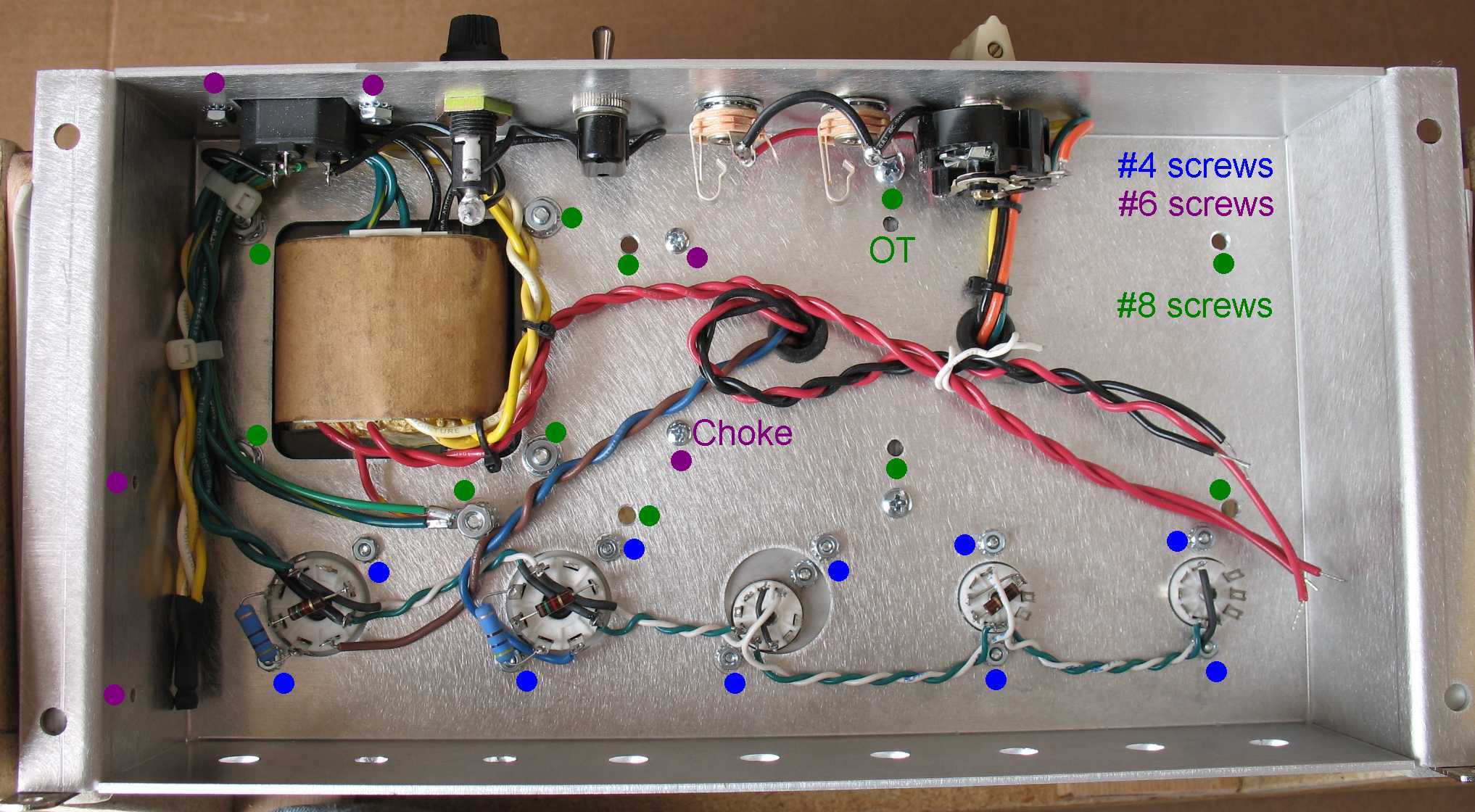

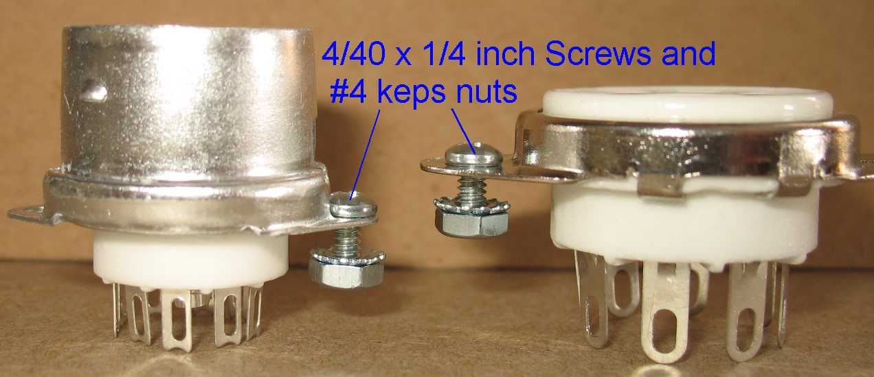

| I use 4/40 x 1/4 inch long screws and #4 Keps nuts to mount the tube sockets Some tube sockets have undersized mounting holes These need to be drilled out a bit larger for #4 screws Use a 7/64 inch drill bit for #4 screws |
| Screws and Nuts information #4 screws are .108 inches in diameter - Use a 7/64 inch drill bit #6 screws are .132 inches in diameter - Use a 9/64 inch drill bit #8 screws are .158 inches in diameter - Use a 11/64 inch drill bit #10 screws are .186 inches in diameter - Use a 13/64 inch drill bit I stock screws, nuts and washers on this page Screw uses for common chassis and parts holes Use #4 screws to mount tube sockets Use #4 screws for tube socket adapter plates Use #6 screws for capacitor clamps Use #6 screws for IEC receptacles Use #6 or #8 screws for chokes Use #6 screws for small output transformers Use # 8 screws for Large Output transformers Use #8 screws for Power transformers Use 8/32 x 5/8 inches long screws for your main ground screw by the power transformer Use 8/32 x 5/8 inches long screws to mount the boards when using 1/4 tall standoffs Use #10 screws and Rivnuts to mount the chassis Use oversized fender washers to clamp something to get a larger clamping area See the image below for color coded screw info |

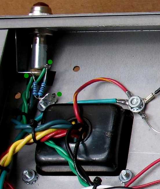

| In the image above, the green filament wires go to the lamp assembly first and then to the last power tube The two 100 ohm resistors go to each terminal on the lamp and then they are twisted together and go to a ground lug |
| The picture above shows the two 100 ohm resistors on the board hooked up to the main filament string If your board has two 100 ohm resistors on it, solder a green wire from each 100 ohm resistor, twist the wires into a nice twisted pair, then go to the nearest tube socket. Solder the twisted green wires to the filament connections on the back of the tube socket Power tubes usually have more room to add wires and so I usually use a power tube socket to connect to the two 100 ohm resistors |

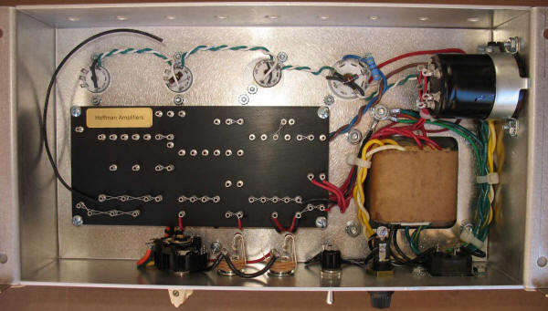

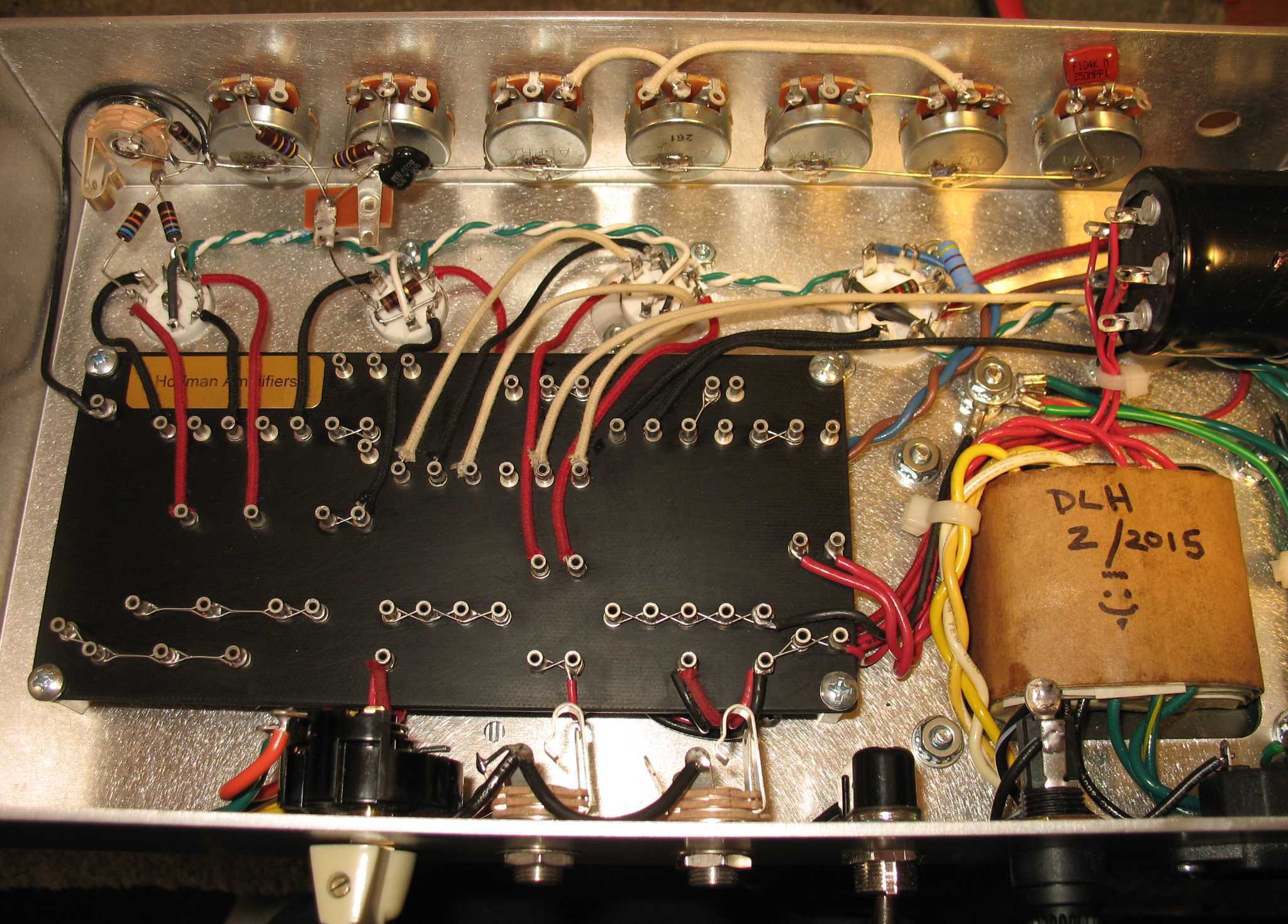

| The board has been mounted in the amp after all the infrastructure wires have been connected Notice the Chassis ground screw near the power transformer All the major grounds go to this point using soldered on #8 ring terminals The power transformer in this image has a filament center tap wire (green with yellow stripe) The red filter cap wires have been wired to the board in the image above The black ground wire at the right end of the board has been connected to chassis ground I like to use 18 gauge stranded PVC wire for the impedance selector, speaker jacks, power switch and fuse holder connections |
Detailed info on how to mount the Turret Board in the amp chassis: Place the circuit board inside the amplifier where it will be installed. Decide where you want to have your board mounting holes. Drill the mounting holes in the board. After the mounting holes have been drilled in the board, use a sharp object or a pencil to mark the location of the mounting holes on the chassis. Look under the chassis to make sure that you are not going to be drilling into an object such as a transformer. If the mounting holes happen to be where a transformer is, then you can either move the transformer or change the mounting hole locations on the board. It's a good idea to plan your circuit board mounting holes carefully before you start. It's easier if you are starting with a blank chassis. Make sure there are no screws sticking up under the board that are tall enough to touch anything on the bottom of the board. Remove the board and use a punch to mark where the mounting holes will be drilled in the chassis. Punches work better if you use a piece of wood on the backside of the chassis as a solid backing support. Drill the mounting holes in the chassis using a 3/16 inch drill bit for #8 sized screws. The bit should be just slightly larger than the mounting screws, so it will be easier to position the board. Mount the board into the chassis using #8 Screws, Keps Nuts and Standoffs. If you are also installing transformers, you may want to install them first if any screw heads are going to be under the board. It will be difficult to install a transformer later if the screw heads are under the board. I suggest having the transformer screw heads under the board and the nuts on the outside of the chassis. You do not want any screws coming up and shorting out things on the bottom of the board. Use some Loctite on the transformer mounting nuts so that they do not come loose. I remove the board at this point and do all the infrastructure wiring that I mentioned up above. |
Lacing up and soldering the turret lugs: I do all the lug lacing and under the board wires after I have figured out where the board will be mounted and drilled all the board mounting holes in the chassis I like to install the boards with no components on the board and then add the components after the board has been wired up. It makes for a much cleaner installation and it's easy to clean off solder flux spots before you install the components. It's easy to mess up or bend installed component leads if the parts are already installed on the board and you try and wire it up. It's up to you on how you prefer to do the install. This page has a video on how I lace up and solder turret lugs |

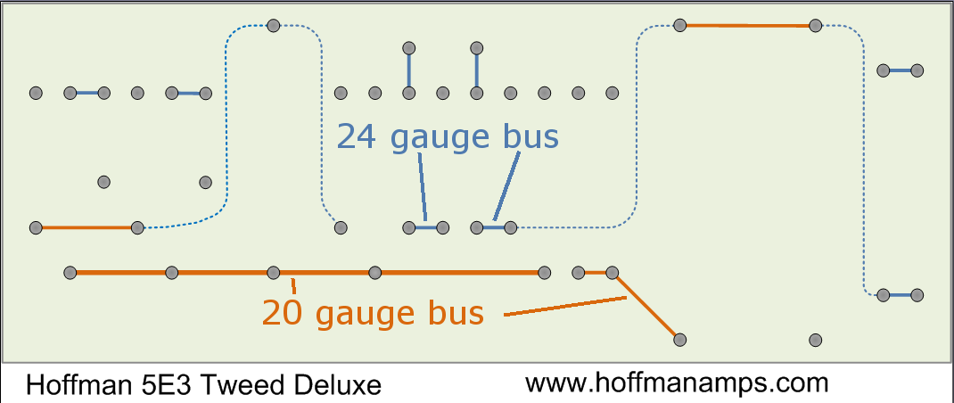

Lug lacing wire tip: I like to use 24 gauge bus wire for most of the shorter lug spans For longer lug spans, power rails and ground bus runs, I like use to 20 gauge bus wire For example: in the image above, the 24 gauge is the blue wire and the 20 gauge is the orange wire |

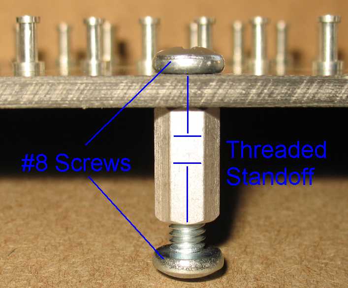

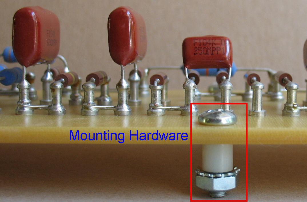

![]() Board mounting method #1 The screws in the image above are #8 screws and are 5/8 inches long. They are the perfect length to go through 1/8th inch thick board material, through a 1/4 inch tall standoff, through the chassis and still have some threads showing I use #8 Keps nuts and #8 standoffs. Standoffs can be threaded or no threads, it's up to you. This method works well for boards that can be very close to the chassis surface. |
| Board mounting method #2 The other method I use is to raise the board up off the chassis a bit using taller standoffs I do this on some builds because there are transformer wires or tall screws coming into the chassis under the board and you need more space under the board Make sure your mounting screws are not too long If two screws meet and touch inside the standoff, you will not be able to tighten down the screws. In the picture above I used a 1/2 inch #8 threaded standoff I normally use #8 x 1/4 inch screws on the chassis side and #8 x 3/8 inch screws on the board side It does not matter as long as you make sure the screws are not too long You also need to make sure the screws are not too short so you have enough threads engaged on the screw |

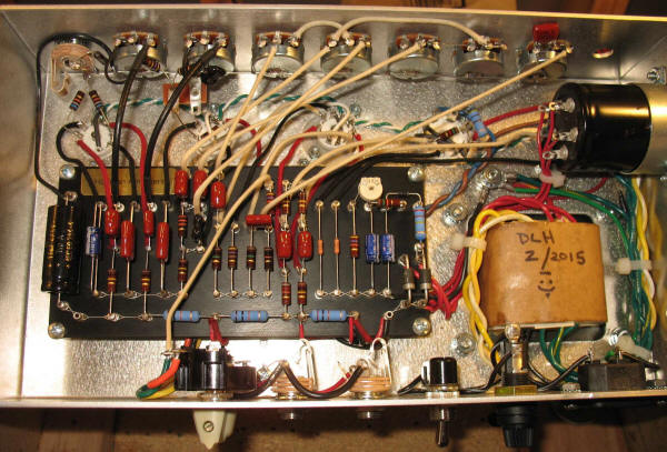

| Add the parts to the board Look how nice and neat everything because you waited to install the parts at this point in the build No bent component wires, no flux blobs all over the board |
| Install the parts on the board: Here's where you should take your time and do a really nice neat job. Bend all your component leads nicely and insert them down into the turret lug holes Add a tiny solder domes to the tops of all the lugs that do not receive wires from the pots. You will wire up the pot wires last and so you do not want to close off the turret lug hole now. Look at your layout diagram as you go so you only solder the parts that need to get soldered now If you have two or more component wires in a lug hole and things are a bit tight, you can take a very sharp pointy tool and poke it down into the lug hole to expand it a bit. Rotate the sharp pointy tool a bit in order to make more room for other components leads |

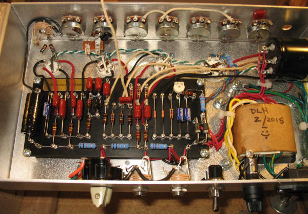

| The pot wires have been installed The feedback wire is the white wire that goes from the rotary impedance selector switch to the board |
| Connecting the pot wires: Connect each pot wire from the pot to the board using white wire. Strip one end of the white hook up wire and solder it to the pot tab and then find the location on the board where the wire will be attached. Cut the wire as short as possible leaving just a little play in the wire. Strip the end of the wire and insert it into the hole in the top of the lug. The wire will be in the same hole with a component. Solder the top of the lug carefully using just enough heat making a small solder dome A thin sharp soldering iron tip is a big help when doing fine soldering like this. TIP: You can expand the lug hole by inserting a tiny pointy tool into the hole. Hook up the feedback wire if you have one. Solder a white wire to one end of the Feedback Resistor lug and solder the other end to the speaker tap you are going to use. Some wires leaving the pots may be RG174 shielded cable, look at your layout diagram. The cable shield must be grounded at the pot end of the wire. The other end just has the center conductor sticking out. |

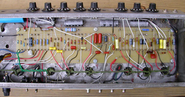

| Here's an example of a Hoffman Turret board installed in an old junked out Fender chassis Notice how I run my filter caps and avoid having to use a cap board and cap can. |
