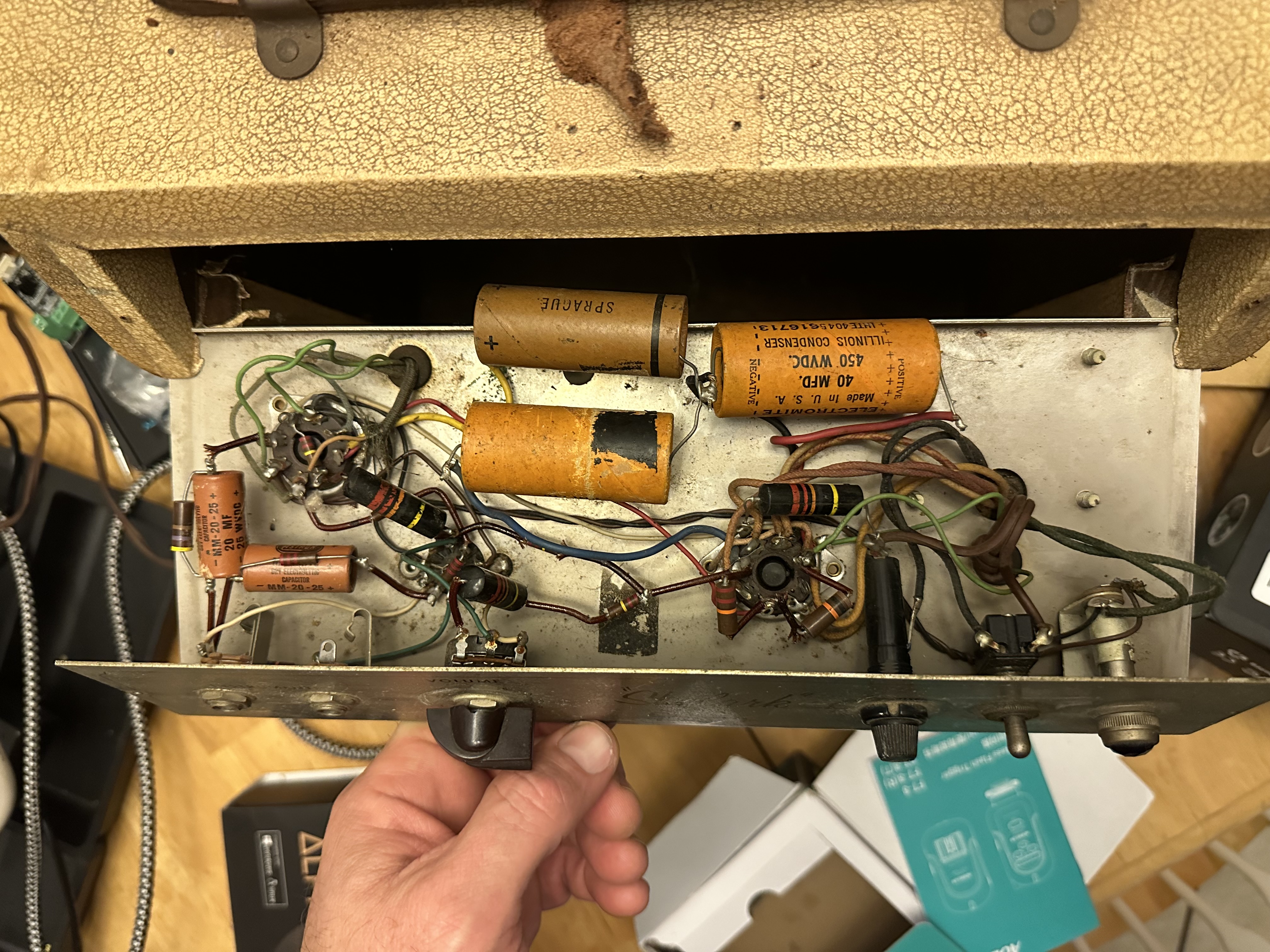

I bought a gibson ga5 from a local guy.  I cleaned it up a bit and brought it up on a variac. It worked to my surprise. I am planning to order the mojotone ga5 small parts kit to recap and replace the two prong cord with a grounded cord.
At some point someone added an interesting 6snwgt tube based tremelo circuit to the amp. This has two knobs which I assume are depth and speed. The speed seems to work although the depth doesnt seem to do anything other than make the amp hum if turned to 100%. It appears that this unit draws power from the 6v6 heater and then returns the signal back to the rectifier tube.

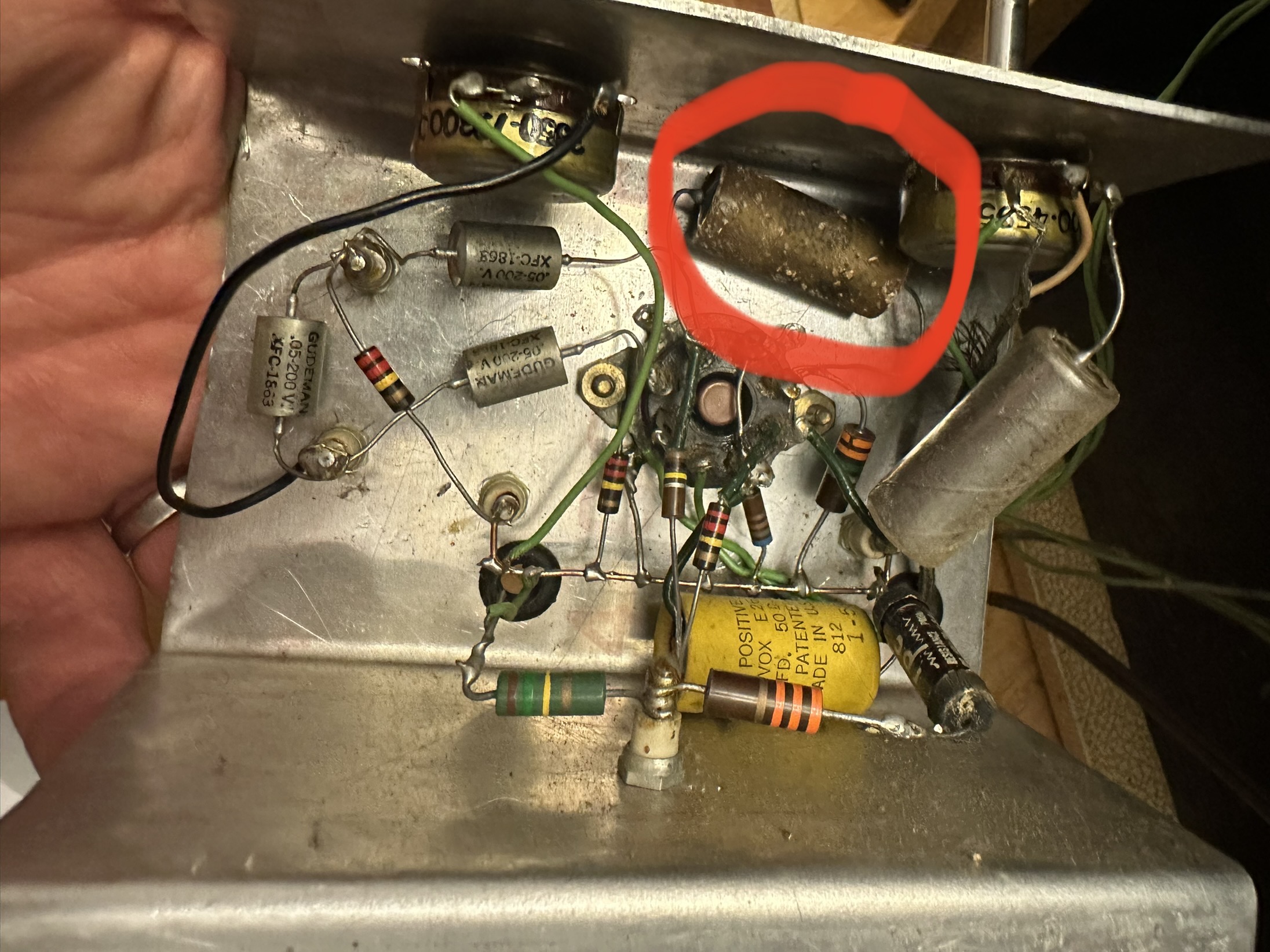

I will probably leave this unit in the amp and wanted to recap it and maybe replace the pots. I can read most of the values but there is one cap i cant read.
Does anyone have a schematic for this modification? Any explanation for how it is supposed to work?

Whoever built that had access to high quality caps, pots, standoff turrets, etc., and was familiar with military point to point wiring techniques. It is unlikely that those silver caps are bad. They are higher quality than any replacements you might use. I suggest to leave them alone. That yellow filter cap is the only cap in that unit that may need replacing.

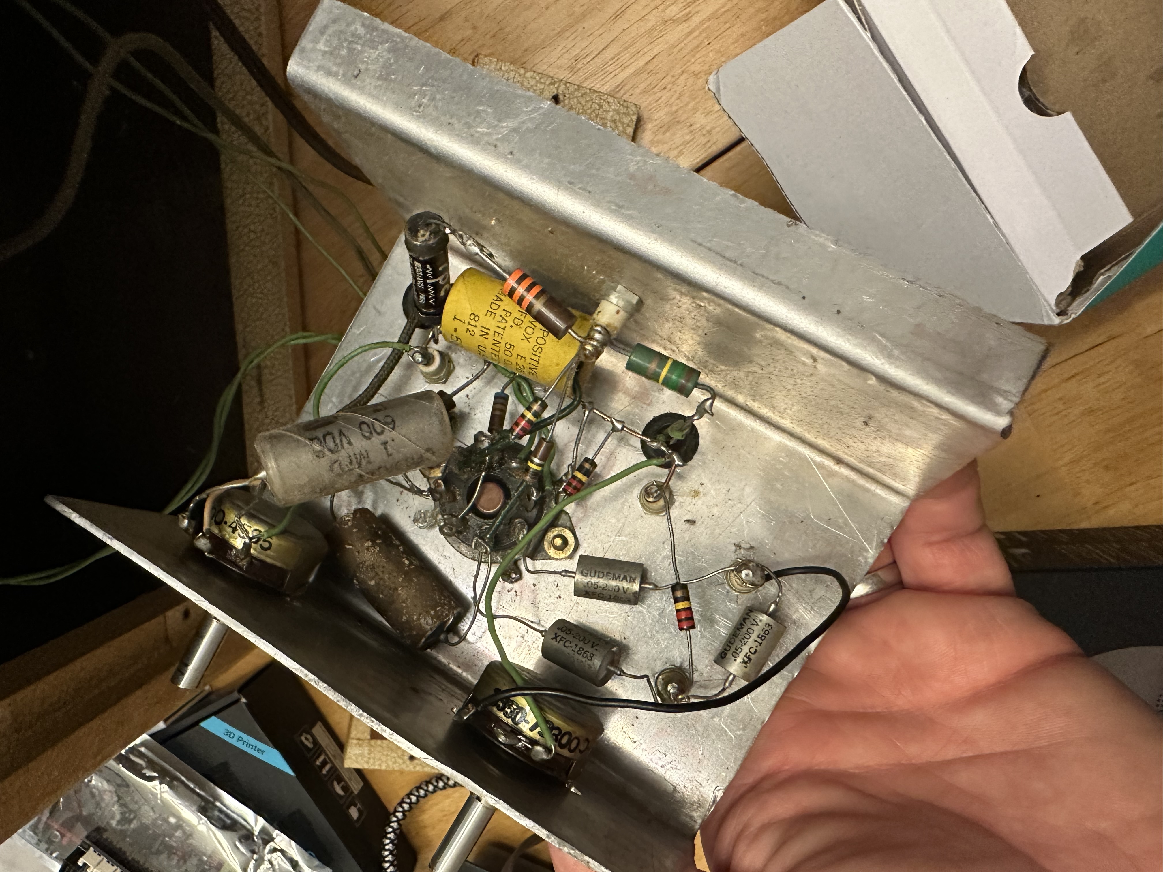

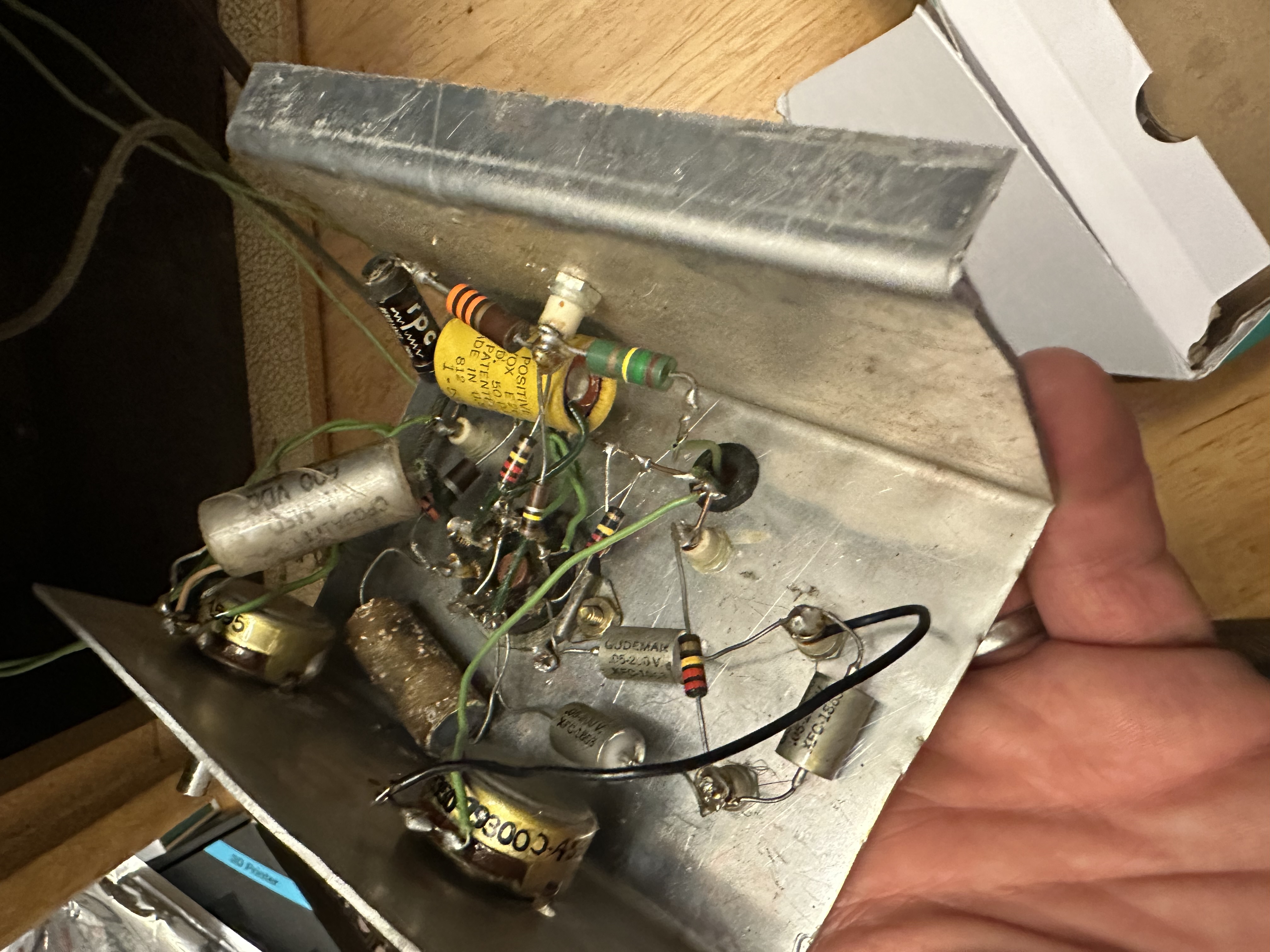

The circuit is likely a typical phase shift oscillator. With a big hi-res pic I could probably draw the schematic for the small chassis. But, I still need to see exactly how it is connected to the GA-5. The unit needs filament and B+ voltages from the GA-5 just to make the oscillator work. Then the output of the oscillator has to connect back to the amp. So, I would expect at least 5 wires between the two chassis.
Tell us more and post some big hi-rez pics, not those small 480x640 pics.

Thank you for the reply. I can read the yellow one but there is one that is moldy or something that i cant really read.
It looks like power leads come in off the filament on 6v6 and then the output goes back in to the 5y3.

  • Posts: 5401
Re: Gibson skylark ga5 with an external tube tremolo questions
« Reply #4 on: July 18, 2023, 12:47:38 pm »
See if you can roll the cap over enough to see more writing.
The wire connected to the 5Y3 is the B+ being sent to the tremolo unit. It is not the tremolo output. There should be at least one more wire between the two chassis.
Still waiting for hi-rez pics of the tremolo chassis.

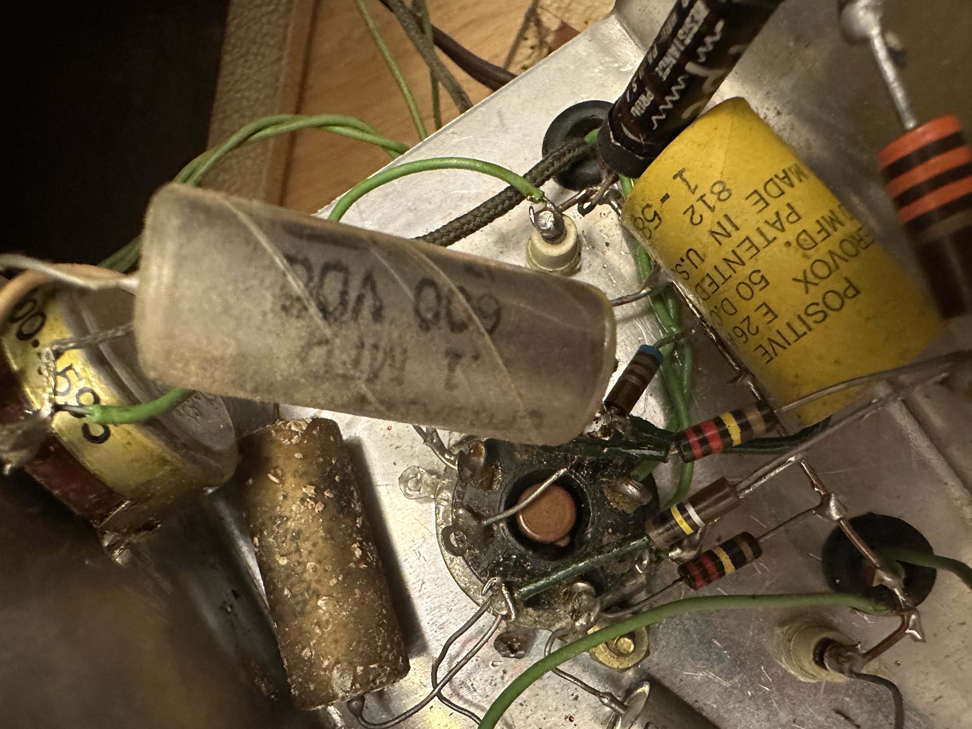

I'm pretty sure the moldy crud is just on the plastic cover for that one cap. Use a utility razor knife to cut the plastic cover off that moldy looking cap. Then you should be able to read the value on the metal body of the cap. Removing that plastic will not harm the cap.
  • Posts: 7942
« Reply #8 on: July 19, 2023, 07:47:41 am »
If you dismant that cap from the circuit it seems (from the photo) that you can read something, just try to read and make a note before to procede to skin it
That to be sure you save the more data you can, if happened a transfer from the metal to the plastic of the label this will help you to prevent data loss

Here's the schematic for that tremolo chassis. I guessed .1µF for the value of the dirty cap that's connected between pins 2 and 4. It should be very easy to move that cap up to see the value printed on the underside of the cap.
I also guessed 50µF for the big yellow Aerovox cap. Just roll the cardboard cover slightly to see it's printed value.
edit... updated schematic
Thie is awesome. The aerovox is a 20 MFD/50VDC. The other two a .1MFD 600V. The pots are .5 meg.

I don't think that 20uF versus 50uF would make a lot of difference. The idea for that bypass cap is for the cathode to be "fully" bypassed so that the oscillator will oscillate at its maximum. 20uF should do it, 50uF probably wouldn't be noticeably different. Some might argue that removing it and the resistor and replacing with a single LED would be optimum.

Is this black resistor 1 Meg or .1 Meg?
  • Posts: 11613
« Reply #18 on: July 19, 2023, 04:24:22 pm »
looks point 1 from here

« Reply #19 on: July 20, 2023, 09:55:44 am »
Yes .1 is correct.
  • Posts: 5401
« Reply #20 on: July 20, 2023, 10:24:06 am »
Yes .1 is correct.
OK. I updated the schematic in reply #14.
