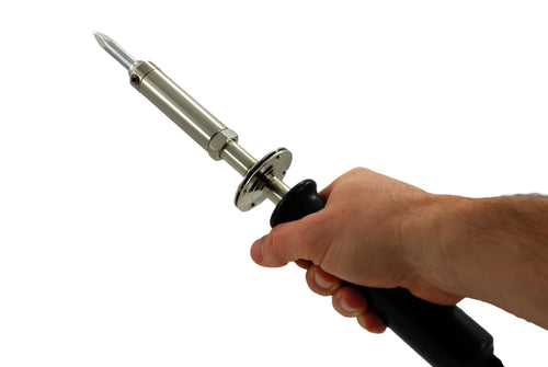

The pots aren't the only thing soldered to that brass plate, right?  Do you also see where there are wires from "ground eyelets" on the fiberboard also running to the brass grounding strip?
This is about expediting production:
   - There are places over near the power transformer that get soldered to the chassis.
   - Soldering to the steel chassis requires a 150+ watt iron, that's about 10x as big as the iron used to solder eyelets or pot lugs.
   - The big iron for soldering to the chassis can't fit in/around pot lugs without burning wires.
   - Fender soldered the eyelet board & pot wiring to the brass strip outside of the chassis.
   - This prevents the chassis from acting as a heatsink, and requiring the big 150w iron.
   - The board, brass strip, pots, etc, all get loaded into the amp at one time, and then the fiberboard is wired to the sockets.
   - Ultimately, the pots sit at a point in the circuit, and would ideally ground at the "ground of that circuit."
   - The brass strip is an approach towards this ideal.
   - Random-grounding on a chassis is generally less-good, though you might not notice outside of high-gain amps.
