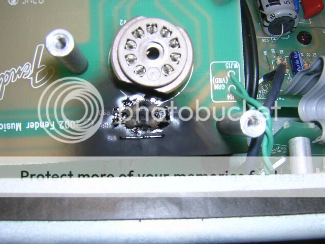

"Brunt" carbon comp resistors literally burn (like this and this), which is why those metal oxide resistors are called "flame proof."
