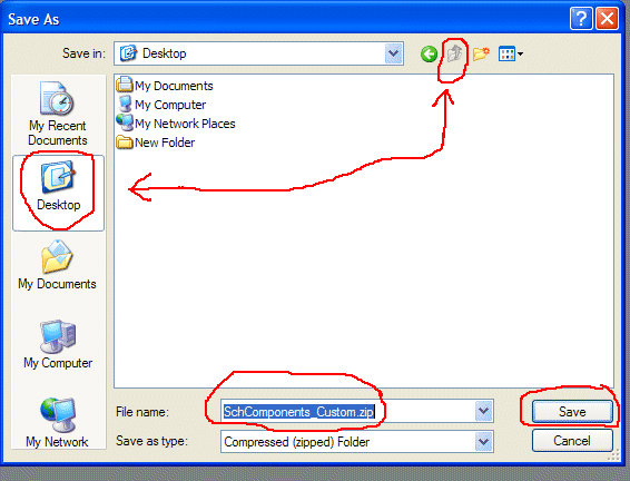

Here's my component file.
Custom sch components
Download this zip file.
Unzip it into your ExpressPCB folder.
The next time you open Express Sch, click on the components manager button and then tick the custom components box to see all the new symbols.
If the SchComponents_Custom folder does not exist, it will be created when you unzip it.
If you already have a SchComponents_Custom folder, just add the files into your folder
Put all the component files in this folder.
Click on the picture of the desktop or navigate to your desktop with the up arrow at the top of the box.
Click Save after you have chosen your desktop as the save location.
« Last Edit: August 09, 2014, 12:17:53 pm by EL34 »

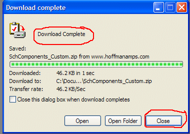

  • Posts: 10661
The file will download to your desktop.
Click Close after it is done downloading.
« Last Edit: August 09, 2014, 11:52:15 am by EL34 »

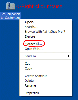

  • Posts: 10661
Go to your desktop and then right click your mouse on the SchComponents_Custom.zip file icon.
A dialog box will open.
Choose Extract all
« Last Edit: August 09, 2014, 11:52:28 am by EL34 »

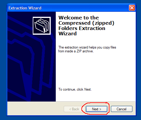

  • Posts: 10661
Click Next
« Last Edit: August 09, 2014, 11:52:41 am by EL34 »

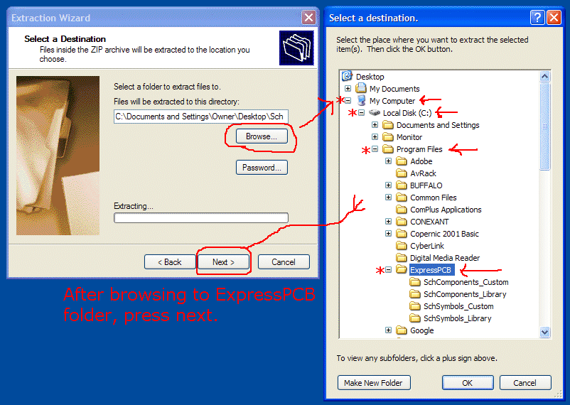

The dialog box on the left opens first.
Hit the Browse button.
Browse down to the ExpressPCB folder using the image on the right as your guide.
The ExpressPCB folder should be highlighted just like in the picture.
Press the Next button.
« Last Edit: August 09, 2014, 11:52:58 am by EL34 »

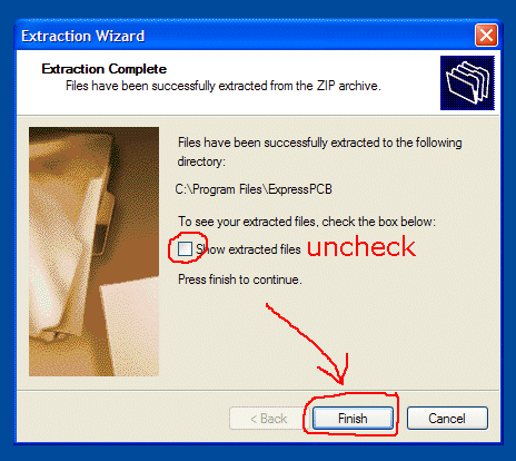

  • Posts: 10661
The SchComponents_Custom folder is now extracted under the ExpressPCB folder.
If you did not have the folder, it is created there.
Uncheck the Show extracted files box
Click Finish.
If you already had the SchComponents_Custom folder, you will want to extract the zip folder and then move all the files inside into your SchComponents_Custom folder.
The next time you start the Express SCh program, there will be a bunch of new custom components.
« Last Edit: August 09, 2014, 11:53:15 am by EL34 »
