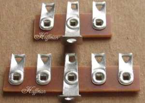

Two alternate views of the PS.  The cap in the middle of the pics is C5.  C6's NEG was attached to C6's POS side, and one of two leads from the transformer was attached to this.  I have snipped the bus between them, and that's how I got the 60VDC on B+.
Also the rest of the build.  Some is messed up as I've pulled apart stuff to test...

Diodes are good.  C5 looks burnt on the end.  It's really too close to that turret IMO.  Measure with VOM.  It should NOT read short.
Yeah, that's me soldering and unsoldering the power lead for tests.

Offline RicharD
  • Posts: 2057
    • Toxic Water
Re: Alembic F2-B Pre-Amp Restoration project
« Reply #132 on: March 23, 2010, 10:48:39 pm »
I recognize the style you're emulating.  It begs for trouble.  Have a look at the attachment.  I tried to accommodate your existing chassis config, but you're gonna hafta move the tubes.  I didn't draw the PT or line supply.  What you got is fine. Separate chassis grounding point for the power cord.  Keep the filament wires as far away from everything else as humanly possible.  I didn't draw a balanced output.  Get a couple of extra tag strips for that.  Pay close attention to the grounding scheme.  No extra wires.  No need for a #12 ground bus.
Offline oatmeal769
  • Posts: 79
« Reply #133 on: March 23, 2010, 11:31:19 pm »
That certainly looks a WHOLE lot easier...
I'll see if I can pick some strips up tomorrow.  If not, I'll get some from Hoff.
Other than to mount the tubes outside the chassis, (Thus defeating the single rack space) I don't know where else to put them.  I need the clearance above them to remove/replace.  I can't really go to one side or the other, there's the PS on one side, and the upcoming OT on the other.  I think I could replace the tube mount board and get the sockets all the way on the back side of it and still have just enough clearance.  I can also run longer filament leads, maybe along the back wall and then straight in.
I think if I get rid of my 10 GA. ground thingie, I could mount a row of tag strips, and go directly to the pots / input jacks from there?
You know, I'm having so much fun with this... :laugh: ... Do you still have the circuit boards you had made for the bass pre-amp you designed?  I think after this torture, I'll be ready for something even more painful, LOL.  If so,  how much would you want, and do you know an approximate component cost?
Offline RicharD
  • Posts: 2057
    • Toxic Water
« Reply #134 on: March 23, 2010, 11:40:44 pm »
You could prolly turn the audio section 90 degrees and make it it.  The tag strip area is roughly 2.25" x 6".
I have 1 unpopulated board left.  I can't remember what the BOM priced out at but it wasn't cheap.
