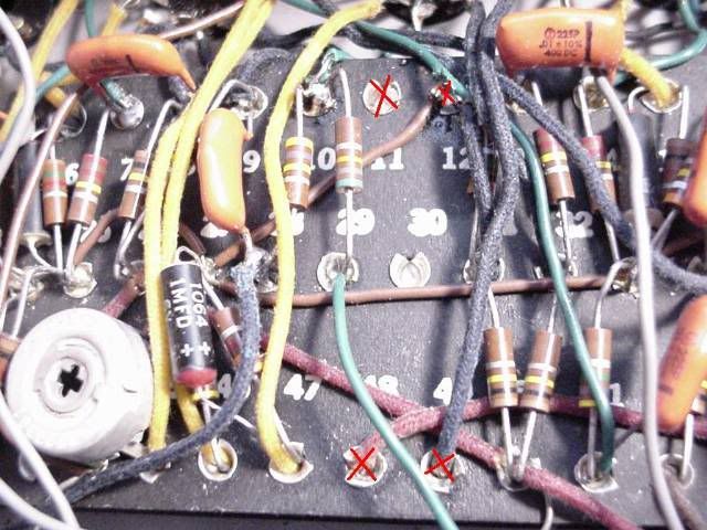

I have a Gibson GA 35 RVT amplifier. After warmup i switch off standby and the volume is strong for 10 seconds and then dies out real weak. I at first thought this to possably be a preamp tube. All the tubes including the 7591 power tubes are excellent in there readings
I clipped a lead to the OT CT and then measured the OT primary leads one at a time
I get 113.4 ohms on one primary lead and 131.5 ohms on the other. The OT still supplies 400VDC to each OT primary lead upon amp fully on
Does this sound like the OT is bad? I have checked all cathodes and preamp voltages and every tube is getting the voltages they need to operate
I believe it is the OT. What do you think?

I found the problem yesterday. It turned out to be the speaker out jack. It was soldered and looked good. But i touched it with an iron and it came up full volume and is plenty loud
I suppose this is a case of a cold solder joint. Really surprised me when the volume jumped. Once again i was thinking the worst case senario and it turned out to be a simple error. But it still took a week to find it

« Reply #24 on: May 14, 2010, 02:58:45 pm »
I removed the tremelo photo cell as it was no good. I have recapped the am and have a slight hum that increases with the second channels volume. Do i have to un connect something in the tremelo circuit as this may be the cause of my hum? If i pull V5 of course no signal at all. Do i need to jump a wire or ground some thing in the trem path to completly remove it from the signal path?  Reverb works fine. /

« Reply #27 on: May 16, 2010, 02:55:11 pm »
I removed C32 cap and no change in increasing hum as volume is turned up on the second channel

« Reply #29 on: May 17, 2010, 06:23:22 pm »
I tacked a 100uf bypass cap across V1B and all other bypass caps with no change in hum
Reverb is labled on the inputs jacks of the second channel
The reverb sounds good but for the hum in amp
With no reverb the hum is still present and increases with the volume being turned up
I started to think of putting a pair of 100 ohm atificial CT resistors on the power tubes but then the first channel would be noisy as well if this were the case

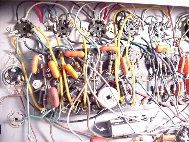

I did remove the old dead photocell for the tremelo and was thinking that there may be some part of that circuit that i need to connect with the photocell removed. The red X in the pic shows where the photocell was connected from V4B
Im guessing at this point. The circuit board is a jam packed mess

« Reply #31 on: May 17, 2010, 08:42:09 pm »
Thanks Steve i will try that. I have just discovered that the (2) channels seem to be linked together at some point. I dont know where but when i plug in a guitar cord lets say into the Normal channel and i touch the tip of the cord the second channels volume is interactive as i turn up that volume pot. Same goes if i plug into the reverb channel (Second Channel) the Normal channels tone stack is active
This a weird one. There a bad part in here some where
