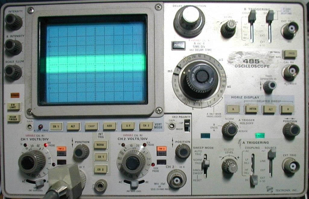

Mick, posting a pic of what you see and the scope setting will help a ton.

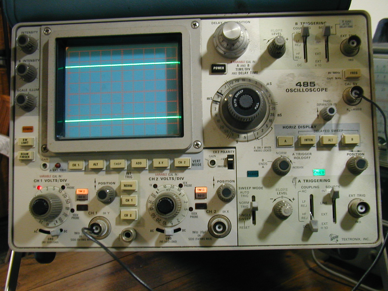

« Reply #7 on: June 19, 2010, 02:20:14 pm »
ok,  posting some pics - a good idea...

The second pic,  I can make out a signal ( I hope)..

Let's eliminate the probe. Just use a piece of 22AWG wire. Strip 1/4" insulation from each end. Stick one end in the CAL jack (freq set to 1KHz) and the other in the CH 1 input. Or stick a paper clip in each of those jacks and connect with a gator clip lead.

Ok, so had time to do re do the steps with 22 awg wire.   Here is the pic url:
http://www.frontiernet.net/~stutler/485signal1K.jpg
I tried asjusting the slope.   It never seems to synch on the signal.
