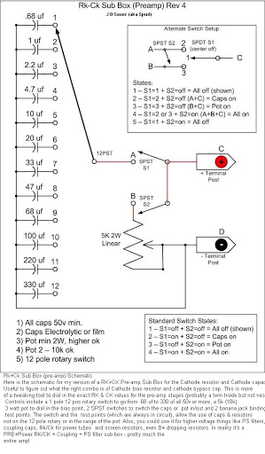

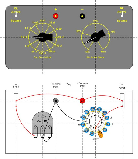

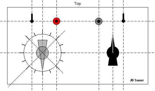

These might be the images that were linked to in that thread.  I saved 'em off from somewhere recently:
http://lh4.ggpht.com/_rYf9n9CQ3bQ/S_wEElv1jjI/AAAAAAAABac/7o8cgRF5gM8/RkCk_sub_box_schem-1.jpg
http://lh4.ggpht.com/_rYf9n9CQ3bQ/S_wEEof15-I/AAAAAAAABac/WVNI_9LGdPM/RK-CK_subbox_6x3.jpg
http://lh4.ggpht.com/_rYf9n9CQ3bQ/S_wEEWOaISI/AAAAAAAABac/W_obrw_VRN0/s800/RkCk_sub_box_panel-1.jpg
Also go to parts-express.com and search on "substitution"
They have a couple reasonably priced boxes that might be worth it just for the box and some other components for the basis of a DIY version that might better suit your needs.  I don't own one, so I can't speak to their quality.
-John

Thanks guys.  From Mouser, it looks like NKK rotary switches are about $15 each.  Even at $40 including shipping, buying one with the front panel labelled, etc. looks like a good bet even if I end up replacing the resistors.
John - that cathode R/C network box is just plain cool!  Put a honking big plate resistor in there and parallel it with a pot or decade box and you can dial in anything.
