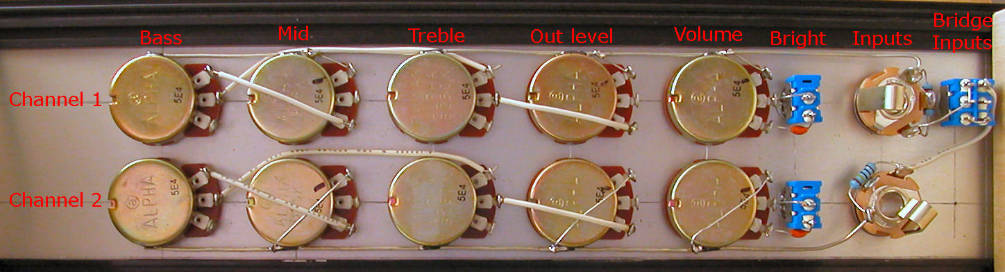

Hello,
I am building the "stereo preamp" that Doug has in the library.  I have a question about the schematic at this link:
http://www.el34world.com/projects/images/stereopreampschematic.gif
My question is about how the bass pot is wired and if I am interpreting the schematic correctly.  Is that a 4 way connection involving one leg of the bass and treble pots, the bass pot wiper,  and the .022 capacitor?
The schematic appears to show all 3 legs of the bass pot connected, However when I look at the following link:
http://www.el34world.com/projects/images/DSCN1864.JPG
It shows only 2 of the bass pot termainals connected,   and the middle connector (wiper) of the bass pot connected to the treble pot.
Thank you
Re: stereo preamp project
« Reply #1 on: July 21, 2010, 11:08:48 am »
Hmmm. Good question. While you're at it, I see no connection to the wipers of the middle controls in the photo! OR, the output level pots!
Must be a "work in progress" pix, no?
  • Posts: 5297
« Reply #2 on: July 21, 2010, 11:57:06 am »
Yes
The bass pot is wired as a variable resistor, so only two terminal connections are necessary. However, many people prefer to connect the wiper to one end of the pot (it still functions as a 2 terminal variable resistor). The reason is that in the event that the wiper should break or lose contact with the carbon track resistor, the pot will go to maximum value rather than become an open circuit. I wire my variable resistors like this for that reason.

« Reply #5 on: August 11, 2010, 10:12:34 am »
Hello,
Where does the wiper of the "Output" pot connect on the schematic?
Thank you!
Offline LooseChange
  • Posts: 3511
    • Fix Your Darn Amps
« Reply #6 on: August 11, 2010, 01:07:50 pm »
To the output jack.
