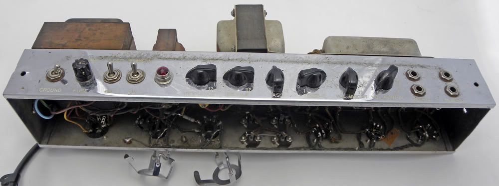

Too bad about all the rust on the PT laminations.
Dave
Re: This'll be a good gauge of current fetishism!
« Reply #2 on: July 21, 2010, 01:31:55 pm »
?? Why, that's a badge of authenticity! Doesn't affect anything.

It is my understanding that it does if the rust is deep enough to bridge the laminations.
« Reply #4 on: July 21, 2010, 01:54:01 pm »
I could believe that. The rust on the PT doesn't appear too bad in this case. I bet this gets to over $2,000.

It looks like you'd end up spending a ton of cash replacing everything from caps and pots to tube sockets and transformers. I bet it doesn't sound any better than a carefully built clone. I suppose if you've also got an empty '57 Bassman cabinet to put it in, it might be worth it. *shrug*

It looks like you'd end up spending a ton of cash replacing everything from caps and pots to tube sockets ...
Maybe tube sockets if they're loose. To me, the entire circuit board looks new/replaced except for the handful of yellow caps. The resistor may be original, but even the board looks new to me. Old boards typically have much more warp/bend to them from years of being bolted down to the insulator board and chassis.
But most everything looks new; there is an added thumbwheel bias adjustment, and a silicon diode in heatshrink between the original bias tap wire and an add-on wire to replace the stock selenium rectifier (which is left in-chassis but disconnected).
To me, the only thing in this auction worth paying for would be the transformers, and that assumes the rust on the PT doesn't cause problems (often it doesn't; sometimes it does). Everything else can be done with modern parts just as good.

The OT and choke look okay but I wouldn't trust that PT as far as I could throw it. In some of the ebay pics, it actually looks like the rust has depth. I wouldn't plug it in.
