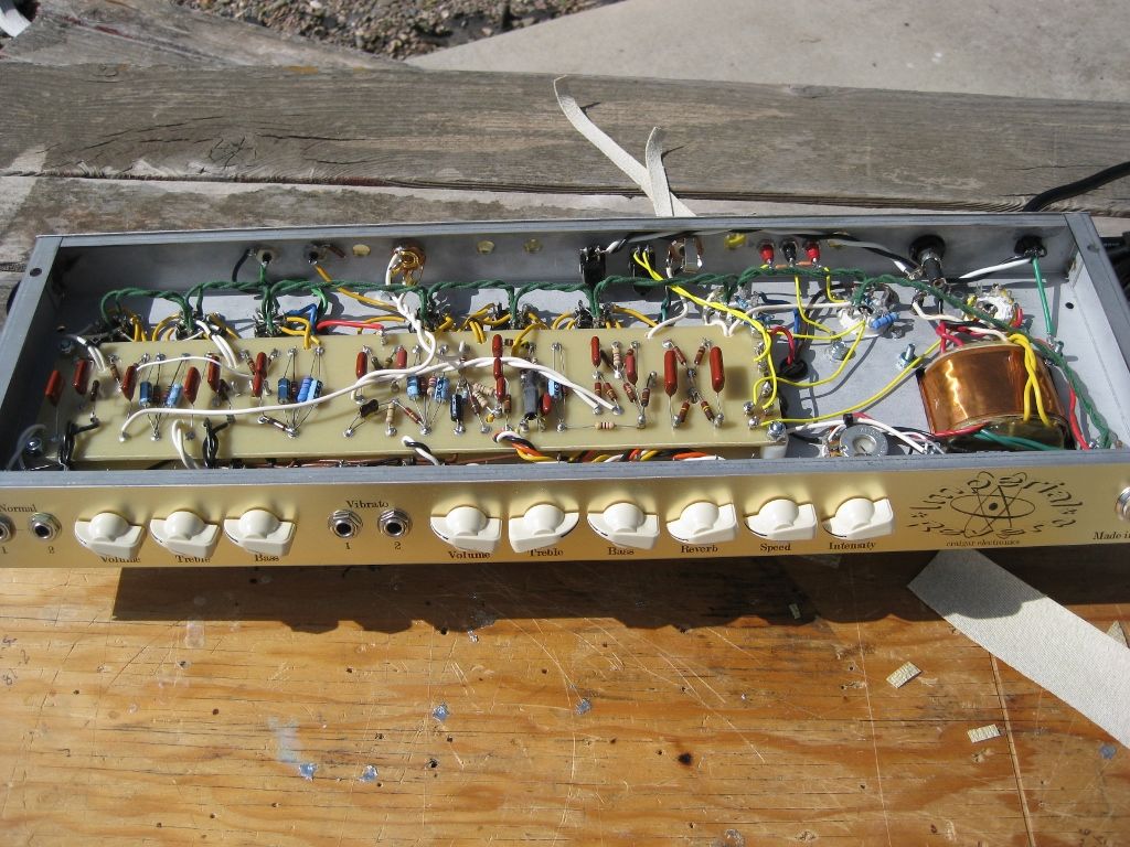

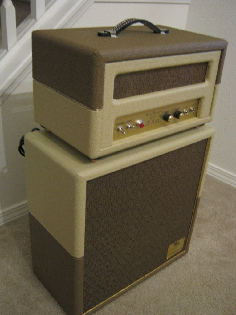

Here's a DR I just finished

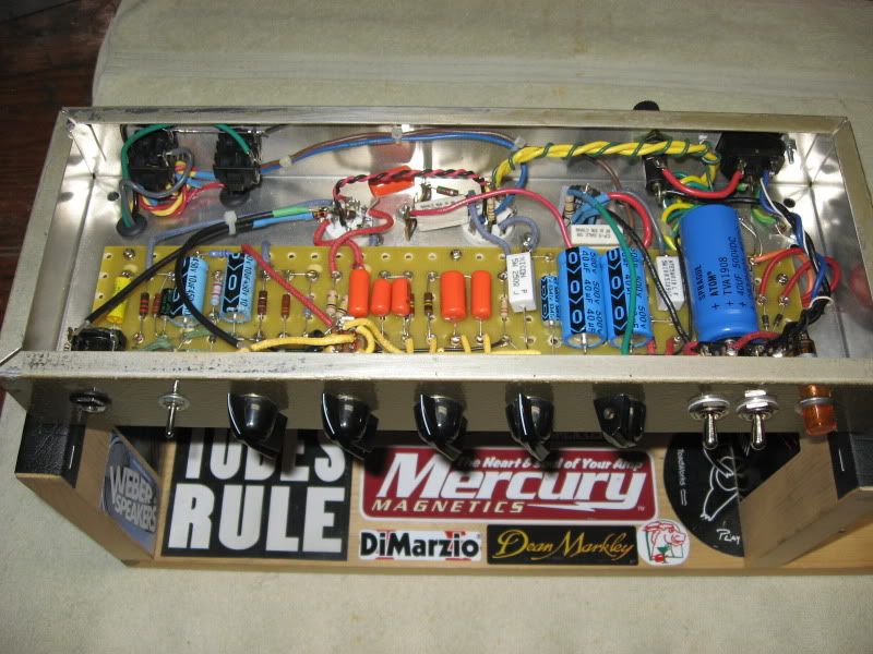

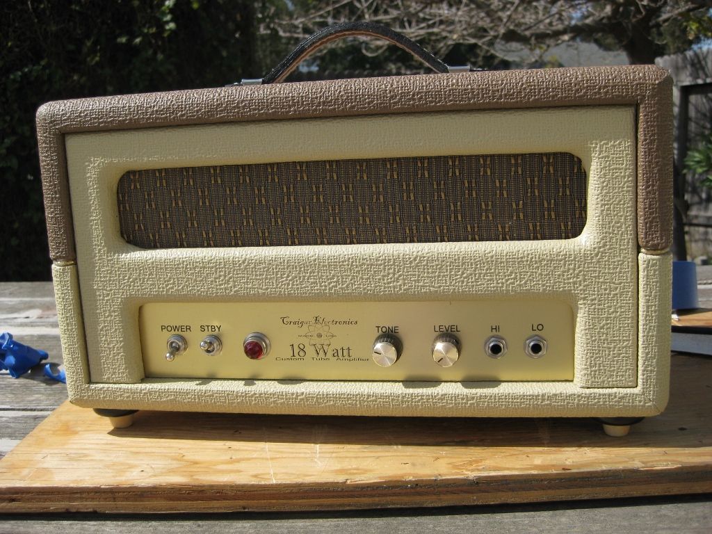

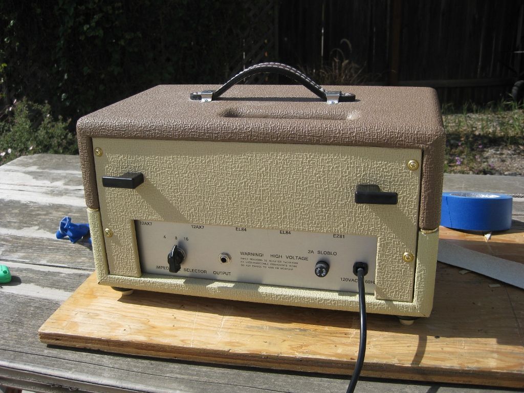

And a little 18w head and 1x12 cab
« Last Edit: April 10, 2012, 09:12:04 pm by CraigB »

Damn! Those are seriously nice amps!That Fendery build is killer looking!And the 18 watt lite is to die for!

Craig: Is that radio grill cloth on your amps? Just wondering how easy (or wasn't) to secure it in place. The stuff I've seen is more "cloth" than the woven plastic of normal guitar amp grill cloth.

And Craig, where on  Earth did you get those cable 'anchors' for the power cord? Those are really simple looking, and I can't seem to find them anywhere!

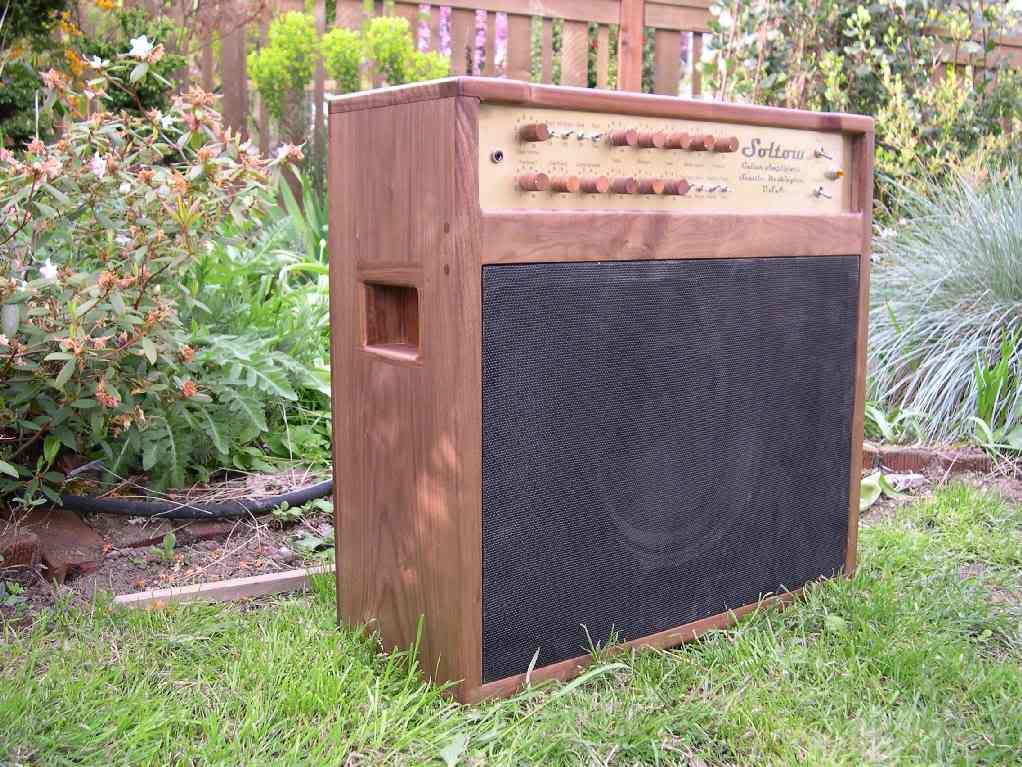

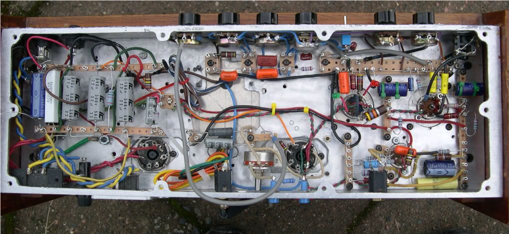

I like very much the circuit of this amp where the preamp is based on both
12AX7s and EF86. The power amp is 2xEL84 used in VOX AC15 Matchless Lightning.
A more powerful version can be done by adding two power tubes. The amp is
then close to VOX AC30/Matchless DC30.
No, that stuff is plastic.  $1.29 for enough to do both cabinets at the local electronics place.  They had a whole bunch of different styles of radio cloth, so I picked up some of that too since it was cheap.  I'm not sure exactly what I'll use it for, but have you ever seen what AES gets for that stuff?  I felt compelled to buy it  :grin:
Offline CraigB
  • Posts: 681
Re: Show me your proudest builds
« Reply #70 on: March 16, 2012, 12:24:17 am »
I think those came off an old Peavey SS amp someone gave me for parts.  Probably the most useful parts I got from that one!

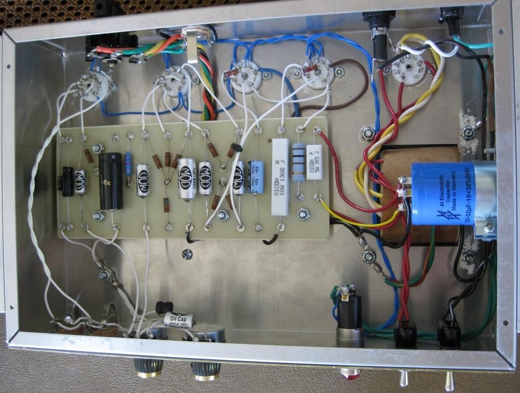

Here's my ODS build from the old Hybrid Rev A schematic.  The photo does not do justice to the wood color--actually a rich brown walnut (1/8th" veneer on poplar plywood except the figured piece which is solid.)
And my most recent, built from AX84 schematics--blues preamp and 5W SE power amp.  It also has the AX84 October studio effects loop partially wired up back in the back.  Not the most beautiful cosmetically, but I love the sound of the 7199 and 12AU7.  Due to limited space I decided on point to point rather than the usual turret board layout, but I hate terminal strips so I made up some mini turret strips and boards to suit the layout I wanted.

Cool build, is that a hammond chassis! If not could you give me some more info, I'm looking for a chassis of that kind.
THanks Bruno, that's a Hammond 16x8x3, I believe

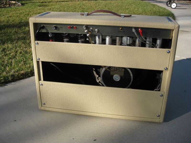

Ah,what the heck!
  Here's a set of twins that I'm proud of.
Now that, that is beauty x2

Here's one of mine..
Offline Fresh_Start
  • Posts: 2856
  • noob de Lux
« Reply #92 on: April 15, 2012, 10:44:53 pm »
I love the blonde Champ head.
Chip
Quote from: jjasilli
Quote from: PRR
« Reply #93 on: December 16, 2012, 05:09:40 pm »
LOL, your "Champ" looks like "Chomp" if you scan it quickly. Which is great!

this is a 2 channel 1-12 combo 18 watts 2 6v6. diode recto. one channel is vox like the other is dumble ish
  • Posts: 10323
« Reply #95 on: December 17, 2012, 07:40:48 pm »
That is a VERY cool amp!!!   I like it.
Regarding
Can you describe the dumblish channel somewhat, please?   Like a Vox clean with dumblish OD?
Or are you saying Vox  &  then dumblish clean with dumblish OD?
I'm really curious.
Did the amp covering come from Gary's Upholestry?

This is the one I'm the proudest of. I have been building amps (+27 and counting) and this one stands out. It's the one I gig with, my own 1987 replica.

I migth be able to scan and post a schem on the dumble side. actually its a trainwreck type circuit but then i used the local feedback loop trick and brough one of tha values way low and I like the results. I had guys at the amp shows saying whats with all the sustain. It holds it for as long as you want
the vox side is almost dead on vox preamp but then into the 6v6 power with typical marshall 50 watt bias circuit and PI specs. I did do the 50k revers pot on the 470 ohm in PI.
