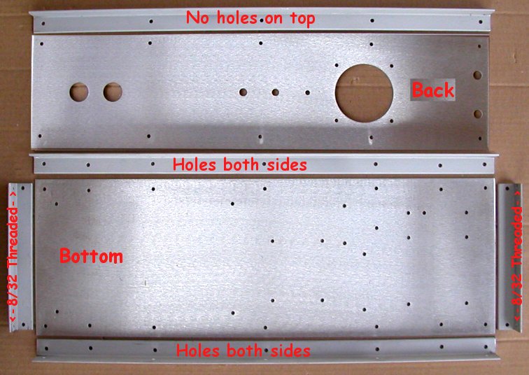

The lower chassis assembly has two big flat pieces, 3 long angled pieces and 2 short angled pieces. The upper angled long piece only has holes on one edge. The two lower long angles pieces have holes on both sides. The two short angled pieces have two regular holes and two holes that are tapped with 8/32 threads. The threaded holes are the holes that bolt down the lid.

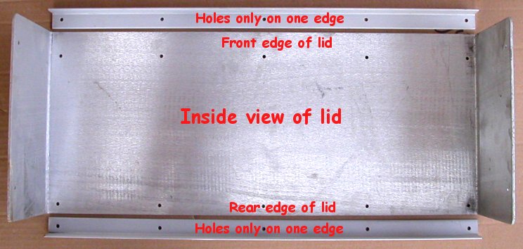

The lid is one big bent piece of aluminum and two long angles pieces. The angles pieces only have holes on one edge.

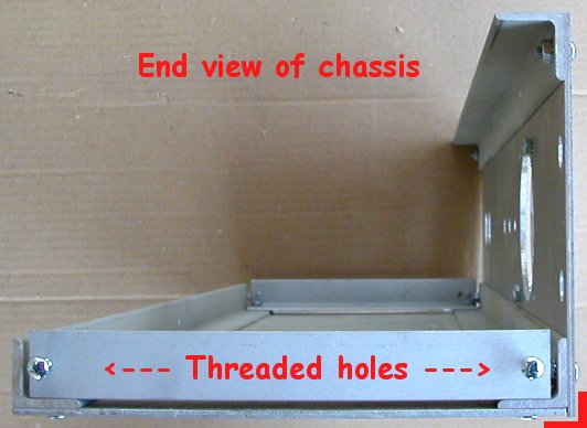

Here's an edge on view of the chassis. You can see the threaded holes have screws threaded into them. Note in the lower right of the photo that the chassis back panel overlaps the chassis bottom panel. This may be easier to see if you click on the picture and look at the full sized image.
