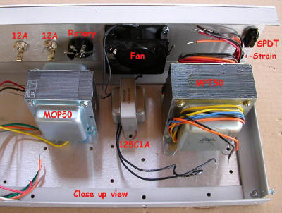

Here's a close up view of the transformers and rear panel parts.
The two rear holes line up on the MOP50 output transformer. You will have to drill two new front mounting holes.
The holes like up perfectly on the 125C1A choke.
The two right side holes line up on the MPT50 power tranny. You will have to drill two left side mounting holes.

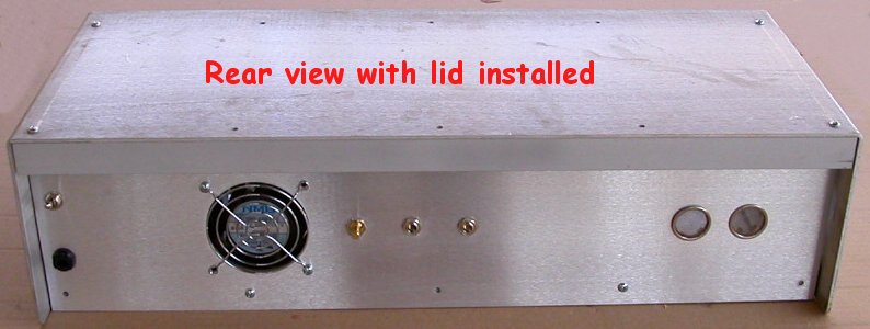

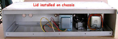

Here you can see what the lid looks like when it is mounted on the chassis.
The rear view with lid mounted.

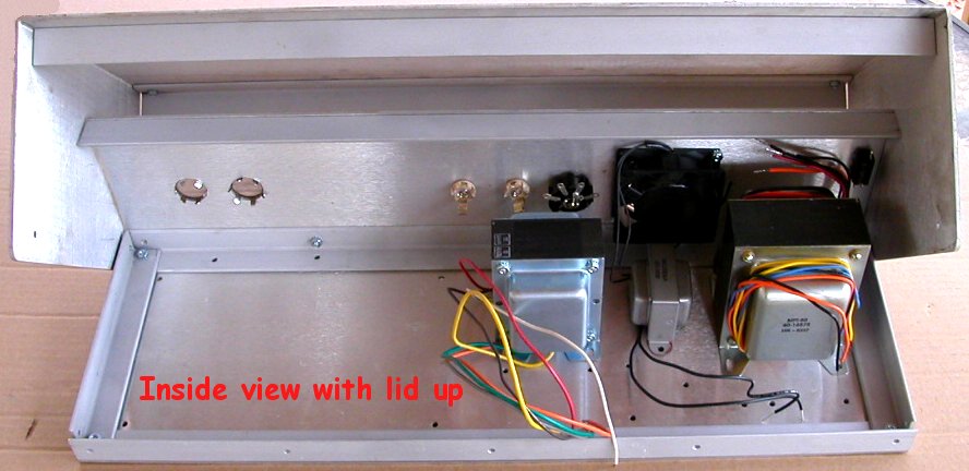

Inside view with the lid flipped up. You remove the two front threaded mounting screws. Then loosen the two rear threaded mounting screws one turn. The lid pivots up on the two rear threaded mounting screws.
