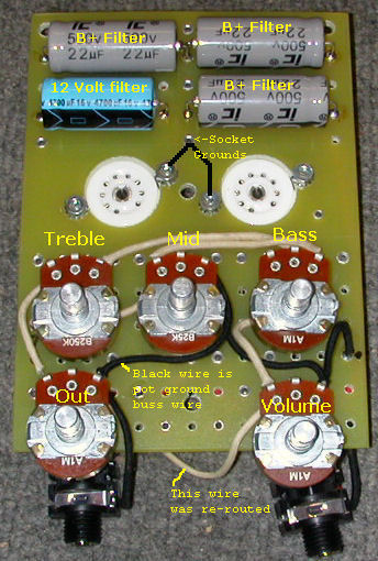

Left: I updated this board by adding grounds from the Tube mounting screws to the main ground buss. I used #6 ring terminals and ran two wires to the ground lug. See <-Socket grounds.

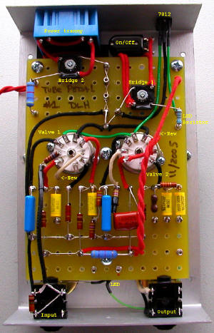

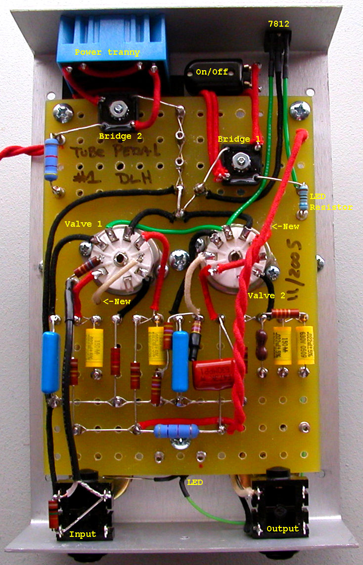

I also updated a couple wire runs that are not shown in this photo. The wire from the center of the volume pot pops up through the board right next to the tube socket and goes to pin 7. The filter cap wire that goes to pin 6 on valve 2 pops up through the board right next to the tube socket. Both of these new wire runs can be seen in the photo on the right, they are noted as <-New
Right: The relay was eliminated and the hot switch mod is wired full time now. The noise level was reduced a bunch by doing this.

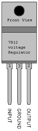

The 7812 voltage regulator was moved and bolted to the chassis for a heat sink. See 7812 in photo
Ground wires were shuffled around and some were removed or condensed. The chassis is tied to the main ground buss through the volume pot. The volume pot body has a jumper wire soldered to the back of the pot that is connected to the black pot ground buss wire.

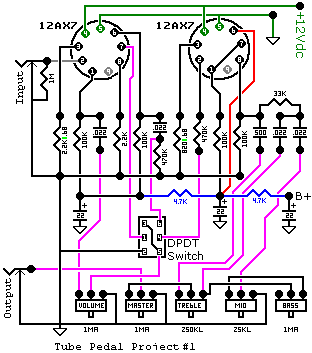

This is the original circuit that I installed in my Tube pedal #1. See the next page for an updated circuit drawing. Pedal power supply schematic
