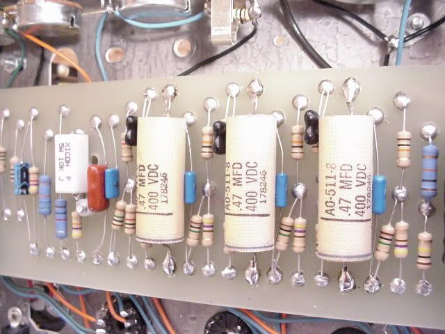

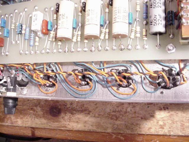

I thought those .47µF caps were very small. You have installed .047µF instead. Try it and see if you like them. If it sounds too thin or bright, put the .47s in there.
Re: Stand-alone true pitch shifting vibrato for guitar
« Reply #103 on: January 05, 2011, 08:32:33 am »

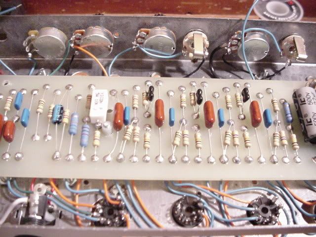

Opps! I was bound to do something like that. Maybe i can use the caps from the old hammond board. I dont have any here except for them. Thanks for catching that!
Ok here are the right caps. They look good too! I have to remember that decimal before the numbers
« Last Edit: January 05, 2011, 09:14:14 am by plexi50 »

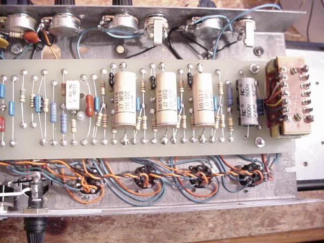

Ok i am all wired up and finished minus one wire connection
Steve is the 0.047 cap from the Mixer pot going to another switch?
Vibrato = open?
Chorus = closed?
All i have left is a single wire to connect from the .01 cap to what i believe is a switch
I only see one switch on the front panel of your actual chassis build on the Speed (rate) pot
I fired it up and my voltages are:
A-330 VDC -12AU7
B-326 VDC -12AU7
C-248 VDC-12AU7
D-172 VDC-7247-12DW7
E-312 VDC
Node C from your voltages should be 124-5 vdc / I have not plugged into an amp/guitar just yet
« Last Edit: January 05, 2011, 01:54:23 pm by plexi50 »

I had to make a revision of my own. I cut and removed a small amount of the circuit board and relocated the SRT to the chassis itself. It was sticking out of the bottom of the small chassis i used. I didnt want anything to happen to that SRT
Also i think i want to try a 300 ohm resistor in place of the choke and see if i get more shine. The Maggie did not use a choke in it's amplifier circuit and like a few other amps like the Ampeg Gemini II i really liked the crystal clarity (shine) of the resistor vs the choke in those amps
I have a good feeling something great is going to happen in tinkering with this project

Steve i have a question. Changed the Mixer pot to 500KL. After getting some time to play with it i notice i have a heavy pumping wooshing  action at amp idle before playing. Does yours do this? I heard your sound clips and your appears to be silent until used. Whatcha think?
« Reply #145 on: January 16, 2011, 08:28:56 am »
Mine does the pumping thing too if I have the depth control cranked real high. Almost sounds like a helicopter. I just back off the depth until the pumping stops. I can still hear the background amp hiss changing at the vib rate, just like with many tremolo circuits.
See that 2.2meg resistor that connects to the top of the depth control? I chose that resistor value (by experimenting) to allow the vibrator to have a little pumping with the depth turned all the way up. You should have heard it with a 1meg! Way too much! If you increase the value of the 2.2meg, you will decrease the pumping effect, but you will also limit the strength of the vibrato. You can accomplish the same thing by just turning the depth down some. Mine has plenty of depth for my ears without being turned all the way up.
You can probably smooth the pumping some by increasing that .047µF cap connected across the depth pot. And that 10K resistor in the cathode of the driver tube may have an impact on the smoothing of the vibrator. That resistor was factory selected on the original AO-47. I would think that decreasing that resistor would decrease the pumping (and the strength) of the vibrato.
If you experiment with this, post your results, especially if you find an improvement.

I would like to get a tad more glassy shine but heres what i did today:
I put every else aside this afternoon.  Here is what i did and i really like the change though it was minumal< (Is that spelled right?)
I played with the 2.2Meg resistor and changed it to a 3Meg
This brought the thump down a bit but still plenty of thump to be had if wanted
I think the Depth pot (intensity) works better and allows for a slower transition. JMO
I have a Magnatone customer that uses his M10 Vibrato for vocals only. Another reason i was really interested in this project
I reversed the Mixer outer terminal leads from your layout and now have CCW off and CW gradual mix
The (2) 500K pots made all the difference in the Mix and Depth pots balancing the controls out perfectly
I dont think there is any need for any further improvements other than to put the On switch on the front panel in place of the Fast/Slow switch which is really not needed

« Reply #147 on: January 16, 2011, 04:38:38 pm »
I never meant for you to change the depth pot to 500K. Only meant change the mixer to 500KL. That explains the increased thumping in your vib.

« Reply #148 on: January 16, 2011, 05:41:27 pm »
I will put the 250KL back in this week sometime. I just changed V1A cathode cap to a 2.2uf. It is still plenty full and depth defined just not as dark
Will raising the value of the 150pf caps give me more shine or is it the .47 caps that i need to try different values to brighten up?

« Reply #149 on: January 16, 2011, 07:27:33 pm »
Tried the .047 caps. They sucked. Lacking warmth. .47's back in. Bridged 470k across 500K wiper and outer pot terminals and have 248KL. Close enough and works better. I want to slow the rate down just a hair more. You have created a Vibrato junkie! :laugh:
