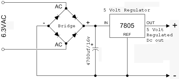

Ever since I restored the Maggie M10-A, I've been intrigued with the pitch shifting vibrato idea. A few months back FYL posted some info on a Wurlitzer organ vibrato circuit. That got me thinking, "What's going on with the old Hammond organ vibratos?" I've seen many of the small vibrato units on eBay for cheap! Maybe it could be converted to guitar use.
Well, it's actually pretty easy to convert them for guitar use. Here's my project...
          (Click on the pic for more info)

The tranny is not a standard transformer. It's a saturable reactor. This unit has three mounted on a common frame. I don't know how it's made or if there is an affordable COTS unit available. Why not just get the right part to begin with? The entire Hammond vibrato unit (AO-41 or AO-47) is still very affordable on eBay. You guys just don't need to get into a bidding war though!   :grin:
The saturable reactor is the key to this circuit. Without it, you got nothing. You can read the theory of operation to see how it works it's magic in the modulator circuit. Here's basically how it works...
Don't think of this as a transformer that's gonna step up or down some ac voltage. Instead, think of it as a device that the primary winding is going to control the impedance of the secondary winding. When current flows thru the primary in one direction, the secondary impedance will be high Z. When primary current reverses directions, the secondary impedance will be low Z. Now make that primary voltage a very smooth, low frequency sine wave and the secondary impedance will smoothly change from a low impedance to a high impedance at the frequency of the sine wave. This secondary is connected such that it switches (actually blends) the plate signal and cathode signal together and passes it on to the next stage. Using the input signal as a reference, the cathode signal will have zero phase shift while the plate signal will have 180 degrees phase shift. The varying impedance of the secondary smoothly blends the 0 and 180 signals together such that the resultant signal has a smoothly varying phase shift. This change in phase causes a change in frequency of the resultant signal.
There's a lot more going on with saturable reactors. Most of it seems like magic.
BTW, I've seen a circuit that uses analog optocouplers to do the same thing as this saturable reactor does.

Re: Stand-alone true pitch shifting vibrato for guitar
« Reply #17 on: December 16, 2010, 01:50:41 pm »
That's the most common name. They're used in AC voltage regulators, synchro data to azimuth pulse data converters (don't ask). Usually associated with so called magnetic amplifiers. These are the smallest ones I've ever seen.
No sound bytes yet. Maybe over the holidays.
Here's a schematic symbol...
« Last Edit: December 16, 2010, 02:50:54 pm by sluckey »
