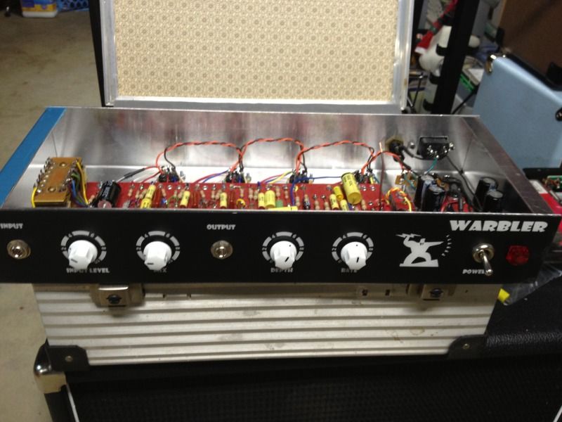

Finished the unit last night and I am really happy. I am going to add a two (2) button foot switch to switch between fast and slow and add true bypass. I did change the Slow By-pass cap to a .022 and I am happier with that value. I'll post pics shortly.

Crappy Cell Phone Pics
I seem to get significant signal loss with the mix control in the middle position. Is this normal?

That looks very well done! How did you make your faceplate and what did you use?
Offline Jhtjon
  • Posts: 9
Re: Stand-alone true pitch shifting vibrato for guitar
« Reply #218 on: August 30, 2012, 04:39:25 am »
I drew the design in Corel Draw and sent the file to BNP lasers. The material is 1/16 reverse engraved black plastic with white fill. it costs about $18-20 per panel.
I think the guys might have missed this question?
                           Brad     :icon_biggrin:
Which schematic?
« Reply #224 on: August 30, 2012, 03:48:25 pm »
I lose volume too. Almost sounds like some phase cancellation going on when mixing wet and dry. Does it even with the depth control on zero. But it does give some different sounds when the vibrato is on. I still prefer the mix to be all wet though.
Very nice work BTW. Wish I could make my stuff look that good.
Tubeswell, it looks like revision 1 since there is a mix control, only one filter cap on the board, and only half of V3 is being used.
Isn't the vol drop just because there is only 1 gain stage on the 'dry' side of the mix control? (Or are you talking about the vol dropping on the 'wet' side?)
« Reply #227 on: August 31, 2012, 04:03:39 am »
There is plenty of volume at each extreme of the pot and the full wet volume is pretty well matched to the full dry volume. But when the mix pot is somewhere in the middle the combined signal volume is somewhat lower than either extreme. The lower volume is not useless. There are still some good sounds, although I prefer the full wet sound. I may put a scope on it today to see better what's happening.
Sorry I've been away. Yes it is rev.1
I was wondering if there is also a way to make the depth control a little more responsive. mine doesn't do much below 1/3 on the dial
