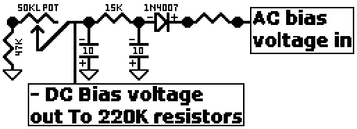

Hi guys, in this circuit:
we have Vac going through the first R (unknown value), then rectified, then thru the 15k, then the pot+47k
My question is how does one calculate the voltage drop across each resistor to determine the voltage at the Bias Tap between the pot and 15k?
Assuming 220k resistor for the first resistor, we have a total resistance RANGE of:
Pot @ max: 220+15+50+47 = 332k
Pot @ min: 220+15+47 = 282k
If I was using a 300-0-300 PT, I would have:
I=V/R=(300*.707)/332 or (300*.707)/282
Irange = 0.75mA - 0.64mA
Using this current I can solve for a V drop across each resistor. The problem is:
1) It doesn't match the duncanamps PSU Designer results
2) The first resistor is on the AC side of the diode and the voltage drop is different
Can anyone enlighten me on this a bit more?
Correct.

« Reply #2 on: July 15, 2011, 12:40:38 am »
This {below} is how to handle it in Duncan PSD.
The load is the sum of trimmer and stop-resistor. Generally you want minimum voltage to not-quite FRY the tube (so a trim accident won't cause instant meltdown) and a maximum voltage which will put the tube "OFF" (a good place to start). This is roughly a 2:1 range so set the stop-resistor about equal to trim-pot.
The "15K" has small effect on voltage. This circuit is more constant-current than constant voltage. As long as your 100K bias-trim network stays the same, 1K to 20K in front has little effect on bias voltage. (This is different than the small-resistance rectifier used with 50VAC bias taps.)
The "15K" is picked more for filtering. So you need cap values first. As a general ballpark you can use 1uFd per mA of load. We'll assume 50V-100V across the 100K string, around 1mA. 1uFd would work... except this is a half-wave circuit so we need 2X to 4X the cap to get clean. Say 4uFd. However the cheapest suitable caps are 100V-150V Electrolytics, and they are not sold much smaller (and no cheaper) than 10uFd. So use 10uFd.
However the simple calc on 270K+10uFd says 2.7 seconds for voltage to rise to 63% of final value. In fact the 270K is not pulling the cap half the time, so the rise is even slower.
It may not be necessary to have two caps. If the amp were perfectly balanced, grid-bias ripple would cancel. And there is a disadvantage: a quick on-off-on event may leave cathodes hot and bring plate voltage high before bias voltage slowly ramps up. In fact I suspect you should try one stage with first 10uFd and then 20uFd and see if the amp buzzes less.
If you do need to go as far as a 2-stage filter, then 1K resistance gives some cut of 60Hz buzz and big (2-stage) cut in the higher buzz harmonics. 10K and 10uFd gives quite a lot of filtering, more than you should need. 15K may have just been handy.
The PT's source resistance may be dummied-up, which is the same effect as an actual resistor.
The R-C-R-C filtering is very slow to rise, you need to set "delay" to at least 10 seconds. (If the wobble is slanty, it is still rising toward final value.)
Values shown will give 46.2V. This is the "OFF" bias. This is perhaps too low for most audio tubes fed 333VAC =~~ 450V DC. The "270K" needs to be smaller.

« Reply #3 on: July 15, 2011, 12:42:44 pm »
It is a "stupid" plan, in the engineering sense. You are wasting-away 360V to get 40V... that's like MASHing the go-pedal then using the brake to stay under the speed-limit.
This is tapping the same secondary feeding the power rail of the amp so its not a separate transformer or anything.
Get a 10-pack of 47K. Series them up around 250K. Wire-up with your diode, cap, 5K-15K, cap, and 50K+50K trim network. See what you get. SHUT-DOWN before changes. Add or omit 47K resistors in the string until you get in the ballpark. Then count by 47K and go get one 2W resistor of that value.
I want to avoid lengthy "guesswork" like this.
Yea I know this is just to get separation and another filtering stage
Yes, and this is what I'm really trying to find out, how much current is running through. So using the Trim+stopresistor value (50k + 47k), and I wanted -30Vdc:
30/97000 = 0.33mA current
So I can assume 0.33ma current is running through this circuit, but doing the math on the "other side" of the circuit (220k/15k) the math is wrong. That's what I'm struggling to understand how to figure out the voltage dropacross the first 220k and 15k resistors.
« Last Edit: July 15, 2011, 12:48:39 pm by surfsup »

Probably not worth the effort for a formula.
It is worth the effort. The problem is that there is no such thing as a simple formula to find the answer.
The bias circuit is roughly the same problem as you find with figuring the d.c. output of the main rectifier in the amp's power supply.
O.H. Schade (the guy that wrote up how 6L6's work, and likely invented them) did a bunch of research and compiled graphs to assist in answering this same question with regard to the B+ supply. The charts and the method are given in RDH4, and there's maybe 6-7 charts that you have to work through, one at a time. His "easy method" ain't as easy as you'd like.
And guess what? Of the many variables that you have to juggle, the resistance presented by the PT's primary winding (plus any series resistance) is one of the significant ones. And that resistance is tiny compared to the input resistor in a bias circuit (meaning it doesn't have as much impact on the B+ supply as it does in the bias supply).
... but doing the math on the "other side" of the circuit (220k/15k) the math is wrong. That's what I'm struggling to understand how to figure out the voltage dropacross the first 220k and 15k resistors.
If you want to do the math on the other side of the circuit, you probably need some trigonometry, some vector algebra and some calculus.
In a d.c. circuit, voltage and current are in phase and are constant at all times (we'll neglect step/transient analysis); additionally, you mostly think only of linear resistances. In an a.c. circuit, voltage and current are not in phase. Plus, you have a non-linear circuit element: a rectifier diode. The a.c. cannot be thought of in terms of RMS (as you typically know it: a.c. voltage * 0.7071), because the diode turns the a.c. into pulsating voltage and current, which charges the caps on the "d.c. side" of the rectifier and pulls pulses of current through the rectifier which are not solely related to the incoming a.c. voltage.
Strictly, RMS works, but the difference is that the waveshape is different, and so the normal conversion factors don't hold. The calculus part comes in when you need to calculate the effective amount of d.c. represented by the current pulses, so that you can conveniently calculate.
In any event, the rectifier's effect comes into play, the resulting waveshape, the size of the capacitors, the degree to which voltage and current are out of phase due to the balance of reactive and resistive components, and the amount of resistance on both sides of the rectifier (considered separately and with different effects). All of these considerations are why there is no one simple formula, why O.H. Schade's method had so many steps and graphs, and why PRR's suggestion of cut-n-try works faster than calculation.
It's also why he suggested, if you want calculated numbers before getting the soldering iron hot, that you tinker with the power supply simulator. Let someone else do the hard math for you.
I was speaking generally. Yes, it is used a lot in guitar amps.
Me too. Look at my other posts; I'll calculate anything, even a cathode resistor, even a gambrel roof. But this is one case which defies practical hand analysis (even with a calculator).
I'll relent a bit. ASSUMING the desired DC is much-much less than available AC (otherwise it interacts like mad), it isn't too bad.
Find a Known-Case. I'll use my PSD example above. 333AC, 46V across 100K, or 50.6V across 100K+10K, which is 0.46mA.
_Pretend_ the "333V AC" were actually 333V DC.
The series resistor must drop 333V-50.6V= 282.4V, and at 0.46mA. 282.4V/0.46mA= 614K. But the (million point-by-point calculations simulation) says 270K needed. The "assume DC" number is 2.27 times higher than what we really need.
Why "2.27"? Well... about half because the diode only passes half the time, and less than half because it won't start to conduct until the AC wave rises over the 50.6V. The useful charging waveform is NOT a sine, or half-sine, but a slice of a sine. So the usual 1.414 or 0.9 factors don't give the right answer.

DummyLoad, in taking a schematic on a well documented/cloned amp which works and looking at the bias voltage setting recommended, the PSUD software does not even show the correct range to achieve the voltage for biasing the power tubes. I started this thread solely because the modeling software out there doesn't seem to like calculating the bias voltage. So yes it calculates the numbers quickly, but the numbers are wrong. (at least for the example I am working).
Re: Bias Circuit
« Reply #14 on: July 20, 2011, 07:10:42 pm »
WHAT "well documented/cloned amp which works" example?
Ah, there's not that many variations. Marshall JCM 800 LEAD below, on plan and in PSUD.
The PT AC Volts is not noted, but we know the big DC, low-loss diodes, we can work out the AC Volts. While the PT is CT our bias only uses half. Half Wave. Now we'd normally go right to a cap, but as pointed out PSUD does have an R-C input option. The plan I found uses 56K fixed plus 22K trim, I took 67V as the trim-center (but you should check the 56K and 78K extremes, PLUS a +/-20% tolerance on about everything.
Expect 30V, get 29.87V.... close enuff.
The software is probably giving the right answer for the question you asked. The sim is hardly ever flat-WRONG.
The sim is dumb, and can't guess what you really want to know, and isn't the least bit interested in helping you ask the right question correctly.
SPICE will compute 8-digit answers 10 times faster than I can poke a sliderule; but I spend 10 times longer setting-up and re-re-re-checking the problem than I do finding an answer.
I don't do Tina; here's an older SPICE interface.
AC voltages are customarily "peak", not RMS or average, because SPICE supports non-sine wave sources. So "258VAC" is 365V Peak to SPICE.
SPICE offers several kinds of runs. New-fangled interfaces like Tina sometimes blurr the distinctions. You would think ".AC" would work; it won't. You must run a ".TRAN" command to handle non-steady AC puzzles.
I could have put the diode in the other way to get negative output, but it's too darn muggy to get fussy.
