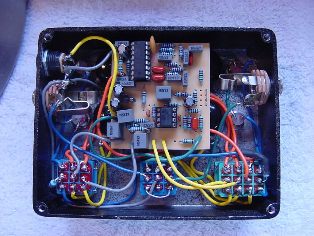

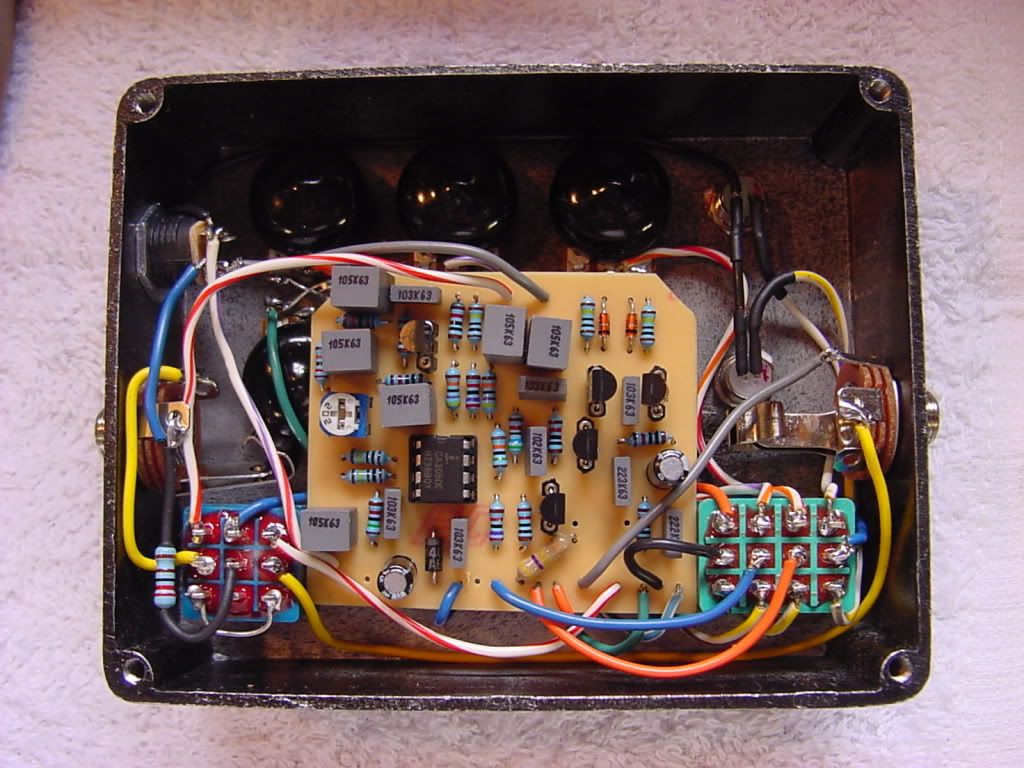

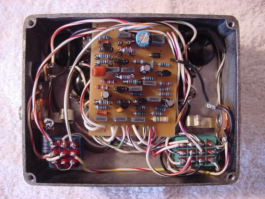

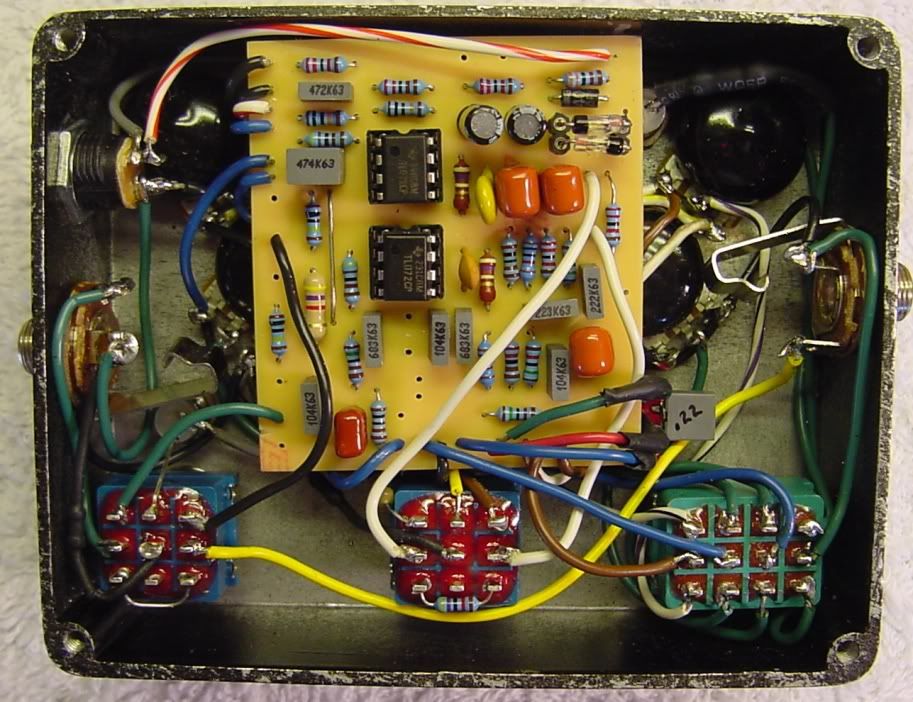

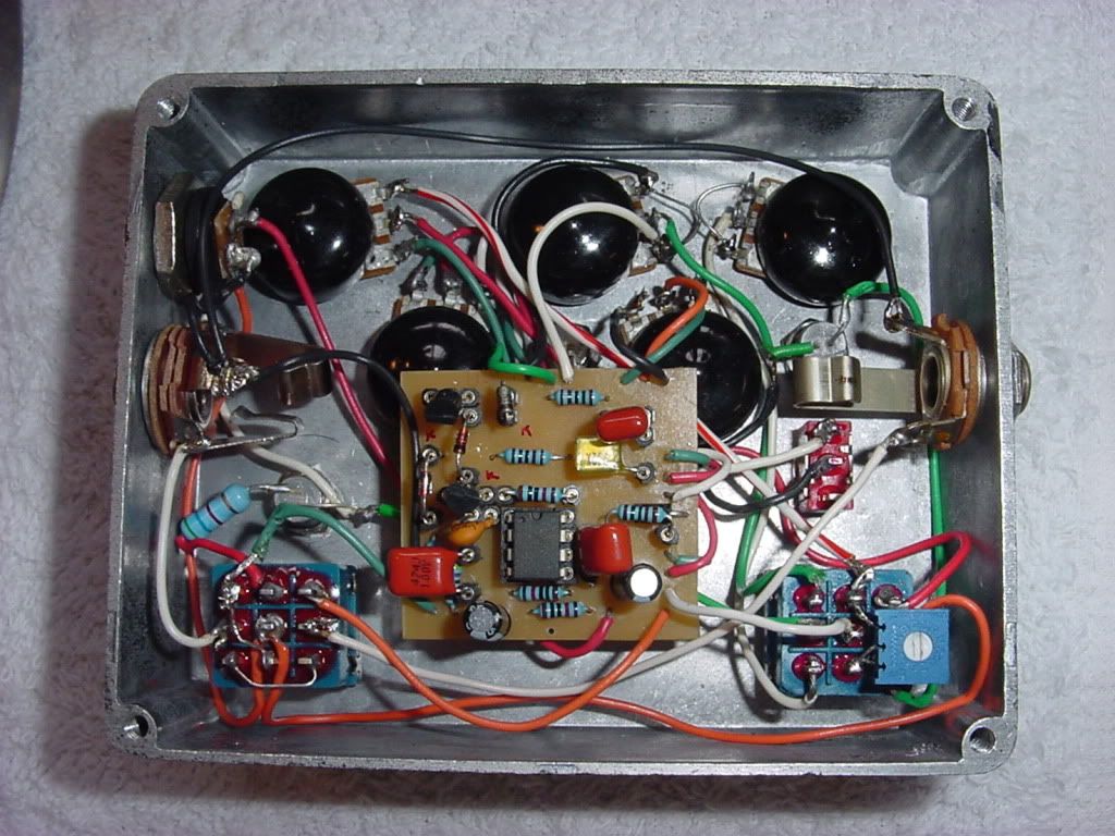

Hey guys, I thought I'd share my newest obsession with you good folks, as I've not been too active on the forum lately, but have kept the soldering iron HOT, just the same.
I've pretty much got my ultimate amp(s) built, and sort'a went at this thing backwards (as most people START with stompbox-type projects & work up to amps....I did just the opposite).
The following are my builds (so far), and I am today working on a Klon Centauer-type pedal, and also a Marshall JCM800-type thing in a box.
.....too much fun!
Also, these are NOT "kits"....The only thing pre-made is the PCB (Blank/etched only, I load & solder all the parts). The boxes are blank/un-drilled, I design the layout/features & faceplates, all the channel switching & such. Using alot of what I've learned from this forum & tube-amp building in general, while learning about SS stuff @ the same time.
They include (in order of appearance):
**ZenDrive type ("RenDrive")
**Compressor ("The Squeeze")
**Trem ("JitterBug")
**Dual Analog Delay ("KickBack"),
Thanks for lookin'!

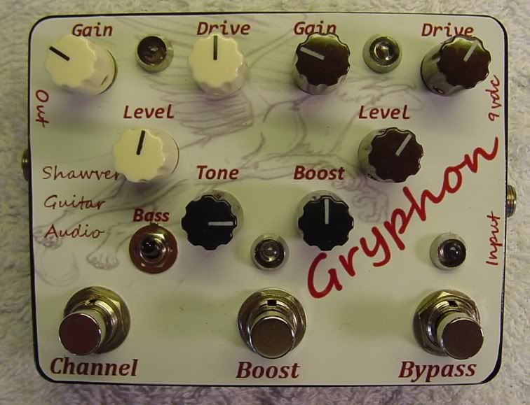

In the meantime, here's my newest....a Klon Centaur-type ($350 IF you can find one), and mine has 2x channels, plus a Bass/Fat Boost.
In staying with the mythical creature theme, I called it the "Gryphon" (If you look close, you can see him in the background).
BTW, it's tough to stuff all that into a tiny little box!  :cussing:

Following in Geezer's foot steps and his help, ................ this is what I've done now to my compressor pedal and my tube screamerish OD pedals.  The compressor pedal has actually not been built. I plan to do that this coming wkend.
