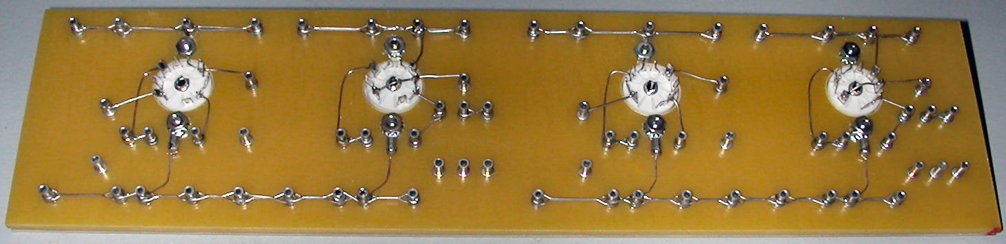

Working on something new. It will be a rack mount preamp.
I call it a Sock Turlet Board.
Stay tuned. ;-)

My board has the sockets facing up.
The wire between the turrets is buss wire. Strip 22ga. solid core is what Doug uses.

« Reply #4 on: March 11, 2012, 07:50:25 pm »
You can't quite see it in the pics posted, but all Doug does is twist them from turret to turret.
I think there are clearer pics of this in Doug's library of tube amps. It's at the top of the main page.

« Reply #9 on: March 12, 2012, 07:09:08 pm »
Wiring this board top and bottom is more of a challenge than I thought.

Re: Here's something a bit different: A Sock Turlet Board
« Reply #11 on: March 13, 2012, 05:28:32 am »
Yes, exactly. Components on top and socket wiring under. I'm never a fan of bottom wirin g. I like to see where everything goes. But it looks pretty cool.
« Reply #12 on: March 13, 2012, 12:27:11 pm »
Looks good LC, the only concern I see is if you need to change or alter a component after installing. That would be a bitch to say the least. Maybe solder the bottom of the turret and if your stand-offs are tall enough the resistor or cap would fall away/off. Then you'd have to feed the new one down and up back into the turrets w/ some long nose needle nose pliers maybe? Then re-solder, cut & trim.
Is this a brand new build or something you've already worked out before?

« Reply #14 on: March 13, 2012, 02:10:05 pm »
Are you thinking about adding an insulator board underneath the main board?
I dunno exactly how you'd do it, but it would seem handy to prevent underboard wiring from falling away if you have to unsolder/swap parts.
Or... You do a little less-neat wiring, a la Fender, and have a significant length of the wire in inserted through the eyelet, then bent over. After sldering, and when trying to remove a component lead, the extra little hook in the wire end helps prevent it from falling out.

« Reply #18 on: March 13, 2012, 02:55:27 pm »
I like it too but it's different from what I was thinking. Not sure why the turretts were mounted the way they are but it doesn't matter.
« Reply #19 on: March 13, 2012, 03:01:40 pm »
I think it's to lift the 1 end of the R's above the ground buss?

Re: Here's something a bit different: A Sock Turtle Board
« Reply #20 on: March 13, 2012, 03:08:24 pm »
I think he's using a standard Hammond steel chassis and will add rack ears to it?
Yes, rack ears. BUT... Can't find anything that fits. They need to be no more than 1" wide.
Yup.

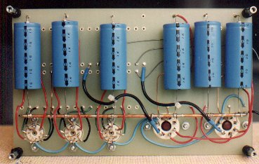

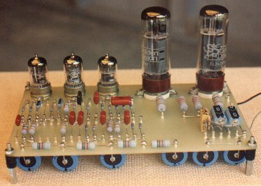

I did a bunch of my early amps with sockets on the board.
Starting somewhere around 1993
Here's a few really old pics
Plus several of my rack projects including a power amp
It's a good way to go and fun to build
« Reply #28 on: March 15, 2012, 07:05:19 am »
That's awesome Doug!  Wish I saw this before I built mine. :-)
Thanks!
