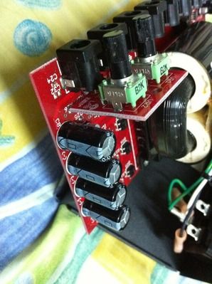

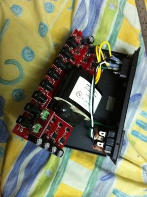

My friend feel very upset of New Ampeg SVT VR
« on: May 01, 2012, 09:02:30 am »

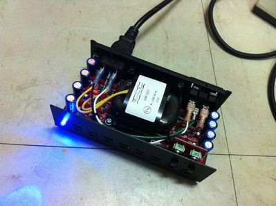

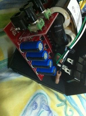

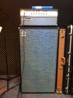

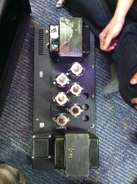

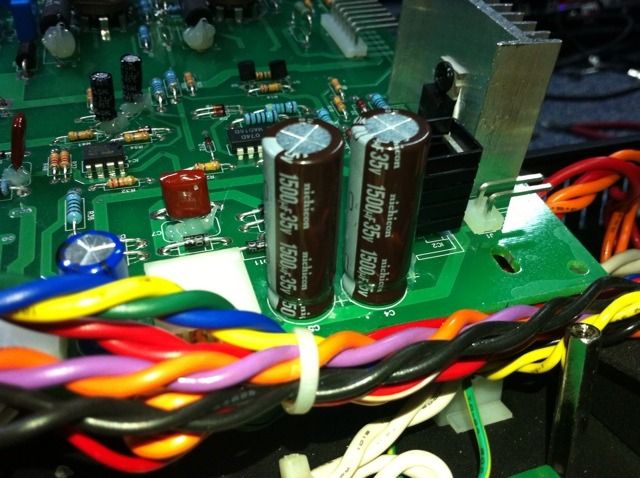

hi
my friend pay $3500USD to buy Ampeg SVT VR and SVT 810E. after take out the chassis and take a look, all the parts is bad. The transformer look like china made. Capacitor is brand of Nover.  it is not famous brand. and he opamp is TL072 and TL074. and the speaker is made in china Eminence speaker.
i will help my friend to upgrade his amp.

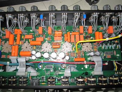

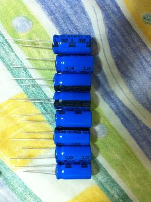

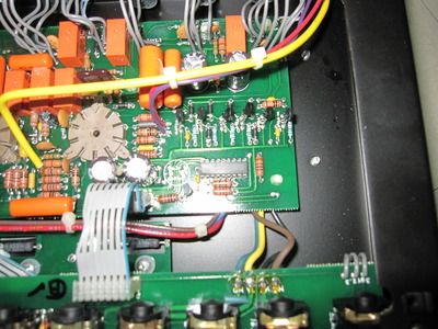

1. change all the capacitor to BC. the board have some small cap, i purchase BC and Nichicon already. but another 8 capacitor is 450v big size cap. it is 3 of 100uf 450v, 1 of 100uf 250v and 4 of 47uf 450v. but i can't find BC for replacement. because BC size more big. in fact, do anyone know can i use 400v cap? and can i use Sprague Atom cap. but it is not Radial. but i see vintage ampeg amp also use non Radial cap and mount to the chassis. and i use sprague atom for all fender amp, they sound always good. and i use Black Gate small cap for pedal, it sound great, but it is stop produce. now, i use BC small cap for pedal cap mod. it sound great and cheaper than Blackgate, also BC almost have all value and voltage and suitable size for pedal .
2. My friend want to change the tube too. all the preamp tube will change to RCA. but the 6 of 6550, i plan to suggest him to use New Tung Sol 6550. in fact, i use gold lion all the way. but Gold Lion no 6550, just KT88. is KT88 same with 6550?
3. the speaker, this is the last step he will do. because speaker is expensive. he plan to use weber new design bass speaker, it is 10FL or 10FH. have anyone have another suggestion?

Just curious, why did he pull the chassis? Did the amp arrive not working?

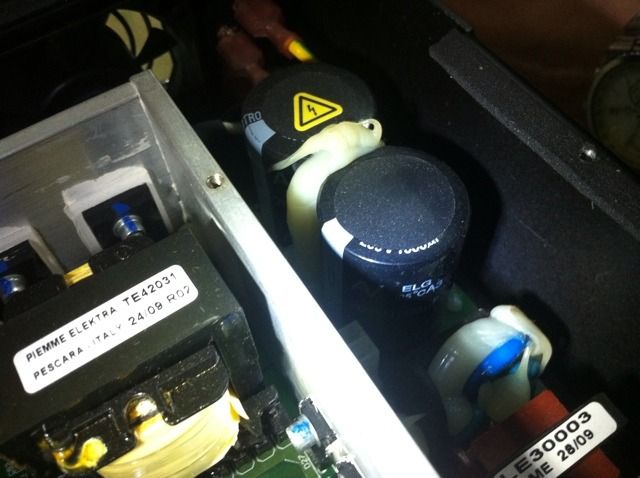

I think you're making a big mistake. I would not change those filter caps. There's probably nothing wrong with them.
Just because you've never heard of the brand does'nt mean they sound bad or are a problem. Modern eletrolytic caps are made differently than the old style e-caps and are smaller yet can be just as good or better sound/performance wise.
In fact if you cut open a Sprague Atom cap you'll see that what's inside is much smaller than the size of the can it's in.

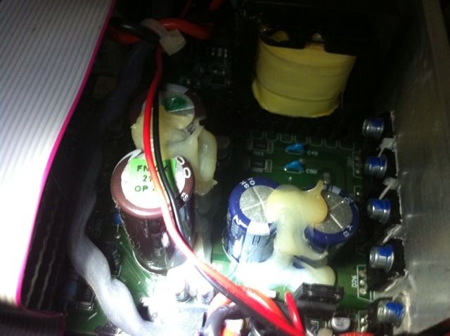

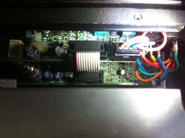

the amp is arrive without any problem. because my friend is curious about what parts inside of this amp after he pay $3500 to buy it.
but i can't find out any parts is good inside. and i believe good cap will sound better. because i try to mod my voodoo lab pedal power cap , i change all SunTan cap to BC (philips) cap. sound improve and better much too much. i am not kidding, because my friend own pedal power too, eveyone agree that my pedal power sound better than original.
and i don't think bigger cap mean sound better than smaller cap. but i know Brand of Black Gate, Nichincon , Elna , BC Philips and Sprague etc...... always sound better . and Black Gate, Nichincon , Elna , BC Philips also are modern eletrolytic caps.
anyways, my friend plan to mod his amp cap. do anyone have some good advice to him? in fact, i consider sprague and BC. but BC size more bigger, and sprague is non radial cap.

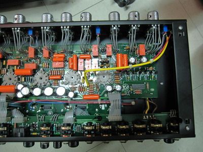

and i am interested to mod my pedal capacitor and Opamp. it always sound more better. i hope to share what i know to everyone. and i hope someone can give me suggstion.
i hope discuss with everyone about the opamp and capacitor.
recently, i mod my Eventide Delay , original cap is jamicon (made in Taiwan). and i mod it to BC cap and change opamp to AD .
« Last Edit: May 01, 2012, 12:40:10 pm by kwm488 »

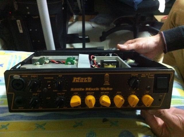

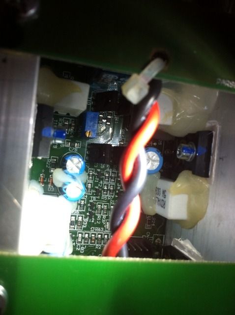

sorry to upload more. once more mod for TC Hall of fame reverb. it use lot of SMD caps and use programming clip, so i just change 4 On 33720 opamp to my favour AD 8620. and i change two filter cap from nichicon and Wincap to BC. i just do it today. i do compare before change it. it really sound better.
i learn from my to use solder to remove SMD opamp.

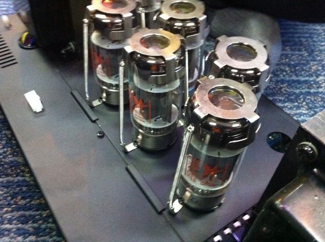

6550 replacement
One of my tube cross reference sources indicates that the KT88 will replace the 6550. But you might not want to replace a KT88 with a 6550, because KT88 is equiv. to 6550A,
source of info was wikipedia- list of vacuum tube

in fact, my friend plan to use 6550, not KT88. do you have good brand of 6550 recommend? he just know new tung sol 6550 is good

Winged (C) 6550A is what I use in an old SVT I have.  Very strong and punchy on low end.  Not sure who owns the Ampeg name of if they are still a separate company.  I know their lines of products have gone downhill since 1995 when they came out with their first piece of crap.  That 4, 12's cabinet they put their name on.  I am not sure, but Korg may own them.  You see Ampeg products where Korg is sold most of the time.

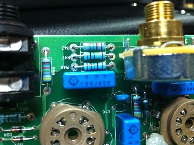

The electrolytics look like ChemiCon caps.  Nuthin wrong with that but I could be mistaken.  Start with the speaker.  that's the main problem I see.

All the filter caps are brand of Nover. Do anyone know this brand and where do it make?

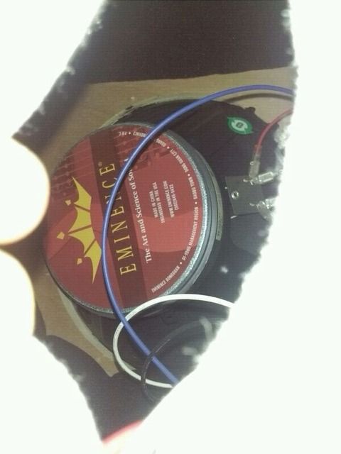

As my experience. Speaker is most important. But my friend will not start withe speaker first , it is too expensive. Weber bass 10FL is $90 each, $90 * 8 + shipping. Quit expensive.
And replace all caps may just $100 only.
If my friend want to change speaker. What speaker should he buy? And what ampeg use in golden 70s ? CTS speaker?

As the power tube. I always use SED before. But I use gold lion now, I think it sound better that SED. Honsetly, I think SED 6550 will sound better than Tung Sol 6550. And I love SED 6L6GC and EL34. But I use gold lion KT77 to replace SED EL34, sound better. Unfortunately , Gold Lion no 6L6GC.
Thank to suggest me SED. I forget SED have 6550

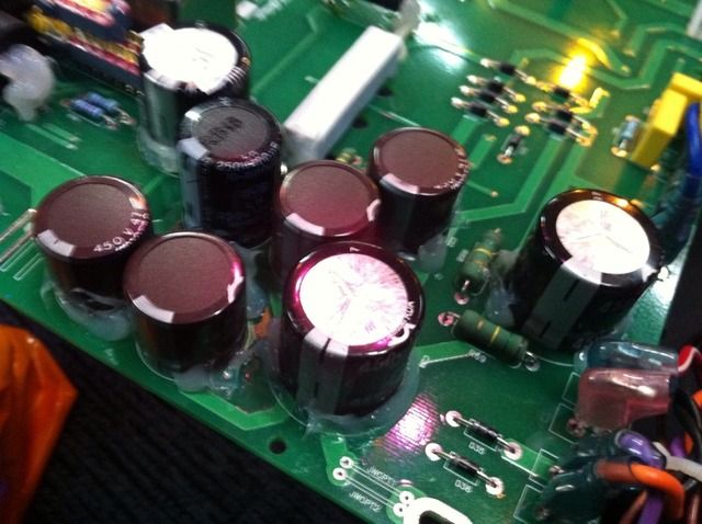

I don't know what country you and your friend live in or why your friend bought this amp, but I think your friend made a mistake paying $3500 for this amp and now thinks he can get a great sound by changing a few small priced parts.
Changing the filter caps in a low voltage SS stomp box, IMO is very different than in a HIGH Voltage/HIGH Current tube amp with the same resulates.
Plus, it's a pc board and at the $ price he paid for it and who knows if that board will even take the parts changes without the traces pealing off of the board, is anybody's guess.
So, if it goes bad while you're changing the parts, trying to help your friend, now what?     :dontknow:

But I can't beleive the cab cost $1100 and give me china made speaker. We go to ampeg web to see the spec very care before purchase . Ampeg never mention it is china made speaker.
Anyways, my friend will change the speaker finally. But he just pay $3500, so he want to change some cheaper parts first.
Can someone suggest him speaker?

I'm sorry kwm, our good Hong Kong friend.   :icon_biggrin:    I'm not trying to work aginst you.
If I spent $3500 on a brand new amp, I would not want to spend more $$ on speakers either.
But I still don't think that changing the filter caps will make that much or as much  differance as when you have changed filter caps in your stomp boxes/pedals.

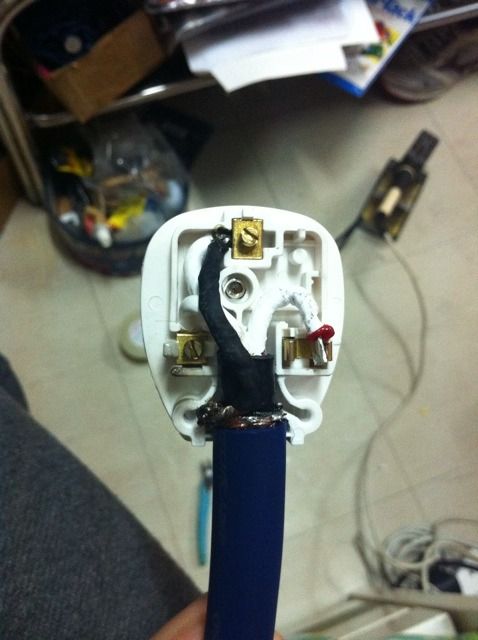

my friend use Furutech power cord already. sound much better. and power cord and tube can use for any amp. so i think it is worth to upgrade, if my friend want to sell his amp, he can keep the power cord and tube.
sluckey, do you mind to let me know what brand and model of power cord you use? i try monster , Belden 82830 and furutech only.
and i remove all plug fuse. remove fuse sound more better. all UK wall plug have fuse inside , but US wall plug style no fuse.

Er, why remove the fuse from the plug?  Apart from being an important safety device, the electricity has travelled a few miles over whatever power cables - does missing out 20mm of wire in the plug at the end of that help?  You really going to hear the difference, on a bass amp? !!
Never seen that done before!
Does the lid go back on with the fat mains cable?
he listened a bit too much to the audiophile community. they have more funny stuff to discover if you look around a bit. like porselain cable holders to make sure your speakercables don't touch the ground to have less interference coming from the earth...
that being said, it's all subjective ofcourse. if you like to spend extra money because you believe it's better, good for you.
and yes, the transformers in the new SVT are chinese and yes, the amps are very different from the old SVT's.

To JB
honestly, remove the fuse will sound quite better. this is a reason why some Hifi fuse price of $50 USD. before i try it, i think that fuse for crazy and stupid people. after trying it, i pay $150 to buy 3. but i just for audio, some people buy it for TV, they said video quality is better.
and the point is not missing out of 20mm cable. inside fuse, it is very very thin wire. Like even your computer CPU very fast, but your Hardisk is very slow, your computer performer is slow too. this is a reason why remove fuse will sound better. as the safety problem, i think the plug fuse is useless, because if your amp have problem, it should blow the amp fuse first, it should 1A or 2A only. the plug fuse is 13A. and all US plug no fuse inside the plug.
last, i compare common power cord and furutech cord for marshall amp and bass amp. sound hugh different. and compare power cord with fuse and without fuse. without fuse sound better.
I don't believe everyone, i just use my ear to hear which one is better.

for this SVT VR. it is 100% china made transformer? do anyone know what brand? and the old and vintage SVT circuit really different? do anyone where can i download svt vr schematic?
in fact, which bass amp is good parts inside. it is impossible to request the store open the chassis to take a look before buying it.
in my experience, mesa boogie is the only amp i pull out the chassis , but i can't do anything (mod). because they use all good parts.
this is my dual rec. it is Daly resistor, Orange Drop caps, Sprauge Atom, nichicon caps , USA transformer. i just change mesa boogie preamp tube to RCA and power tube to SED.
and what brand of bass amp is worth to buy? SWR??????????? i know SWR transformer is made by Mercury. is SWR amp use Good parts? how about aguilar bass amp? do anyone have their photo of the parts inside the chassis?

do anyone have SWR and markbass photo of chassis?
I am sorry as well.  It may turn out to be a great amp tho.  I gave up on their products long ago.  For me, I use a SWR redhead if I am playing bass and if I get the opportunity to play a larger place, then I will get someone to help me load that old Ampeg with the 8, 10's cab.
Ampeg is owned by Loud Technologies.
Wing C is the BEST 6550
you may find replacing the caps a waste of time
tl072 and 74's are the opams that belong in the SVT
Re: My friend feel very upset of New Ampeg SVT VR
« Reply #34 on: May 02, 2012, 12:37:35 pm »
If the power cord is crushed, it will short. The amp fuse will not blow, it isn't getting power. The power cord between the wall and the crushed part will burn.
That's why there is a fuse in the plug.... to protect you from damaged cords.
We do a lot of dumb things in the US. Mostly because the US electrified before good plastic insulation, and our electric code system is weak. Also we use many circuits with fairly low-current breakers, 15-20A. Similar to your 13A plug fuse. Lamp-cords will usually blow the breaker without starting a fire. Under post-WWII UK wiring systems, there may be 30A to 50A available at every wall socket (because there may be one circuit for an entire floor or house).
I'm not saying that you are sure to burn up the house if you bypass the plug fuse. You pay $2.50-$15 per foot for cable, you will be very careful not to crush it. It also look heavy-duty, hard to crush. This is very different from a table-lamp in a bedroom with the cord running under carpets, mats, old books.
Offline kwm488
  • Posts: 406
« Reply #35 on: May 02, 2012, 01:05:24 pm »
Hi
Thank you for your advice.
Before I do this, I do a lot of research. Almost all hifi guy in hong kong will bypass the fuse.
And if the cable is short. House electric protector will break even I don't bypass the fuse. Moreover, my power socket extension with 13A fuse. So it is enough. If the socket extension plug have fuse, socket extension have fuse, power cord have fuse. One fuse will lower 5% quality. The result is 15%. So I just keep socket extension fuse, but I install furutech fuse.

follow is mark bass photo, i think the parts is just fine. i think the most important is the transformer , if the amp transformer is good, i can mod the caps by myself. i email ampeg, he say he use oversea transformer.

anyways, my friend bought this SVT VR. as the recaps, this is just $100 USD. i think it is worth to do. of course , i don't charge the labor fee, he is my friend
i can't imagine the shipping to hong kong if he bought a vintage svt from ebay. and the problem is that he need to pay installments.
this is a reason why he bought from local music store.

« Reply #47 on: May 07, 2012, 08:09:09 pm »
thank
and do anyone know what brand of this cap?
also, i change the 2 nover caps to nichicon.

Offline kwm488
  • Posts: 406
« Reply #49 on: May 07, 2012, 08:34:33 pm »
I record sound clip before changing caps. But I can't listen any different. And I just receive ampeg schematic, that caps for DI.
Sluckey, do you know what brand of blue color cap?
