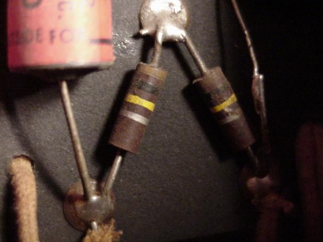

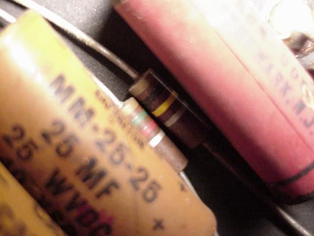

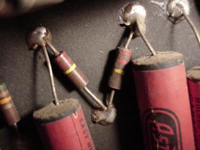

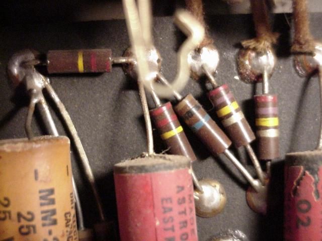

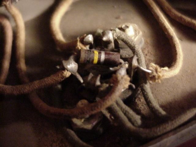

Back from Dr Extraction place. Going to take the best detailed pics i can get from my camera. I think the PI was of main concern but will get the preamp as well to see if it matches the schematic. Back in a bit/
Re: Fender 5D6A Find
« Reply #18 on: January 11, 2013, 01:28:48 pm »
Ok. Here is part verification as to what is in my 5D6A. Let me know if i missed something.
Pics from top to bottom seperated are:
PI V3
V2
V1
« Last Edit: July 25, 2013, 02:06:23 pm by plexi50 »
  • Posts: 5835
« Reply #19 on: January 11, 2013, 02:41:12 pm »
PI seems odd...
« Reply #20 on: January 11, 2013, 03:04:11 pm »
PI seems odd...
Both resistors are color banded 51K. No color fade on this end. One reads 54K & 55K
There in circuit so that sometimes makes readings off a hair. 51K is an odd number. Maybe they are or were 56K and mis printed.
Even so the resistor would drift up in value instead of lower in value i think

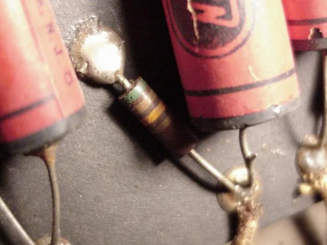

« Reply #22 on: January 11, 2013, 06:21:15 pm »
Pics of any and all part numbers. Chassis code matches tube chart numbers. The only numbers on the OT are shown. The PT has faint and hard to read codes. The logo has disintergrated from the top of the PT. I assume TRIAD? The choke has no numbers period. The tube sockets have etched script for the tubes used in the preamp,power and rectifier tubes on the chassis.
The preamp tube arraingement is in reverse on the etched script on the chassis from the tube chart.
Chassis etching = 12AX7-12AY7-12AY7. Tube chart = 12AY7-12AY7-12AX7
This had to have been done when it was being designed. I cant picture anyone even being able to see the etching unless you had the chassis out of the cab and on a bench
« Last Edit: July 25, 2013, 02:07:40 pm by plexi50 »
Not really, plexi, 51K is a normal value in 5% resistor land, just like 10K, 15K, 18K, 22K, 27K, 33K, 39K, 47K, 56K, etc are the normal values in 10% resistor-land.
  • Posts: 4429
« Reply #28 on: January 12, 2013, 03:15:30 am »
PI seems odd...
Maybe they both measured about 50k at the time of installation?
  • Posts: 13189
« Reply #29 on: January 13, 2013, 12:23:24 am »
The changed font for the "47k" in the schematic posted above suggests it was a later addition to the schematic.
That font looks familiar, probably from Dave Funk's Tube Amp Workbook (my copy is in another state).
50k was probably the typical value at the time, with 47kΩ being the later edited value when the schematic copy was printed (probably in a book).
Maybe they were out of 50kΩ (or 47kΩ if that was truly the correct value) that day, and used 51kΩ to get the amp built. Each of those has the gold 5% tolerance band, and I can't remember ever seeing a resistor in a vintage fender amp of tighter tolerance than 10%. So I think that value was unique to this amp (or others made that day/week), and swapped to get 'r done.

I was going through the layout on the posted website.  I noticed that a ground and a 220K resistor were not shown in the pictures.  On the 5D6a layout, this would appear between the 10 meg resistor, and a node branching to a cap and another 220K resistor found in the tone stack.
I am not sure how much the chassis was stripped, because I couldn't find in any of the pictures the 1 meg resistors shown at the jacks.  (Builder beware!!!)
Regarding the selenium diode.  Replace with a silicon diode.  Failure of the diode to heat, results in poisonous gases being produced.
That is the horizontal 220k in picture 5, reply #18 of this thread.
They are mounted directly on the jacks in Fender amps, and we don't have any closeup photo of the input jacks in the inside of the amp. I'll bet you $100 they are there.
Probably a good idea, but the selenium rectifier drops some voltage, at least more than a silicon diode. As a result, you may have to tinker the resistors in the bias circuit to land back on your desired bias voltage.
Also, the 5D6 seems to have pin 9 grounded to the chassis.
The few close-up shots of a tube socket in this thread show 2 filament wires, and pin 9 of preamp tubes not grounded. The overall shot also shows 2 wires for the pilot light.
However, the one-wire filament circuit was dead-nuts common in mid-50's Fenders. They generally grounded one filament pin of each tube to the chassis near the socket, grounded one of the pilot light terminals to its mounting bracket and grounded one side of the filament winding at the PT along with the high voltage center-tap.
But if this amp does have a filament center-tap as indicated in the schematic, then they would have used a two-wire filament circuit.

I have been looking at several 5D6 bassman pics and found a 47M  & 100K resistor coming off the 270K voltage dividers in the pic below. The 5D6A has a 10M & 220K combination. Cant verify the 5D6 feedback resistor yet. Im thinking it is 20K as is the 5D6A. It's in hiding just under the last PS cap pic. Still looking for differenced between the 5D6 & 5D6A
« Last Edit: August 01, 2013, 03:46:31 pm by plexi50 »
That's really a 4.7M. A 47M would be yellow/violet/blue.
Why? Didn't you say your amp is a 5D6A?
I misinterpeted the last band (green)
Yes my amp is the 5D6A. Maybe i should have started another thread on 5D6. Just curious what the differenced are between the cicuit boards
