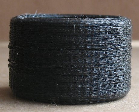

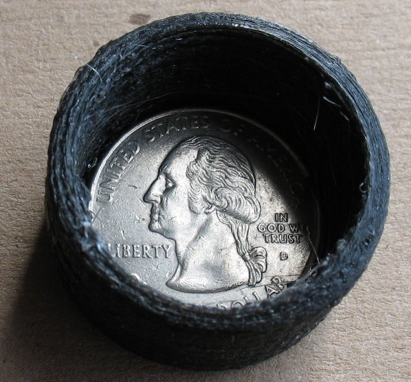

I built a plastic extruder and bolted it to my CNC machine as a test.
The test came out great and so I decided to go ahead and build a dedicated 3D printer
Here's a video of the extruder test creating a small cup object

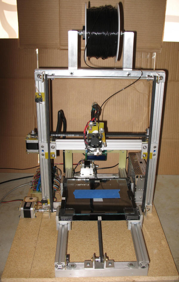

I installed the UHMW-PE bearing material in the bearing blocks and got the X and Z axis up and running
The X axis has a spring under the bed that keeps the belt tensioned
The Z axis has two shafts with two GT2 pulleys and belts
The bottom shaft is the drive shaft and the top shaft just free wheels
I can slide the top shaft up or down to put tension on the belts
Here's a video of both axis running some G code

The DIY printer technology is not able to do anything like a smooth faceplate
This little plastic cup 30mm in diameter took 1.5 hours and has a weaved texture
That guitar probably took 30 hours, just guessing, and that guy is using a much better technology that a DIY home printer

I just ran the little black cup code on the new printer
The same cup shown at the top of this thread
The printer does not have an extruder on it yet but I wanted to see how fast it could complete that same little black cup that I made on my CNC machine
The CNC machine took over 1.5 hours to complete the cup
The new printer finished the cup code in 32 minutes
That's a huge speed increase because I built the 3D printer moving parts very light
I think I can crank up the motors even faster and maybe get the print time on the cup down to 25 minutes

I spent a couple days getting everything square, bolting down the electronics and got the A axis extruder almost done.
Here's a video of the 3D printer running the same cup code I did on my CNC machine extruder test.
The 3D printer is finishing the same code in 25 minutes that my CNC machine did in 1 hour 40 minutes
It hard to see just how fast the X and Y axis are in this video but if you lay your hand on the X axis bed, it feels like an intense vibration as it rips the code off in Mach3
I should have the extruder finished in the next couple days and be ready to print the cup code to compare it to what my CNC machine printed

I finally had some time today to take a bunch of detailed pictures of the 3D printer
I have added several things to the printer since I last posted here
This page on my web site has lots of pics and info
http://www.el34world.com/Misc/Cnc/CNC21.htm

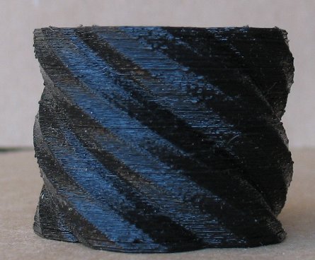

I printed this cool twisted shape the other day and it came out great.

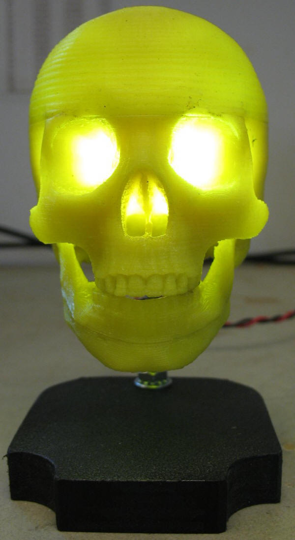

I changed out the nozzle on my printer
The brass acorn nut was dragging material around and there was not enough brass on the end to be able to machine it down to a finer point
I purchased a makerbot style .4 mm nozzle and the prints are much cleaner now
I printed this skull in 4 parts and glued them together
I added some LED's behind the eye sockets just for fun
The lid comes off just above the eyebrows for access to the electronics
I added a few pics of some of the prints here
