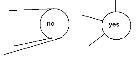

I'll second the motion on getting shorter lengths of bare wire...either on your 68K's hanging off the input jacks or the various wires connecting to the tube sockets. The rule of thumb is, the insulation should be back from the terminal the outer diameter of the wire; however, in this case, and I'm not trying to set up the impossible challenge for you, I would be trying to get the insulation back from the terminal by about the diameter of the BLACK, internal insulation, not the white outer cloth insulation.
This may seem difficult, but frankly your solder joints look pretty good in the sense that they are "stingy", you don't have a big honking glob of solder on them. That must mean you are not overheating or overfeeding them. One could say that this will never be a problem, but at some point, it *can* be should you ever need to stick a probe in there to troubleshoot something. Besides, you'll never get better at it unless you have a visual ideal to shoot for.
You don't want the insulation to actually touch the terminal, you want that "golden" distance. In terms of older Fender amps, this was of course never a problem because they used that wire with the "pushback" insulation so if the bare wire was a little bit too much, the insul could be easily shoved closer to the terminal and nobody would ever know.
My advice would be to grab something with a bunch of terminals on it like an extra tube socket or a multi-pin connector and practice trying to get that distance down. You seem to have good control over your soldering, so this would not destroy the socket for later re-use. It's only a matter of knowing how  you want the finished product to look and practicing a couple dozen times.

Re: Newb first amp build
« Reply #15 on: May 13, 2014, 09:56:23 am »
"I'll work on shortening the ends today, thanks all. I also have an idea for grounding the pots that I've seen somewhere. Take a long grounded stripped wire run behind the pots and ground them to that. Good idea or bad? "
Yes, it's a good idea but rarely do-or-die. To do this, it's generally necessary to file off or sand off an area on the back of every pot to expose clean metal (it's steel--not copper--we don't ordinarily think of steel being very solder-friendly but it can be if it is freshly filed off and given a little more oomph than a normal solder joint) and to have a soldering iron of perhaps larger size/temp than normal. And get to it soon after you do your filing, whether the pots are already mounted or before they are installed into position. All you need is maybe a 3/8" x 3/8" patch of clean metal. DO NOT use any kind of acid flux if you have soldering trouble!! If you can't get it done with your current iron, forget about it or get a bigger iron/tip.
"I've read that it's best to have one ground to avoid ground loops but don't ground AC with DC is that right? if so I have no idea what's AC and what's DC in there.
It's a little more complicated than that, but not much. Fender amps only partially obeyed "best practices" in this area but they DID make power supply grounds and filament grounds---when the filaments were a CT---close to the power trans, all together on one bolt. But when Fenders used the dual-100 ohm synthetic center tap scheme, that was grounded to the pilot lamp frame. Do a little more reading on "ground loops" and "star grounding". This can get to be a whole religion, but in general, we want NOT to use 15 different points on the chassis for gnd points and intermingle power and signal grounds any old place where we might grab them and particularly in the case of a steel chassis, we don't want ground currents running all over the place.
The other thing I wanted to suggest about your wiring is, I like to try to get the wires to a tube socket to approach the pins perpendicular to the circumference of the socket. Not tangent. This is a style thing, I suppose, but is kind of in the category as the "less exposed wire" reco I made earlier. You can readily see, that if your wires come into the tube socket at the tight angle AND have lots of bare wire exposed at the tube-pin solder joint, this is asking for trouble. This makes your wiring lots easier to look at should you need to, later. It is no more work to do when it's being built...so it's good insurance. Another one of those visual things that you'll easily adapt to once you get the picture.

On you main filter cap board, you have a green-insulated jumper wire and a pair of 220kΩ resistors connected to the first two 20uF caps. Get rid of those, they're not present in the 6G6-B. I think I know what you were trying to do, but as-is the jumper is shorting high voltage to ground and the 220kΩ's are not in the right places for what you were looking to copy. The main filter board is not shown on the Fender layout (because it was outside the chassis under a metal cover), but the schematic shows these first two 20uF caps connected in parallel. So you will remove the green jumper and replace the 220kΩ resistors with wire.
On that main cap board, you probably also want to connect the - ends of the first two caps to the - ends of the other caps. Or, if you wanted to keep those grounds separate, make sure you install a wire for each set of grounds so you don't have a hard troubleshooting problem by having a missing ground.
Is this layout minus the 220K resistors on the first two caps correct?

The original used two 20µF/600V caps in parallel. The only 20µF/600V caps that I'm familiar with today are Sprague Atoms. They're $22 each and are probably too big to fit under the doghouse.
I recommend that you use your original plexiglass board but replace the two caps on the left with 100µF/350V caps. Much cheaper and Doug has them. See pic...

Steve is right.
Click this link and print it out.  It is what I believe an accurate layout of the filter cap board (very first pic).  You can see a pic of the mounted filter cap board on page 6 of the post.
Dub's build is super nice.
Match your resistors and layout to the printout and orient the wires accordingly.
http://www.mosriteforum.com/forum/viewtopic.php?f=30&t=5096

How's this
  • Posts: 5282
« Reply #39 on: May 17, 2014, 01:42:55 pm »
That's fine ***IF*** your unloaded B+ will be less than 500VDC.
