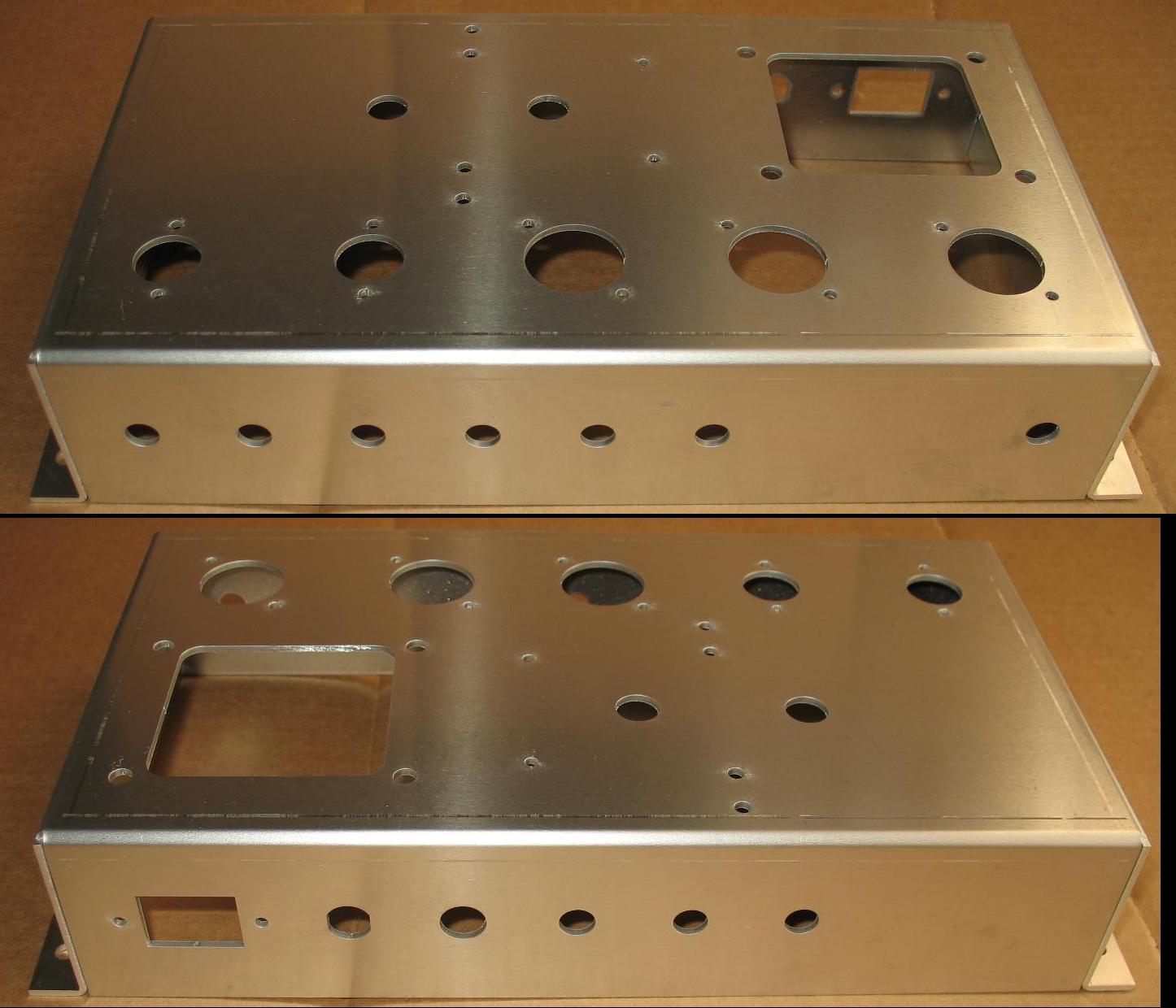

If you guys can think of any others, now is the time to do it
Re: The chassis are here
« Reply #202 on: February 03, 2015, 12:40:18 pm »
Looks more "universal" now but IMHO I don't quite get why smaller EL84 holes aren't utilized first? Would it not be easy to open the holes up for octals if one would want to got that route?
I always seem to have a need for at least one switch on the front panel for purposes of optional biasing, bypassing, cascading, etc...
The only thing missing now is the bottle opener on the back panel and a hook for a shoe horn for anyone that fills all those holes with pots & sockets?  :l2:
  • Posts: 10661
« Reply #203 on: February 03, 2015, 12:47:38 pm »
The average guy cannot make big holes in chassis
Not sure how you would even do it when there is already a big hole there to begin with
Hole saws rely on using a small pilot bit to keep them centered
A greenlee hole punch that large is expensive
It's much easier to block off the 8 pin holes with my adapters
They work great and don't cost much
And also, I am seeing that more people are building with 6V6's than EL84's

You just use a step bit but I understand where you're coming from. So in that light I think you should make one more adapter in case one would want to use EL90/6BQ5 or other 7-pin power tubes?
  • Posts: 10661
« Reply #205 on: February 03, 2015, 01:24:01 pm »
I don't make the adapters
I get them from mojo
Those 3 are the only adapters they make
Not sure if anyone out there makes such a thing?
Anywho, this helps people that do not have fabricating skills and there are allot more of those people than those that do have fabricating skills
« Last Edit: February 03, 2015, 01:27:30 pm by EL34 »

NEW stout chassis PT compatibility.
18WPT - Hoffman 18W PT - 580VCT @ 120mA 5V/6V@ 2A 6.3VCT @ 3A| 120/240V pri
758 - Hoffman/Mojo - 710VCT @ 300mA 50V bias 5V @ 3A 6.3V @ 3.75A | 120V pri

Pete, you do 99 now do 100  :icon_biggrin:
Why not a list of all circuit that can fit on the chassis and of Doug's board that can fit there ?

And to go along with your cabinet deal, I have the chassis on sale for $38 right now on this page
http://hoffmanamps.com/MyStore/catalog/Chassis.htm
That would be a chassis and a cabinet for under $100
