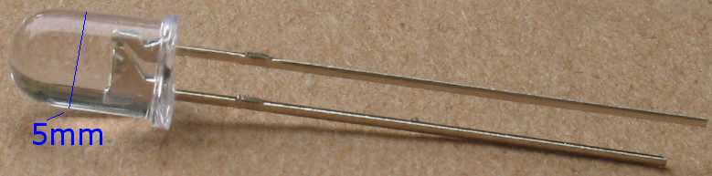

The lamp hole on these chassis was designed for the 120 vac neon lamp assembly on this page
http://hoffmanamps.com/MyStore/catalog/parts20.htm
I just found out that after I installed the 40x20x20x20 cap can in my chassis that there is not any room for that lamp
It is too long by about .25 inch
I did not think to check the depth on those neon lamps
I wanted to make the chassis hole small so it would accept the nice chrome LED I sell but Andy wanted it larger so they could use the Neon lamp
I don't have a lamp option at this time
I may cut one of the Neon lamps in half to make it short and then pop in one of the clear led's I sell
I'll be messing with that today

A dremel tool a dn a just a few minutes I converted the 120vac neon lamp to a LED
I cut it shorter right where the threads end
Pulled out the two metal connector tabs
Unsoldered the neon lamp and resistor and soldered my LED to the connector tabs :)
I used this LED
« Last Edit: November 29, 2014, 06:12:49 am by EL34 »

we may have another LED option. i measured .9in from inside to touching a 50/50 cap in my boilermaker project.
http://www.mouser.com/ds/2/109/608-3x31-1xx-183773.pdf
the actual part no. that i think will fit. 3 bux each and they have 300+ in stock. the part no. below has the red LED.
http://www.mouser.com/ProductDetail/Dialight/608-3231-110F/?qs=sGAEpiMZZMsUguuR3b6UZjrITrX0AWF0W4el%2fApZ89g%3d
it has a .315" dia. M8 threads so it'll be a bit loose in the .375in hole, but will fit depth wise and the outer ring is .430in. so an 8mm flat washer will keep it more or less centered and secure.
it's .55in so it'll clear the cap. you'll have to bend and shrink tube the leads.
they're 2V DC LEDs so you'll need 180ohm resistor to the filament string. i needed some 250R 25W resistors and other odds and ends, so i'll order a couple and report back.

Mine is hooked up and works great
I used 180 ohm resistor and the brightness is perfect
It's attached at V4 heater connections
I prefer running a low voltage LEd than 120vac neon lamp

I got some of these.  5 for $15.
They're a bit nipple'y
Makes me want to put 2 on one faceplate,, for some reason  :undecided:
