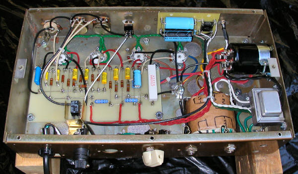

I am collaborating with Mojo to have a small chassis made that would be suitable for a 18 Watt type amp head
It is based on the Seeburg chassis I built my Hoffman Stout in, which is one of my favorite amps
But since I am designing the chassis from scratch, I can create it any way I want
But Mojo also is going to sell it so they have some input on what they want also
This is what I have so far
12 inches long x 6.5 inches deep x 2.5 inches high
.09" thick Aluminum - Standard Mojo aluminum chassis thicknesschassis
Mojo makes custom faceplates and so you can design your own
I will probably have Stout plates made and for sale
The front panel has 6 x .375" holes and an indicator lamp hole
You can fill the .375" holes with switchcraft jacks or pots
The top has 2 holes for 9 pin sockets and 3 x 8 pin socket holes
I plan on stocking adapters to make the 8 pin holes into 9 pin socket holes
OT and PT holes are for the Heybour 18 watt tranny set I stock
There is an extra set of OT holes for Deluxe sized OT's
The choke holes are for a small Fender sized choke
There's a couple rubber grommet holes on either side of the OT
The back holes are -
IEC receptacle,
Fender fuse Holder,
On/Off switch,
Rotary impedance selector switch
2 speaker jack holes
There is an image below that shows how the Hoffman Stout Board fits inside the chassis
I added a couple cap bracket mount holes to the right end so you can mount a 40x20x20x20uf filter cap on the inside wall
The cap will not fit above the PT and so it sits below the rectifier socket with lots of air space

How flexible is the cap can location?  It looks like it is directly under the octal rectifier tube.  I know it needs to clear the bottom of the PT as well.  its not super critical, but if you have room to move it toward the front, it might open up access to the octal.
I think cutting holes for octals instead of novals for the power tubes is a great idea.  It seems that a single square sheet metal adapter to provide for the noval is something mojo could sell for any of their chassis equipped with the same octal cutout.
Once the power tubes can be octals, the chassis is prime for a dual purpose of a 5E3 amp as well (or many others).  Maybe a well placed 3rd bolt hole would provide other OT options (if the 5E3 OT has a different bolt span there...).
These are small nuances...  everything looks fantastic!
  • Posts: 10407
Re: New Chassis plans
« Reply #6 on: September 02, 2014, 06:37:06 am »
It won't fit above the power tranny
Not really a problem where it is. You wire that socket one time and you are done with it
There is a pretty good air gap between the two
And the heat rises so the socket is on top of it
My stout in the picture below has the same location. It was built in 2005 as is ticking away without any problems

Here's the insides of my Stout. The cap is under the rectifier
« Last Edit: September 02, 2014, 06:41:36 am by EL34 »

The stout board board size and other is listed on this page
http://hoffmanamps.com/MyStore/catalog/TurretBoard.htm
There are no mounting holes, you put them where you want them
One in each corner should be fine for the Stout board
