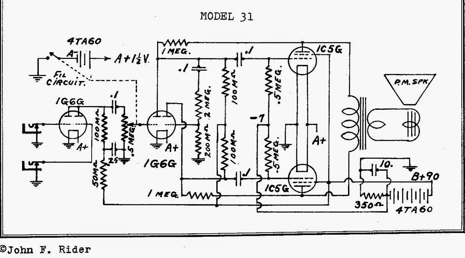

Battery power tube guitar amp from National Dobro.
National Dobro Model 31
Note: in this plan, "M" resistors are what we call "K" today. "Meg" is Meg.
OT CT not shown, a typo. OT is probably 20K CT.
Power output from two 1C5 tubes about 0.4 Watts:
1C5 datasheet
1G6 data
Taking volt-amp stage gain as about 20, input sensitivity is about 7V/(20*20)= 20mV, in-line with classic large Fenders.
Should run many hours on a ten-pack of 9V batteries and a D cell or two.

Is the "-7" -7V bias voltage? If so how are they getting that, I don't understand. Is there another battery just for bias? Would that be the C+?
10 9Vs and 2 Ds...wow!
350 Ohm resistor in the negative battery lead.

« Reply #4 on: November 13, 2014, 12:31:40 am »
Oh, ok.
I took the schematic to mean the 90V battery was sitting on top the 350R resistor. I get it now.

« Reply #5 on: November 13, 2014, 12:54:03 am »
Revitavly speaking, measuring from the battery's - this looks like a cathode biased amp but with all the "grounds" tied to the top of the cathode resistor. Am I understanding that correctly?

« Reply #8 on: November 13, 2014, 05:46:21 am »
Wow, that threw me for a loop. Are you saying it's a 97V battery? (-) terminal at -7V, (+) terminal at 90V and 0V is a virtual point within the battery? Whew!
So is this a fixed bias or a cathode biased amp?
 Looks cathode biased to me but instead of saying the grids(which are tied to the battery's -) are at 0V and the cathdoe is at +7V, the measurements are taken from the cathode so the cathode reads 0V and the grids read -7V.
I guess with a battery, ground is where you assign it.
 A 9V battery could be 0V on the - and 9V on the +,
 or 4.5V on the + and -4.5V on the -.
 Or 0V on the + and -9V on the - (like a fuzz face).
Just blew my mind for a sec.

« Reply #9 on: November 13, 2014, 05:32:56 pm »
This is a back-biased amp. Or you could call it fixed bias, but developed in a back-bias manner.
The battery is 90v. The output tube cathodes (which are directly heated, so they are the filaments too) have one side connected to ground. So do all the other tubes. A resistor is placed between ground and the battery - terminal. That means all current for the amp is drawn through that 350Ω resistor, and creates a 7v drop across the resistor.
However, the location of the circuit ground and the direction of current through the 350Ω resistor make it appear as 7v "below ground" or -7v on your meter when the black lead is touching ground. So the 90v battery - terminal also looks like it's at -7v, and so the + terminal will measure 83v when your meter's black lead is on a ground point.
After all, "ground" is only a reference point you choose to call "0v."
The -7v developed across the 350Ω resistor is applied to the output tube grids to bias them. But there's not a true fixed bias supply, just the back-bias resistor. Looks like the entire amp's B+ supply only draws 20mA from the B battery.

Re: Battery amp from National Dobro
« Reply #11 on: November 13, 2014, 06:36:37 pm »
It's current-dependent, just like a cathode resistor. So it's not "fixed" in the way a power supply with its own rectifier and filter are "fixed."
I did say "call it fixed bias, but developed in a back-bias manner."
« Reply #12 on: November 13, 2014, 09:19:08 pm »
It is self-bias.
Traditional "back-bias" runs the audio AND the radio tubes together through a resistor. The sum of the radio stages may be similar to the audio stage current. In that case a change in audio stage current does not cause a large change of bias.
But here we have like 19mA in the power tubes and 1mA in all the rest. It is 95% self-bias.

Don't get me started on Edison. :cussing:
This thread did get me wondering, what are the 1Meg resistors between the inverter plates and the power tube plates?

« Reply #27 on: November 18, 2014, 12:58:26 pm »
That's a local NFB loop. Thinking of it as a resistor from power tube plate to power tube grid may make it seem more logical.

« Reply #30 on: November 24, 2014, 04:12:58 pm »
Did a little followup on this amp.   Radio Museum has the model 31 at 0.8w
Gotta be smarter than your sources; it's not "rocket surgery" or "brain science".
1st Post:
1C5 datasheet
1C5GT data sheet gives Class A output for 1 tube as 200mW, with a 90v total supply, 7v of bias, 83v plate-to-filament (exactly what the schematic shows).
2x tubes in push-pull Class A can be counted on to deliver 2x the individual-tube output, when loading and supply voltages are similar; 1-tube condition specified 9kΩ load impedance, hence PRR's suggestion the OT probably presents a (9kΩx2=) ~20kΩ plate-to-plate load. Maybe even a bit more output when you account for the reduction of even harmonic distortion in push-pull.
So it's a 400mW amp; could conceivably make 800mW square waves, but for half the time as clean-sine (battery-drain imposes the limit).
