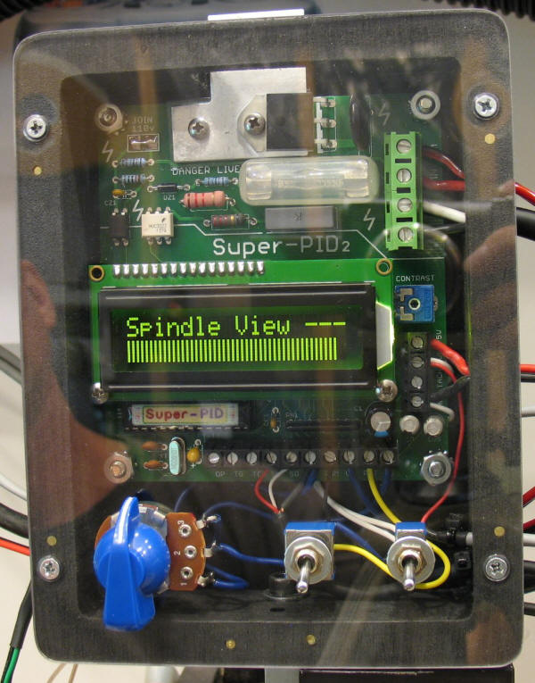

  • Posts: 10675
Re: My Plexi 6V6 build
« Reply #70 on: February 25, 2015, 05:38:05 am »
i'm assuming your cut job was an inside contour: do you recall what the feed rate on your X & Y axis? how many passes and what cut depth did you use? it'd be nice to have a staring point since i've never cut wood on my CNC, just aluminum and Garolite...    :icon_biggrin:
thanks, --pete
see my screen short for all the settings I used
Inside contour?
In CamBam the MOP is called profiling which is probably the same thing?
The tool is following a shape.
In this case I have it set for profiling the inside of all the shapes
I used real slow speeds because I did not want to splinter the wood.
3 for plunge and 10 for cutting, shown in screen shot
Two rough cut passes
-0.23 inches down, then -0.47 inches down
Cutting  -0.002 back from the lines as a roughing clearance
One final pass at -0.47 with the roughing clearance pass set to zero so it does one final clean pass following the lines
I set the tool width to 0.245 inches wide to fool CamBam because my parallel lines were exactly 0.25 inches apart
It has a problem doing that if the tool bit is set to 0.25 inches wide

  • Posts: 10675
« Reply #72 on: February 25, 2015, 12:03:01 pm »
I run a Bosch router motor but I use a super PID motor control
You mount a sensor that reads the rpm of the motor shaft
The motor speed stays constant, even under heavy loads
See the wire coming out of the end of the Router motor?
Big pic here
http://el34world.com/Misc/Cnc/CNC19.htm
It's so much nicer with an electronic control unit
