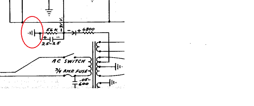

Hello all, I just put together a 5e11 using the schematic and layout provided here .  I fired it up for the first time and all I'm getting is a lot of rhythmic pops through the speaker.  I have double and triple checked all my connections and am at loss as to what the problem could be.  I must admit I don't know anything about oscillator circuits and although it's not notated on the schematic I am wondering if the tremelo Jack  should have a ground reference.  Any help on this subject would be greatly appreciated.  Thanks.

Are you saying you get ZERO audio through the amp? Just your pops? Are the pops affected by the setting of the "speed" & "depth" controls?
We'll need some voltage readings to help you better. You have the ground end of the bias rectifier connected? If that doesn't mean anything to you, what voltage do you measure on either 6V6 pin 5?
I don't know what that means either???

Just took some readings and I have 370v on 6v6 plates and 140v on pin 5 with depth control all the way down, and at max it's at 154v.  Also notice the pops get faster as the depth control pot is turned.

POSITIVE 140-154 volts? Your 6V6 tubes would be cherry red hot and probably cooked good. Bias diode installed backwards.
If the ground side of the 56K & the 25/25 u was disconnected from ground, bias would be way way negative and the 6V6 tubes would probably  be cut off.

I have the diode cathode (side with grey band) pointed toward the 6.8k resistor.  Is that backwards?  The 56k ous grounded.

That's backwards! That will produce a positive voltage where the schematic shows -31 volts. It quite possibly will have blown up the 25/25 cap, which is no big deal, cheap part. It will be interesting to see if your 6V6's survived. By all rights, with +140-150 volts on the control grids, Pin 5's, they should resemble Chernobyl.

Sluckey is right, I was wrong. [costanza] I misread you, I apologize. Diode band towards the 6.8K
You cannot allow +big volts to live on your 6V6 pin 5s. The voltage there has to be negative relative to the cathodes of those tubes. Otherwise those tubes will burn up, and fast. You can troubleshoot the amp as it is, but I would pull out your 6V6 tubes. *If* you had +140 volts on the 25/25 uf cap in the rectifier circuit, reverse polarity, that cap is probably fried.
I see no rational way you could end up with +140 on your bias feed, unless the .25 u/400 v cap connected to the first 12AX7 plate, the trem oscillator, is very very leaky, or shorted. Even w/the bias diode reversed (and it is not) your + volts should not be that high.

Re: vibrolux issues
« Reply #41 on: July 03, 2015, 09:04:32 pm »
That same error is in the Aspen Pittman series of schematics.
Dave Funk's book, 5E11, both the layout and the schemo match each other and are the same as the good 5E11 pair you posted the link to in Doug's library. But the 5F11 pair are messed up, 1 shows .02 the other shows .03 caps and V1b 220K plate looks like it was changed with white out and both are rewritten as 100K.
« Last Edit: July 03, 2015, 09:07:36 pm by Willabe »
Re: vibrolux issues
« Reply #42 on: July 03, 2015, 09:15:20 pm »
Sluckey's right, it has to be wired wrong.
Here's the best way I know how to double check a newly wired amp;
http://el34world.com/Forum/index.php?topic=17701.0
So depth pot acts as a MV, tone pot acts like a speed control, what does the speed pot do?
