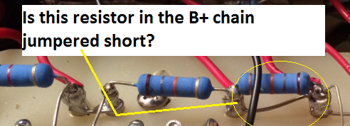

Your pic looks fine. We need more. We need to be able to clearly see the tube sockets, the board components, and wiring between the board and the sockets.
Your plate voltages for V3 and V4 are very wrong. Did your meter die on you or get switched to "AC" for those readings? Recheck.
Why do you have a jumper under that 18K/3W resistor? Talking about the one on the right in your pic.
For now set your bias pot so you have maximum negative voltage at pin 5 of both 6V6s. Leave it like that until you get the V3 and V4 voltage issues fixed. Make sure the 6V6s are not red plating.

Thank you for spotting that extra jumper wire.  I will think to trace starting at the very beginning in the next build.
I biased the tubes to 25 ma and tested voltages again.
V1   P1 118, P3 1.6, P6 116, P8 1.6
V2   P1 371, P3 3.2, P6 370, P8 3.2
V3   P1 137, P3 1.2, P6 136, P8 1.2
V4   P1 1965-212(fluctuating), P3 1.9, P6 213, P7 15(?), P8 156
I happened to tap pin 7 as I went down and it came through the speaker as well as the OT connections at the power tubes.

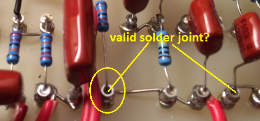

Re: Help on Hoffman Princeton Reverb Turret Board
« Reply #10 on: October 26, 2015, 10:48:23 pm »
Am I seeing this right?

There should be an under board jumper as shown. Measure resistance between the two circled turrets. Should be zero ohms. If not, just put the jumper on top of the board.

Sluckey, I did remove that jumper under the 18/3w resistor and that may have corrected those readings?  I think this is the same one you are referring to eleventeen.
Also, I touched up those to solder joints eleventeen.  Question on that? Even though it runs down into the turret should I fill it further until it bubbles at the top?

I tested for that under board jumper and it reads 0 ohms.  Also, I can see the reflection in the chassis underneath as well so I was able to visually double check.

« Reply #38 on: February 15, 2016, 01:45:23 pm »
Greetings,
I have rewired my inputs but am still getting no sound except for a very light hum which makes me believe the speaker is receiving some signal from the amp.
Previously, with your help the ground issue was fixed and the old Weber input wiring was working one input.  I rewired as you posted but now have now sound coming through. I also tried using new input jacks in case the old ones were not good.  I've tested the ground connection from the input jack all the way to th te PT lug and it shows a connection.
Here is a picture of my input and V1.  Any thoughts or things I should try would be much appreciated.

  • Posts: 5398
« Reply #40 on: February 15, 2016, 02:59:36 pm »
Check resistance from V1 pin 2 to ground as follows...
Set meter to measure resistance. Connect one probe to ground. Connect the other probe to V1 pin 2.
1. With nothing plugged into either jack, the resistance should be 34K.
2. Insert a blank phone plug into the LO jack. Resistance should be 68K.
3. Move plug to HI jack. Resistance should be 1.034M.
4. Insert a second plug into the LO jack. Resistance should be 1.068M
« Reply #41 on: February 15, 2016, 04:39:19 pm »
In your V1 pix, 2 posts above this one....I see a black heater feed wire going to pin 9 and I see a brown one going to pin 4.....and while I see there is solder filling up the hole in the lug  on pin 5...I don't see a connection, a jumper if you will, between pin 4 and pin 5. It's perfectly possible that I am not seeing the jumper as it could be hiding under brown heater-feed wire. It just does not look like it's there. It's absolutely possible that if you are a newb, you may have wired the heater only to one lug. Or you wired it to 5, thought you made an error, then moved it to pin 4. Has to go to BOTH pins 4 & 5. Or there has to be a jumper between pins 4 & 5, however you wish to state it in words. Pins 4 & 5 are shorted together AND fed that brown wire.
If that jumper is not there, that tube will LOOK LIKE it is lit up, just quickly looking at the powered-up tube, but only half of the dual-triode will be lit up (you'll only see ONE dot of light atop the innards of the tube when looking at the tube powered up) but the unlit half will be dead as a doornail. I mean, DEAD, shut off, not working. As if it was pulled out of the amp.
My bet is that this is the problem. Turn the amp on and look at that V1 tube. No meters. Do you see two dots of light or just one? Compare to the other dudes.
So these 12A_7 triodes are two identical triodes or are supposed to be. Therefore, it does not matter if the very first triode your guitar signal hits is 1-2-3 or 6-7-8. The Hoffman board *probably* follows Fender but may not, I have not checked. It would not matter. But it *COULD* be that XYZ amp co and Hoffman designate the tube-halves differently.
All that is meaningless, you need not care. But you MUST care that 4 and 5 are to be jumpered together for the tube to be fully lit up if you are powering the heaters w/6.3 VAC, which you clearly are. If that tube has a dead (unlit) half, you better believe it could 100% kill your guitar signal.

« Reply #42 on: February 15, 2016, 05:04:32 pm »
I agree with eleventeen, pin#4 looks to be soldered, but pin #5 looks NOT to be soldered or attached to pin #4, as eleventeen said, right there is where the signal will stop, within the tube--this side of the tube is not operating and there will no output to the coupling cap to pass signal to the output section.
"Lets have a look at the schematic a moment"....

« Reply #43 on: February 15, 2016, 08:34:12 pm »
First, thanks guys for all the help...
To answer your questions first I will give the readings I got and the setting I had it on.
Reading V1-P2 and Ground
No plug reading on 200k setting read 00.3
Plug in #2 input 200k setting read 00.2
Plug in #1 input 200k setting got 3.0, then 1.8, switched to 2M setting and got .005
To answer your other questions guys 4 and 5 are soldered together its just a very small wire with no shielding and its not showing at that angle of the pic, if you want more pics I'm happy to provide.  There are more above earlier in the thread as well.
Also I tapped the plug while it was plugged in and the tapping came through the speaker very slightly.. plugged in guitar no sound, did it with reverb tank connected and not.
Question for you: If some solder had leaked down on V1 P2 into the area of the pin what effect would that have?
