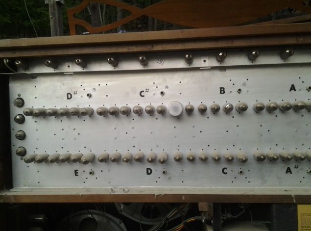

Free Lowrey organ. There are about 10 12AX7A across the the top, all seemed to be RCA so far. The two broad rows of tubes are types I have never even heard of, 6KM8, 6FH8. Four plate tetrodes. Sure. And 6X8's, I've heard of those. The power amp is 2-3x 12AX7 and four Syl 7591s. Not a bad tube haul.
Sometimes I go hot and cold on junk. lately, hot.
« Last Edit: February 22, 2016, 10:21:50 am by eleventeen »

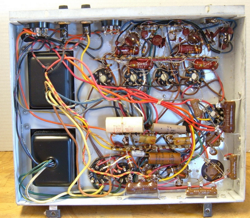

Well, I got the Voycall gradually fired up to full (345 B+) blast. It's certainly able to swing a big signal at highish volume, but's getting a massive bass feedback oscillation if the gain is turned too far up. As an amplifier, it largely works, certainly doesn't smoke.
The organ has 4 7591 Westinghouse, the coveted ones. Plus 20 or so RCA 12AX7A *and* a 12AZ7 for a new toob to play with.
Re: favorite old gear to buy for parts
« Reply #255 on: February 22, 2016, 03:14:23 pm »
it sure doesn't right now, LOL. Note that the smaller transformer is a honkin filament tranny, to run all the oscillator tubes. The lower amp is pretty much a stereo amp all set to go with 12AX7 driving 7591 & dual OTs about the size of a 5E3 Deluxe. I've done lots worse.
I am almost thinking to sell the tubes (they go for 70+ a pair) and downconvert the amp to 6V6's which would luxuriate in those OTs. Make a nice creamy little home stereo. Or leave the fil tranny and use 12V6 which can be bought cheaply.
Here is a gut shot, by the way, not of mine, but a super clean identical. See how the tranny on the lower left only has black & green wires and feeds (only) the big interchassis plug? Filament tranny for the upper deck. Not unuseful. Not part of the amp.

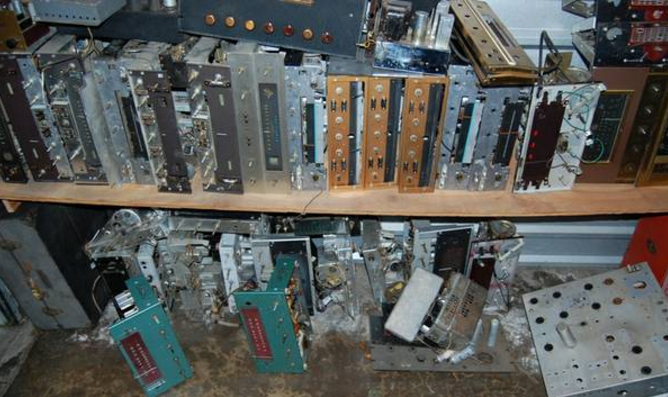

Well I came upon the mother of all tube junkpiles. Probably 35-40 Fisher, Pilot, Bogen, and Radio Craftsmen tuners and amplifiers for $125. And about 2 dozen Nixie tubes (in their sockets!!!!) which fetch ebay money. People make clocks out of them. I have to say, the project value is kind of appealing but when you can buy a used LED alarm clock for $1 at a thrift store, I can't justify the effort.
I figure I will throw out 90% of it, but parts, parts, parts, and there are a ton of transformers. Not many tubes, most gone. Oh yeah, and a perfectly functional DVM (noname but appears to work fine) and lots of screwdrivers and allen wrenches and little tools.
« Last Edit: March 13, 2016, 05:45:36 pm by eleventeen »

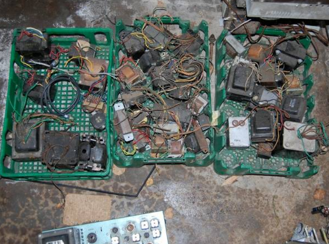

Certainly a pile for the ages. I carefully waited until a rare CA day when it was pouring down rain to grab it, LOL.
One thing about this pile, there are pieces here that are worth zero and I mean zero. And those items, you find your ruthless mojo. Though again, lots of times the chassis is the most useful part. There are also fair numbers of tuners (no power amp) and those might appear to have a juicy power transformer but in general they do not go high like we want for a power amp. Sometimes < 300 VDC, maybe a SS rectifier will help. So they are impressive looking trannies that do little good. I *did* get some NOS 6.3 filament transformers, always useful, and some of a particular type of tranny I have been looking for, which are 125 volts + 6.3 say 2 amps, for small projects.
I was a bit disappointed in the seeming lack of output trannies. I would have loved to get 3-4 pairs of 7591/7868 Fisher output trannies. I would have been ecstatic had I gotten something like that. They *could* be in there among the boxes of pulled-out trannies but I will have to look closer.
I am going to try to whittle this pile down and sell some Fisher glass and nameplates and misc on ebay. There are 4 Fisher 800's in this pile, but no way am I going to try to rehab them, they are really gone.

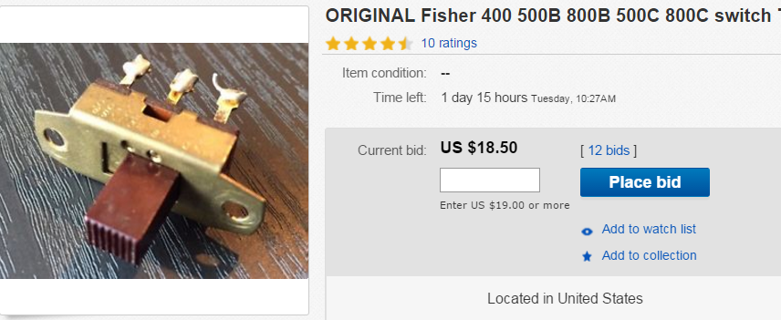

Prolly got well over a dozen of these switches. Tell me $18 for a switch isn't stupid?
