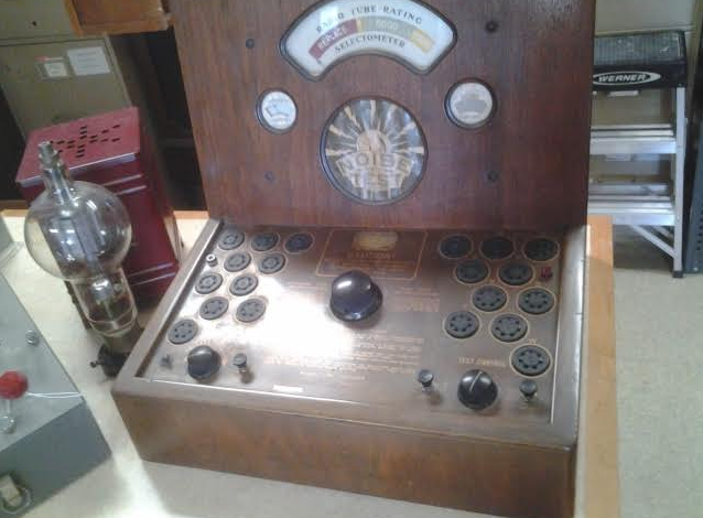

Bonanza day at the CA Historical Radio Society Junkfest!
Heathkit VTVM - $5 clean
RCA BIG meter Sr Voltohmyst - FREE
Heathkit audio osc missing PT - FREE
Heathkit Harmonic Distortion meter - $5. Has a Mullard 12AX7
Tektronix dual-beam power supply for 555 scope. Has 2-3 12AX7 FREE
stereo 6BQ5 amp, no tubes $5.
$10 - 5V4 + 8 qty 12AT7 + 12AY7 all JAN ($3 for the danged 12AY7, the others were 50 cents)
Pile of transformers, mostly small power FREE
They have a great collection of old "drug store"tube testers.
Your choice when using the zombie carcass of an old meter is either to get 2-3 OC3's (prefer OA3 75 volt) ---the neon colored ones lit up and showing in the big hole, OR, to get the meter to indicate as you play through the amp. Nothing else is acceptable!
